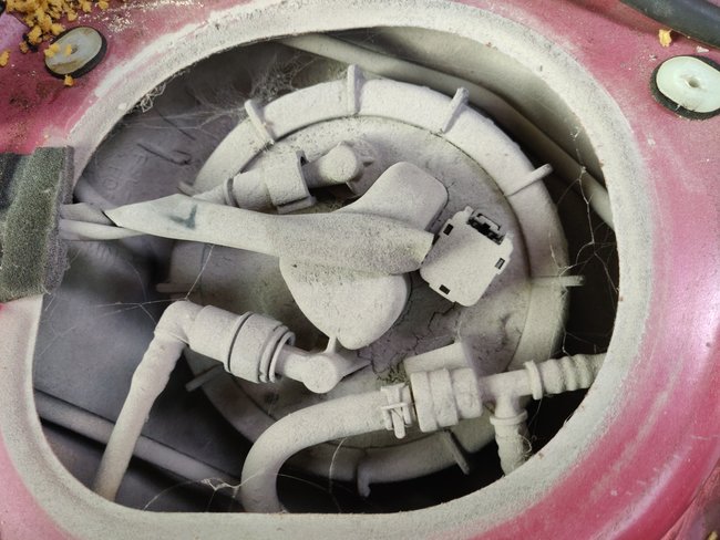

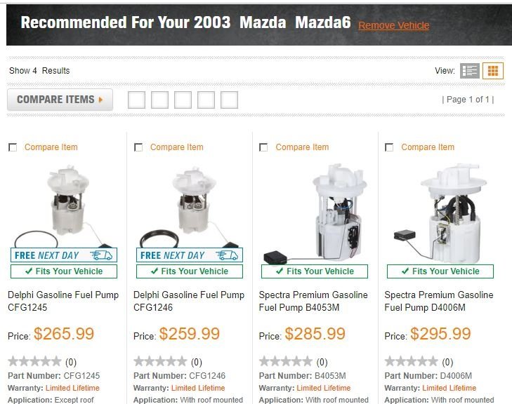

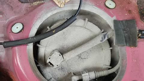

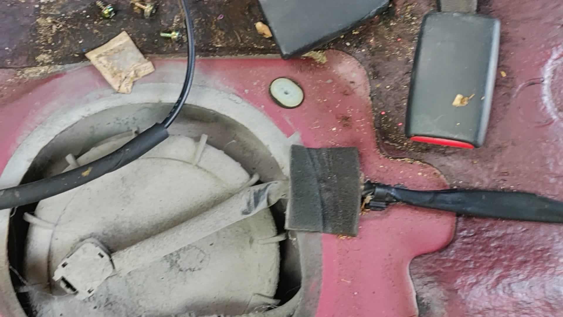

There is only one. The other is a cut off assembly.

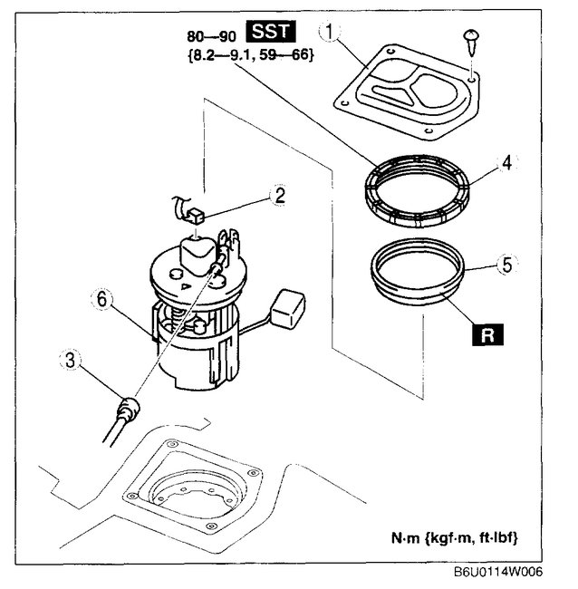

Here are the directions for replacing the pump. The attached pics correlate with the directions.
______________
2003 Mazda 6 L4-2.3L
Removal and Installation
Vehicle Powertrain Management Fuel Delivery and Air Induction Fuel Pump Service and Repair Procedures Fuel Pump Unit Removal and Installation
REMOVAL AND INSTALLATION

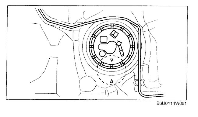

FUEL PUMP UNIT REMOVAL/INSTALLATION
WARNING: Fuel line spills and leakage are dangerous. Fuel can ignite and cause serious injuries or death and damage. Fuel can also irritate skin and eyes. To prevent this, do not damage the sealing surface of the fuel pump unit when removing or installing.
CAUTION: Disconnecting/connecting the quick release connector without cleaning it may possibly cause damage to the fuel pipe and quick release connector. Always clean the quick release connector joint area before disconnecting/connecting using a cloth or soft brush, and make sure that it is free of foreign material.
1. Complete the "BEFORE REPAIR PROCEDURE". (See BEFORE REPAIR PROCEDURE.)
2. Disconnect the negative battery cable.
3. Remove the rear seat cushion.
pic 1
pic 2

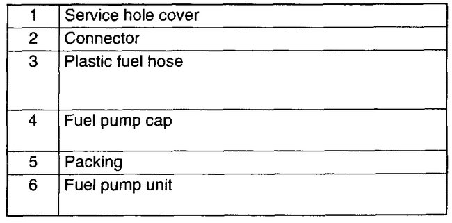

4. Remove in the order indicated in the table.
5. Install in the reverse order of removal.
6. Complete the "AFTER REPAIR PROCEDURE". (See AFTER REPAIR PROCEDURE.)

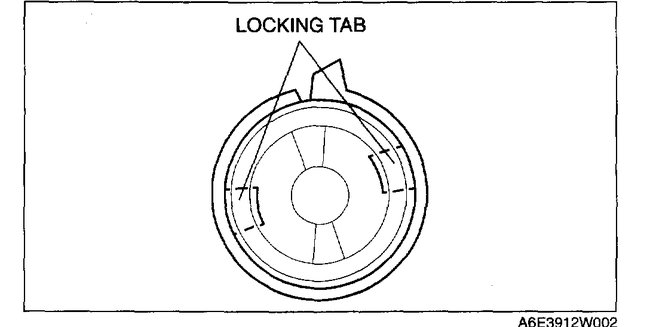

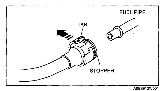

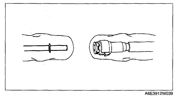

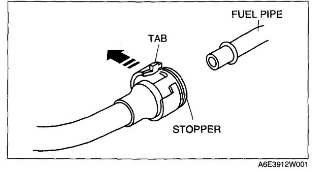

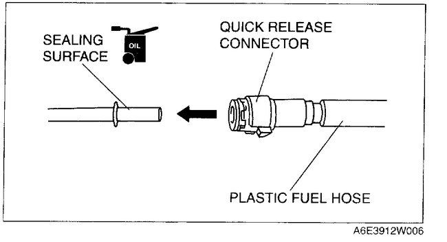

Plastic Fuel Hose Removal Note:
CAUTION: The quick release connector may be damaged if the tab is bent excessively. Do not expand the tab over the stopper.
1. Disconnect the quick release connector.
1. Push the tab on the locking coupler 90° until it stops.
2. Pull the fuel hose straight back.
NOTE:
pic 3
- The stopper may be removed from the quid-connector. Take care not to lose it. Reinstall it to the quick release connector before reconnecting the fuel line.
pic 4
- The locking coupler has two internal locking tabs which retain the fuel pipe. Be sure that the tab on the locking coupler is rotated until it stops to release two internal locking tabs.
pic 5
2. Cover the disconnected quick release connector and fuel pipe with vinyl sheets or the like to prevent them from being scratched or contaminated with foreign material.

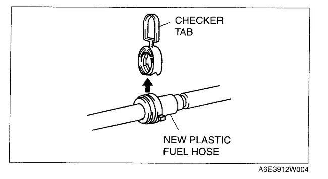

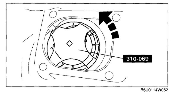

Fuel Pump Cap Removal Note:
pic 6
1. Using the SST, remove the fuel pump unit.
Fuel Pump Unit Installation Note:
pic 7

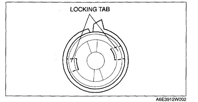

1. Verify that the fuel tank mark is aligned with the fuel pump mark as shown.

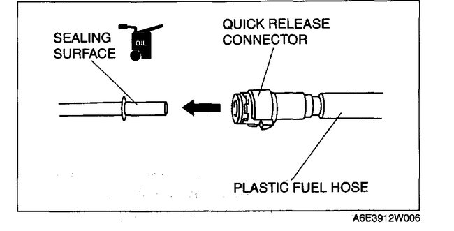

Plastic Fuel Hose Installation Note:
pic 8
NOTE: A checker tab is integrated with quick release connector for new plastic fuel hoses. The checker tab will be released from the quick release connector after it is completely engaged with the fuel pipe.
1. When the retainer is not removed, perform the following procedure.
1. Inspect the fuel pump unit sealing surface for damage and deformation, and replace as necessary.
- If the quick release connector O-ring is damaged, replace the plastic fuel hose.
pic 9
2. Slightly apply clean engine oil to the sealing surface of the fuel pump unit.
3. Align the fuel pipe on the fuel pump unit and quick release connector so that the tabs of the retainer are correctly fitted into the quick release connector. Push the quick release connector straight into the retainer until a click is heard.
4. Lightly pull and push the quick release connector a few times by hand and verify that it can move 2.0 - 3.0 mm {0.08 - 0.11 in} and it is connected securely.
- If quick release connector does not move at all, verify that O-ring is not damaged and slipped, and reconnect the quick release connector.

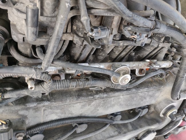

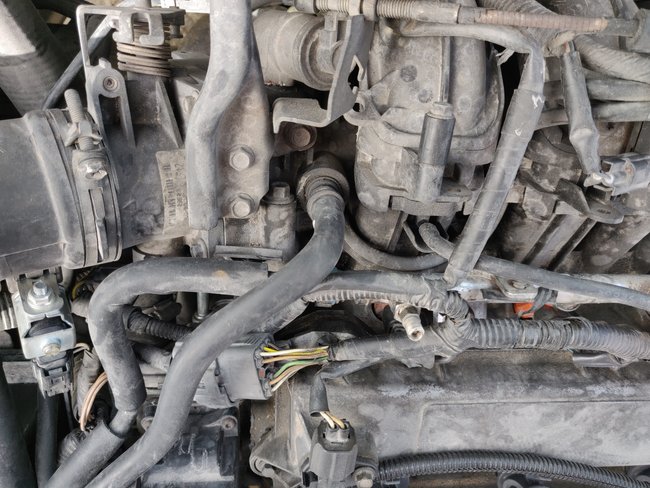

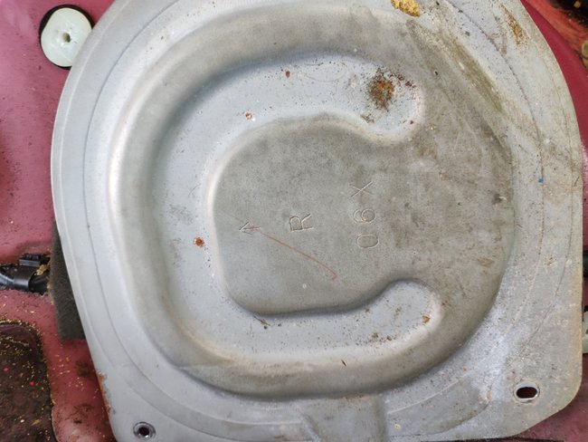

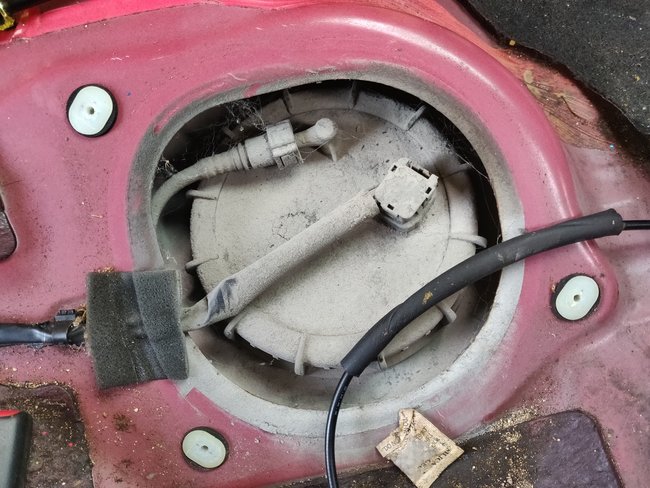

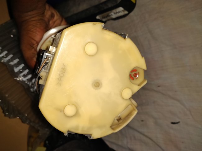

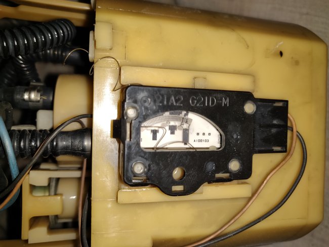

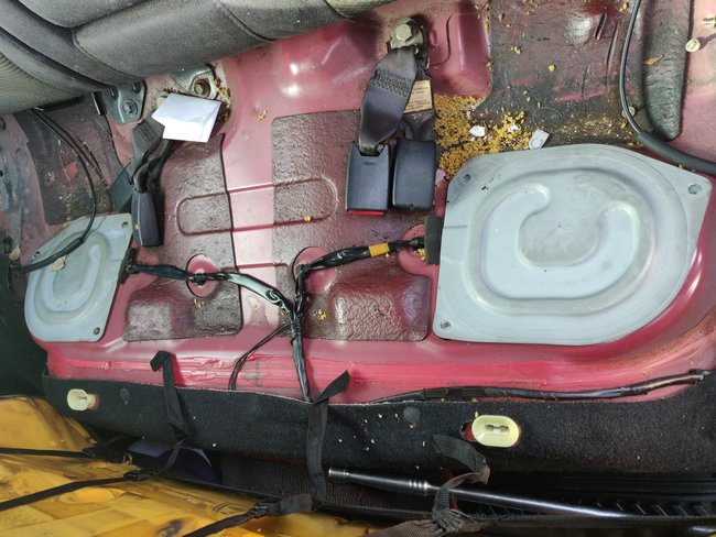

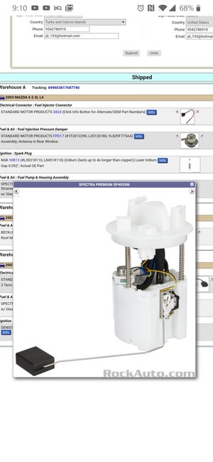

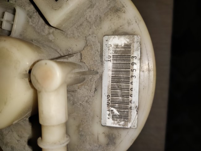

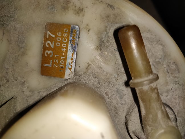

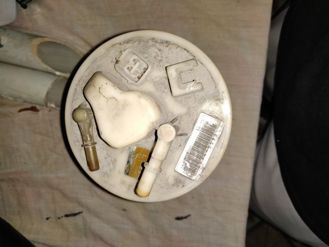

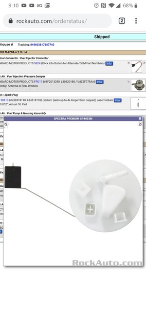

Aug 16, 2019 at 8:50 PM
Thank you Joe. Thanks for all the information.

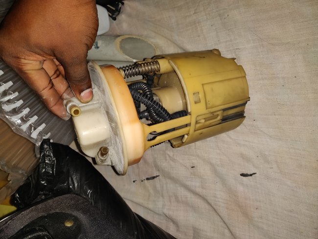

Quick question as I am not to clear on which one is just the cut off assembly.
Is the cut off assembly the one with just two lines leading to it (the one on the right) or the one with multiple lines leading to it (the one on the left)?
How do I know which one is the one i have to change?
Thank you
Thank you
Aug 16, 2019 at 9:14 PM
Welcome back:
I'm almost certain it is on the driver's side. If you look at the pictures from the directions, you should be able to eliminate the wrong one.
Let me know how things work out for you.
Take care.
Take care.

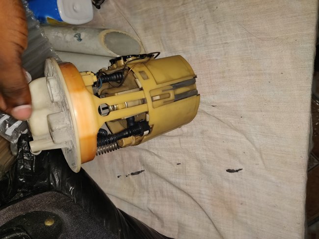

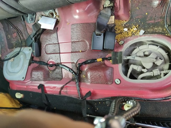

Aug 16, 2019 at 10:13 PM
I guess what I will do is turn the key to the run position without starting the car and listen for when the fuel pump primes then I should be able to tell which side it is.
Aug 17, 2019 at 4:47 AM
Aug 17, 2019 at 4:53 PM
I found it. It is on the left side. Will let you know how it goes.
Aug 17, 2019 at 5:13 PM
Welcome back:
That's the one I thought. Let me know.
Aug 17, 2019 at 5:27 PM
Fuel pump works. Thanks again Joe.

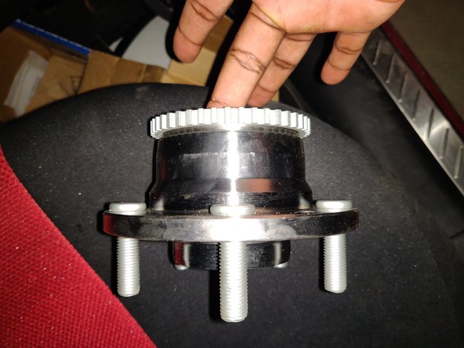

Aug 18, 2019 at 9:15 PM
Thank you for your words of encouragement Joe. I am about to go to the few auto parts store we have to look for it. I wish I knew the size.
The slide hammer and bearing press kit I ordered will be reaching this weak so I will let you know how that works out.

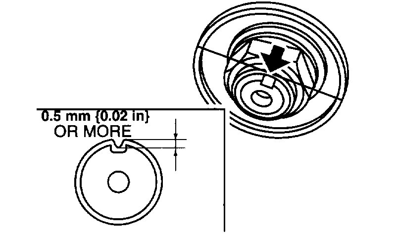

Aug 19, 2019 at 4:57 AM
Hey Joe,
How do you know if the fuel injectors are seated properly?
I changed them last night.
Aug 19, 2019 at 1:30 PM
Welcome back:
If not installed properly, usually they leak. The vehicle may not run at all or have a misfire also. Here are the directions for your vehicle to remove and replace. The pics correlate with the directions.

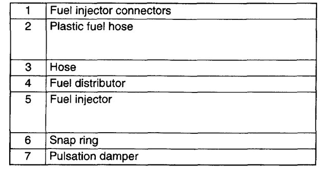

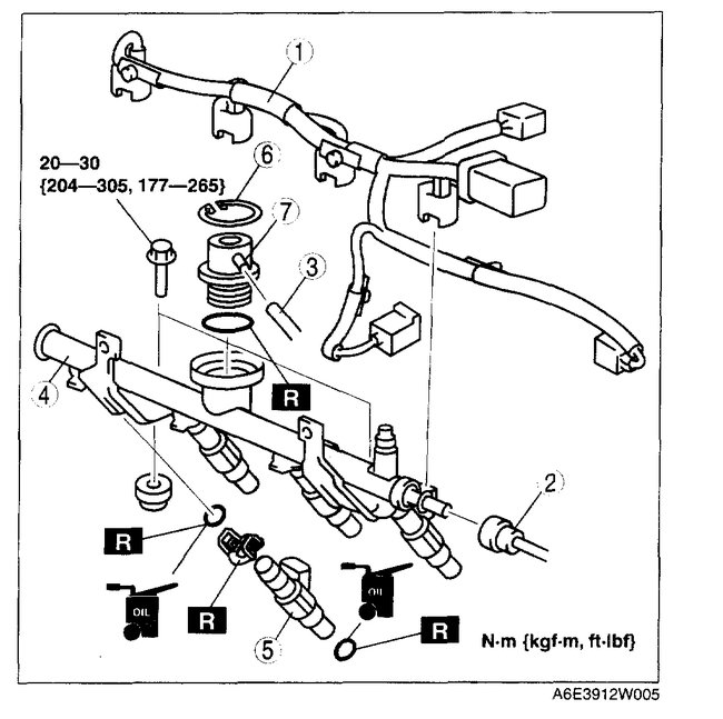

pic 1
pic 2
3. Remove in the order indicated in the table.

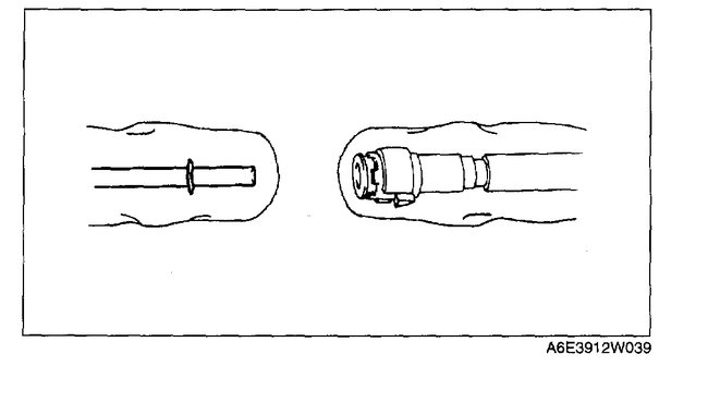

NOTE:
pic 3
- The stopper may be removed from the quick connector. Take care not to lose it. Reinstall it to the quick release connector before reconnecting the fuel line.
pic 4
pic 5

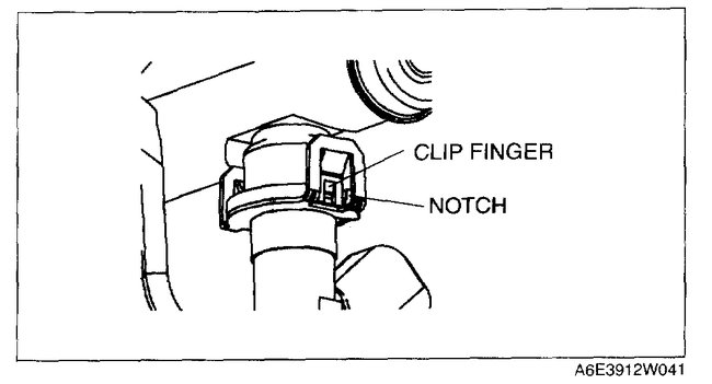

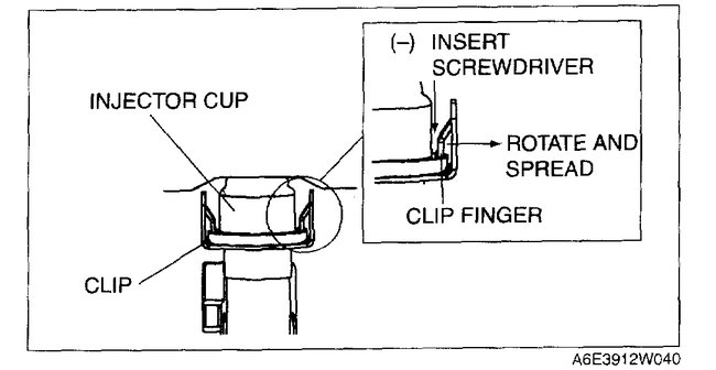

Fuel Injector Removal Note:
CAUTION: Use of a deformed injector retaining clip will cause the injector to not engage correctly. Always use a new clip when reattaching the injector, otherwise it may cause the injector to rotate.
pic 6
1. Insert a screwdriver between the injector cup and the clip fingers.
pic 7
NOTE: When rotating the screwdriver to spread the clip fingers, bend them sufficiently to make sure they release from the notched edge of the injector cup.
2. Rotate the screwdriver to spread the clip fingers and remove them from the injector cup.
3. Pull the injector and clip out of the rail.
pic 8

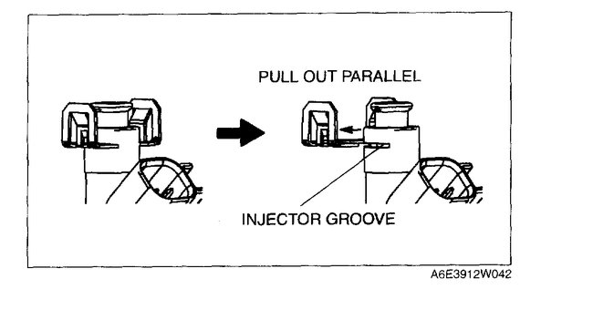

4. Remove the clip from the injector according to the following:
1. Grasp the clip with a pair of pliers.
2. Pull the clip parallel to the injector groove, and remove it from the injector.
3. Discard the clip.

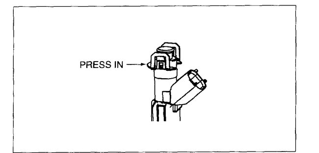

Fuel Injector Installation Note:
1. Lightly lubricate the injector groove and O-ring.
2. Pre-attach a new clip in the injector groove.
NOTE: When the clip is attached correctly, the central area of the injector and the clip finger positions are aligned.
pic 9
3. Hold the injector firmly, push the clip into the injector until the clip stops sliding.
4. Verify that the injector connector position is correct, and press the injector and clip into the injector cup. Continue pressing until the clip contacts the lower surface of the injector cup.
5. Verify that the injector and clip are correctly attached with the clip locked onto the injector cup notch.

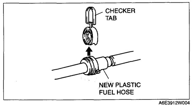

pic 10
1. Inspect the fuel pump unit sealing surface for damage and deformation, and replace if necessary.
pic 11
3. Align the fuel pipe on the fuel pump unit with quick release connector so that the tabs of the retainer are correctly fitted into the quick release connector. Push the quick release connector straight into the retainer until a click is heard.
____________________
Let me know if that helps.

pic 1
pic 2
4. Install in the reverse order of removal.
5. Complete the "AFTER REPAIR PROCEDURE". (See AFTER REPAIR PROCEDURE.)
NOTE:
pic 3
pic 4
pic 5
pic 6
pic 7
pic 8
pic 9
pic 10
pic 11

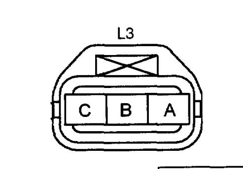

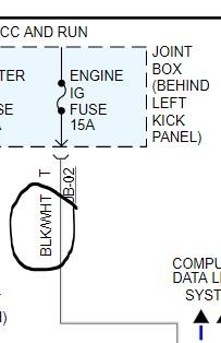

Hey Joe,
Sorry to be so annoying. I am putting in a new connector for my ignition coil and have a little trouble. All the lines coming from the connector are black. How do I tell which one is power, which one is ground and what the other one is?
I can let you know what colors were on the original connector lines if that will help.

I wanted to ask. What is a 'Cut Off Assembly's in reference to the fuel pump picture I showed you?
Thanks

Aug 25, 2019 at 3:57 PM
Hey Joe,
I figured everything out. I got the wrong fuel pump it seems. The one I took off the car has two openings at the top while the other has one. I thought I could just disconnect the cut off assembly and run it like that but I was so wrong, lol.. Lots of gas came out from the hose leading from the cut off assembly.
I took pictures to show you the difference on them.
Do you know where I can buy the correct fuel pump assembly? I have looked everywhere and cannot find it. Some help would be greatly appreciated.
Thanks Joe.
Thanks Joe.
Aug 25, 2019 at 6:14 PM
Doesn't have two spouts like the original. Seems there's no way I can find that fuel pump assembly.
Aug 25, 2019 at 8:26 PM
Can you get just a pump and install it into your fuel module?
Aug 25, 2019 at 9:10 PM

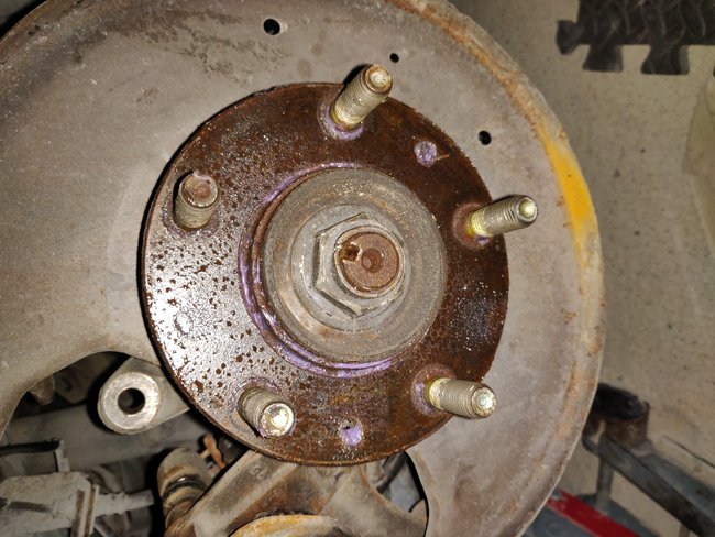

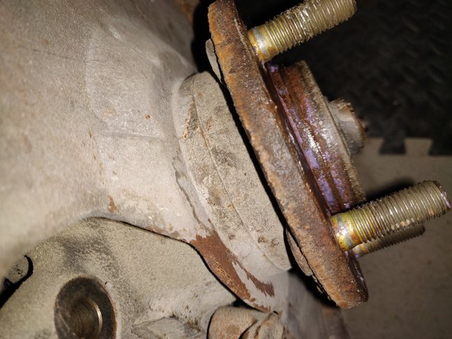

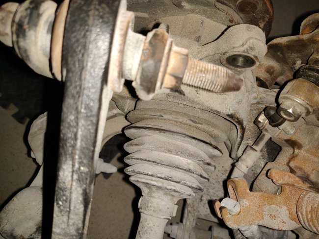

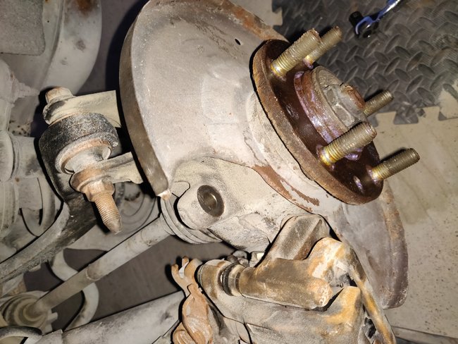

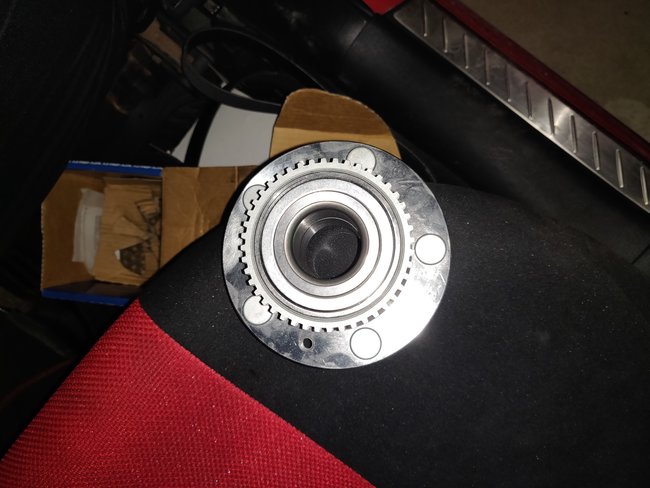

I switched the pump from the new fuel pump assembly I bought into my original fuel pump assembly.

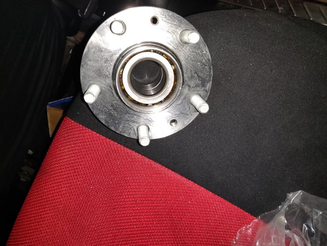

I went to remove the wheel bearing and noticed it doesn't look the same as what was in the manual I have. I think this might have been converted from a 4-wheel drive to a two wheel drive.
So I totally give up. I'm done Joe, lol.
Aug 26, 2019 at 5:15 PM
Did the fuel pump work? Also, can you provide a picture of the new bearings?

Ugh... Well the one I have on now should do then. I still don't see why the tensioner pulley is rattling. It's brand spankin' new.
Also, the fuel pump works.
