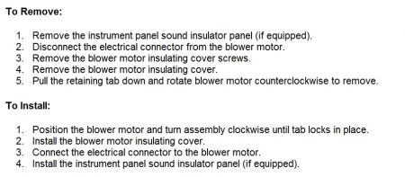

I am looking to buy a fan motor I just need to know how to put it in the car.

The blower motor should be under the passenger side of dash.
