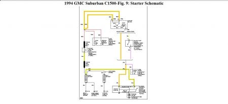

I have a 1994 Chevy Suburban 5.7 liter V8 that will not crank over, no click nothing. Replaced starter same thing?
Monday, September 7th, 2009 AT 11:31 PM
MECHANIC
75,992 POSTS
Short out the starter solenoid if it cranks the engine over-check and test the ignition switch-if not starter problem.
