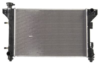

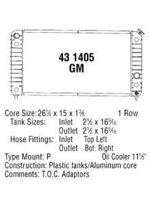

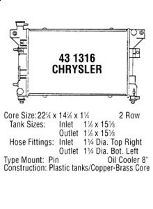

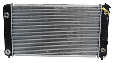

will a 1992 dodge dynasty radiator fit in a 2000 gmc jimmy
Friday, May 22nd, 2009 AT 7:27 PM
ZACKMAN
MECHANIC
4,202 POSTS
Different size. Wrong hose placement, to say the least...
