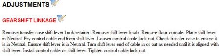

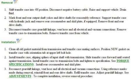

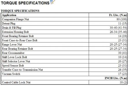

How do you replace a transfer case motor?
Sunday, December 14th, 2008 AT 11:10 PM
BLUELIGHTNIN6
MECHANIC
16,542 POSTS
Hello
Below is the info you requested.
Hope this helps..
