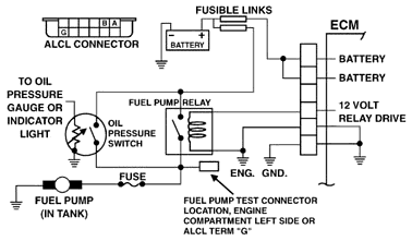

I have repaced three fuel pump within a year and now this pump is not running. Am I getting the wrong pump or do I have a bad wire somewhere? How can I find the problem? Please help!

Get the repair manual see below-Lets start by finding the fuel pump relay and fuel pump/oil pressure sending unit tested.
This is how things goes-The computer energizes the relay for 2 secs for an initial build up pressure when vehicle fires up the fuel pump/oil pressure sending unit powers up the pump from there on.
See the circuitry below
https://www.2carpros.com/forum/automotive_pictures/12900_oil_sending_unit_and_fuel_pump_circuit_21.gif
