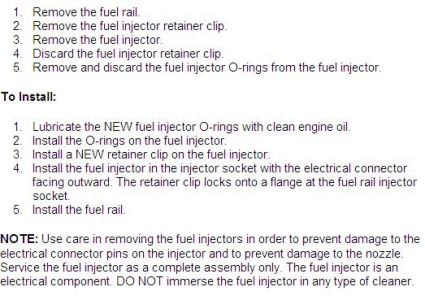

How do I locate and remove and or clean /replace fuel injectors?
Sunday, August 23rd, 2009 AT 11:19 AM
JDL
MECHANIC
16,098 POSTS
Make sure there is no pressure on the system before taking anything loose.
