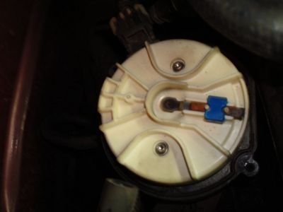

MIDGET777
It looks like the rotor that has some corrosion. I am trying to post a picture.
https://images.2carpros.com/forum/automotive_pictures/363877_upload_1.jpg
https://images.2carpros.com/forum/automotive_pictures/363877_upload2_1.jpg

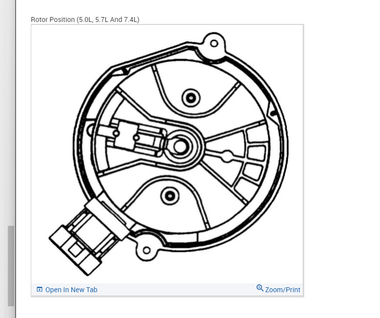

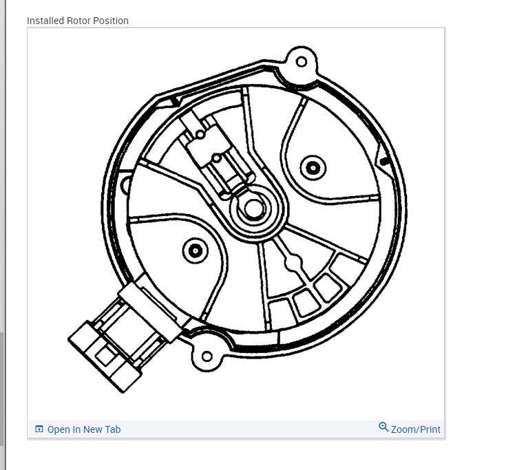

Sounds like you think the issue is with the rotor and if you have replaced all this other stuff and not the rotor then I would trust your instincts.
Here is a guide that will help with checking for spark in case you need it, but it sounds like if we go with the rotor that it will solve the issue.
I am attaching the info from the manual on how to install it.
Please let us know what you find. Thanks

MIDGET777
I replaced the rotor, and it was the problem. I replaced that and the cap, and it runs great.
