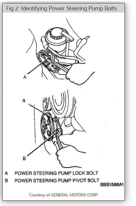

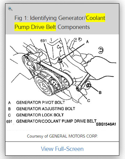

How do I put the serpentine belt on? There is no tension pulley and I can't figure out how to release the tension to be able to put the belt on.
Thank you!

Here is a guide to help see how to change the belt with diagrams below for you car.
Loosen generator adjusting bolt, pivot bolt and lock bolt and Remove generator/coolant pump drive belt. Check out the diagrams (Below). Please let us know if you need anything else to get the problem fixed.
