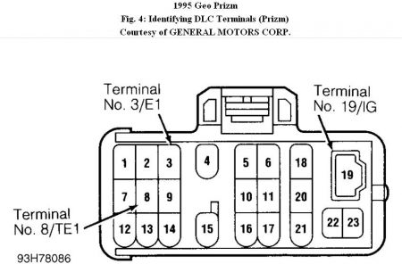

Yes, the ignition timing is adjustable by turning the distributor but the DLC terminal E1 and TE1 have to be bridged while checking and adjusting.
https://www.2carpros.com/forum/automotive_pictures/192750_DLC95PrizmGif04_1.jpg

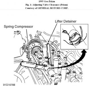

Valve clearances is the amount of clearance between the camshaft lobes and the valves. You need to remove the valve cover to do that.
Shims are used for adjustment and you need to measure them and then change the shims to trhe correct thickness to get the desired clearance.
https://www.2carpros.com/forum/automotive_pictures/192750_ValveClearance95Prizm16Fig01_1.jpg
