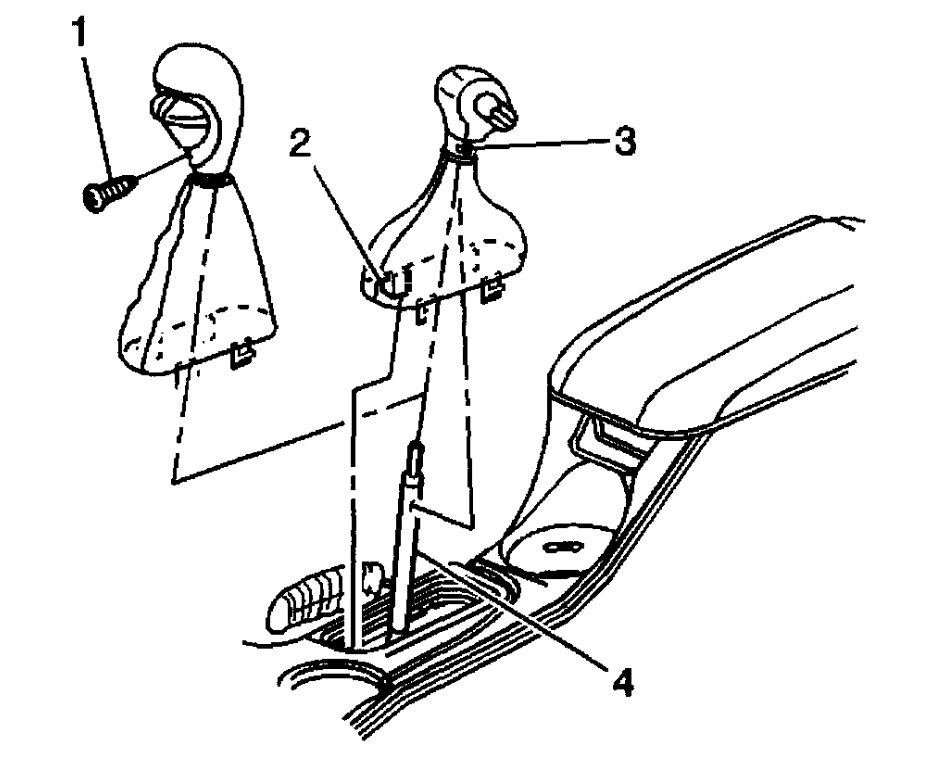

When I turn the key counterclockwise it will not go all the way to the left so I can take the key out. So, I want to remove the center console to check the switch under there, but I don't see no screw in the shift knob to take out how do I remove the shift knob?

Hello, I will list the procedure for shift lever knob removal below, with a diagram attached below.
1. The floor shift control knob and boot are serviced as an assembly.
2. Loosen the set screw (3)
3. Push in at the base of the boot to release the locking tabs (2) from the console assembly.
4. Pull up to remove the knob and boot assembly from the transmission control (4).
Installation is the reverse of removal.

I don't see no set screw on my transmission control. I wish I could add an Image here, but I don't know how to do it. I do have a picture of my assembly on my phone.

It will be a rather small screw and may be behind a small piece of plastic. After removing this you only need to pull up after disengaging the tabs on the boot.

I found the little screw and I did remove the floor shift control knob and boot assembly and the shift Interlock solenoid, if the solenoid is bad will it cause a stuck key? I can't pull the key out.

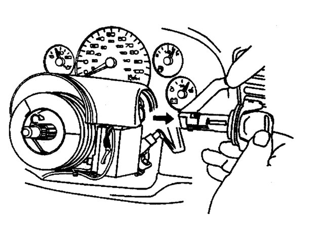

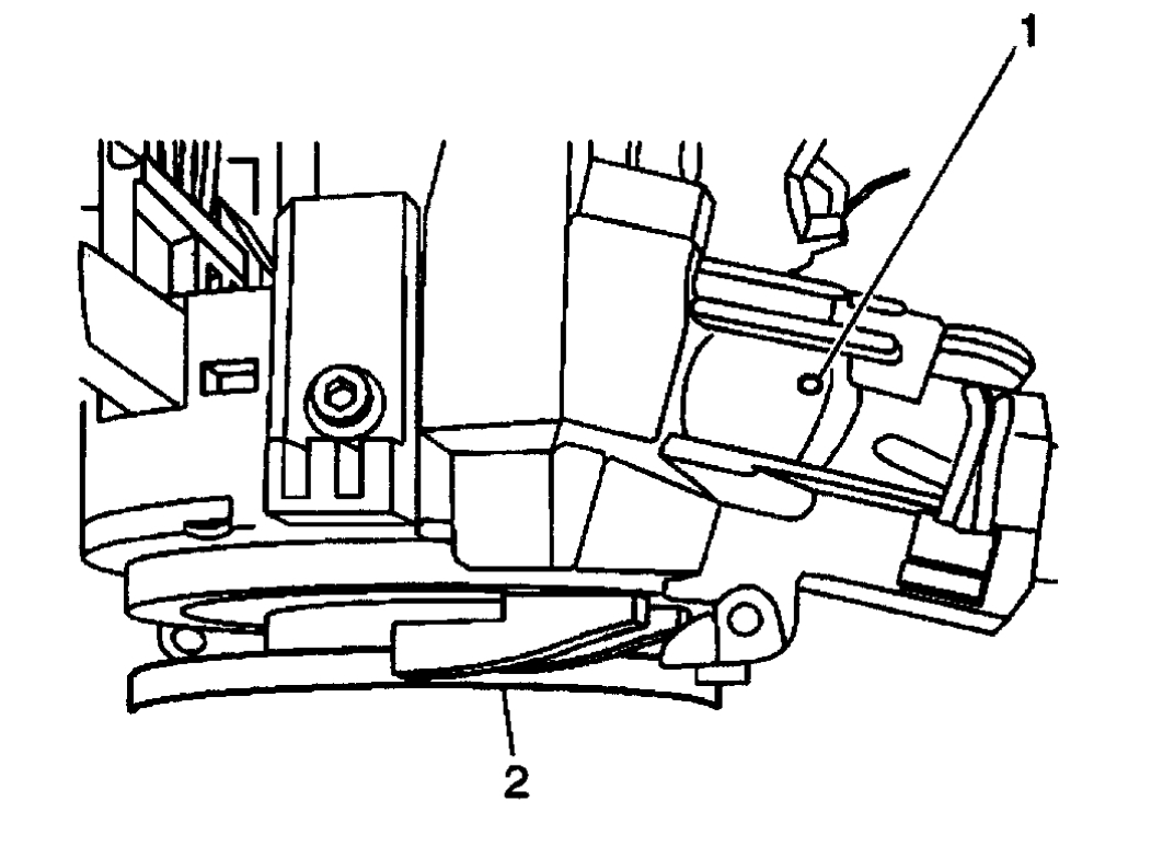

It sounds like you will need to replace the lock cylinder. I will post the instructions on cylinder removal below with pictures attached. Please let us know if you have any questions about this.
Ignition Lock Cylinder Replacement
Removal Procedure
1. Disconnect the battery negative cable.
2. Disable the SIR system.
3. Remove the steering column trim covers.
4. Turn the ignition lock cylinder to the start position.
5. Insert the tip of an awl into the access hole (1) of the ignition lock cylinder.
(see image 1)
6. Push down and hold the retaining pin of the ignition lock cylinder.

8. Remove the ignition lock cylinder by pulling the cylinder away from the steering column.
(see image 2)

If you can break it down to the point where the instructions mention using an awl or pin to depress the lock, you can experiment with the mechanical mechanism on where it locks up on you. If it consistently locks up or it is intermittent, it is definitely worn out. More times than not, the issue you are experiencing is due to a tumbler that has worn out. In this case, you can buy a tumbler and matching key set or have the tumbler and existing key matched.
