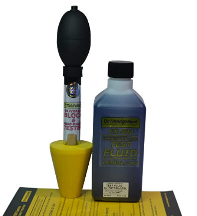

Recently I noticed reservoir coolant was low with a funny discolored mixture on bottom. Took reservoir out and dumped contents. It had a very strong gas smell to it. Immediate thought was head gasket, but car doesn't smoke, has full power without a hesitation at all, nothing in oil (not milky) or transmission mission fluid and still maintains excellent gas MPG. Recently used Chevron fuel system cleaner in probably in a little over concentrated manner.
Any thoughts?

A fuel smell in coolant is a good indicator of a blown cylinder head gasket, a warped head, or a combination. With the engine running, remove the radiator cap (but only when the car is cool!) and see if you observe any gas bubbling in the coolant.
Best to carry out a carbon monoxide test for the cooling system using a chemical block tester.
