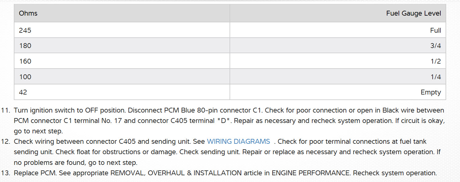

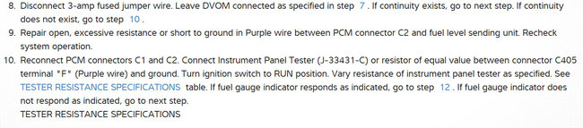

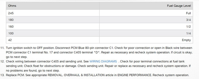

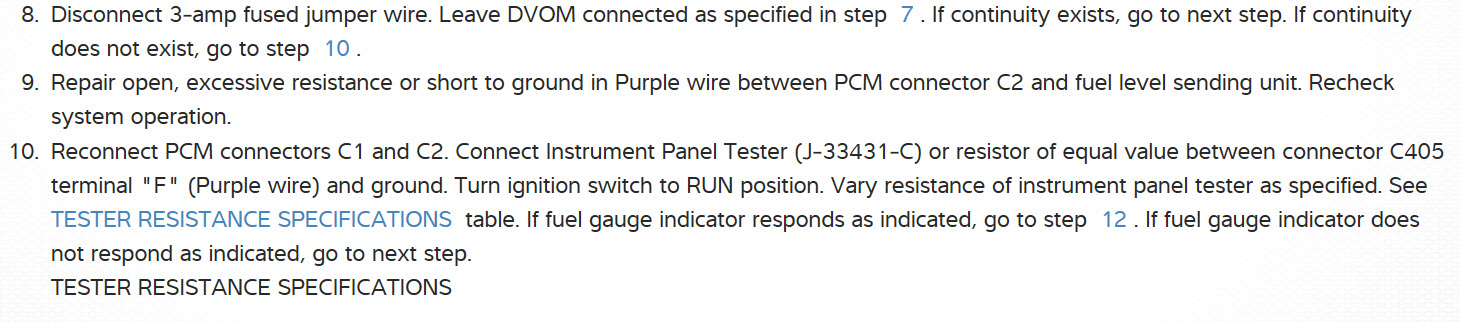

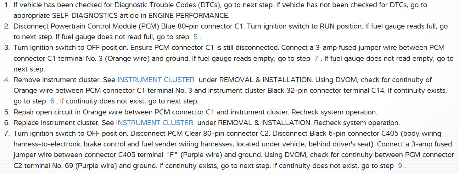

Gas gauge always reads F for full. Please help! (1999 Chevrolet Lumina)
Monday, February 6th, 2017 AT 10:23 PM
HMAC300
MECHANIC
48,601 POSTS
You need to have a mechanic scan for codes first. Then see pictures on how to diagnose this.
