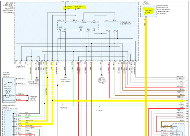

Taillights and turn signals fuse location needed.
Jan 29, 2022 at 7:39 PM
  • 110,193 POSTS

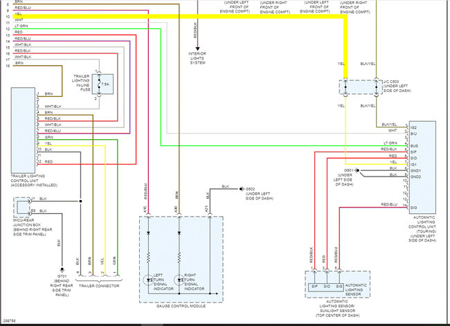

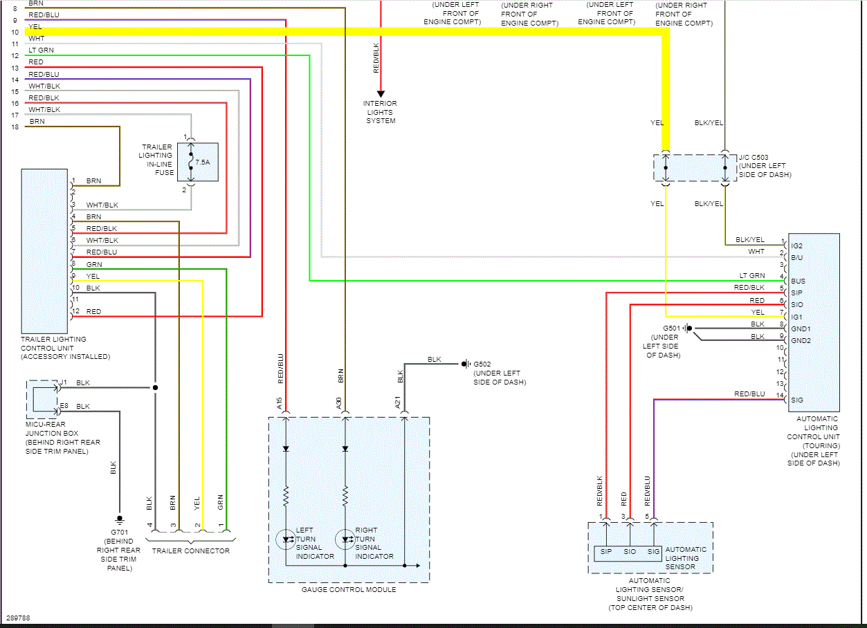

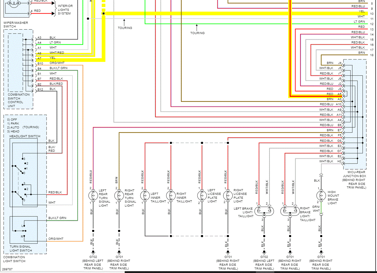

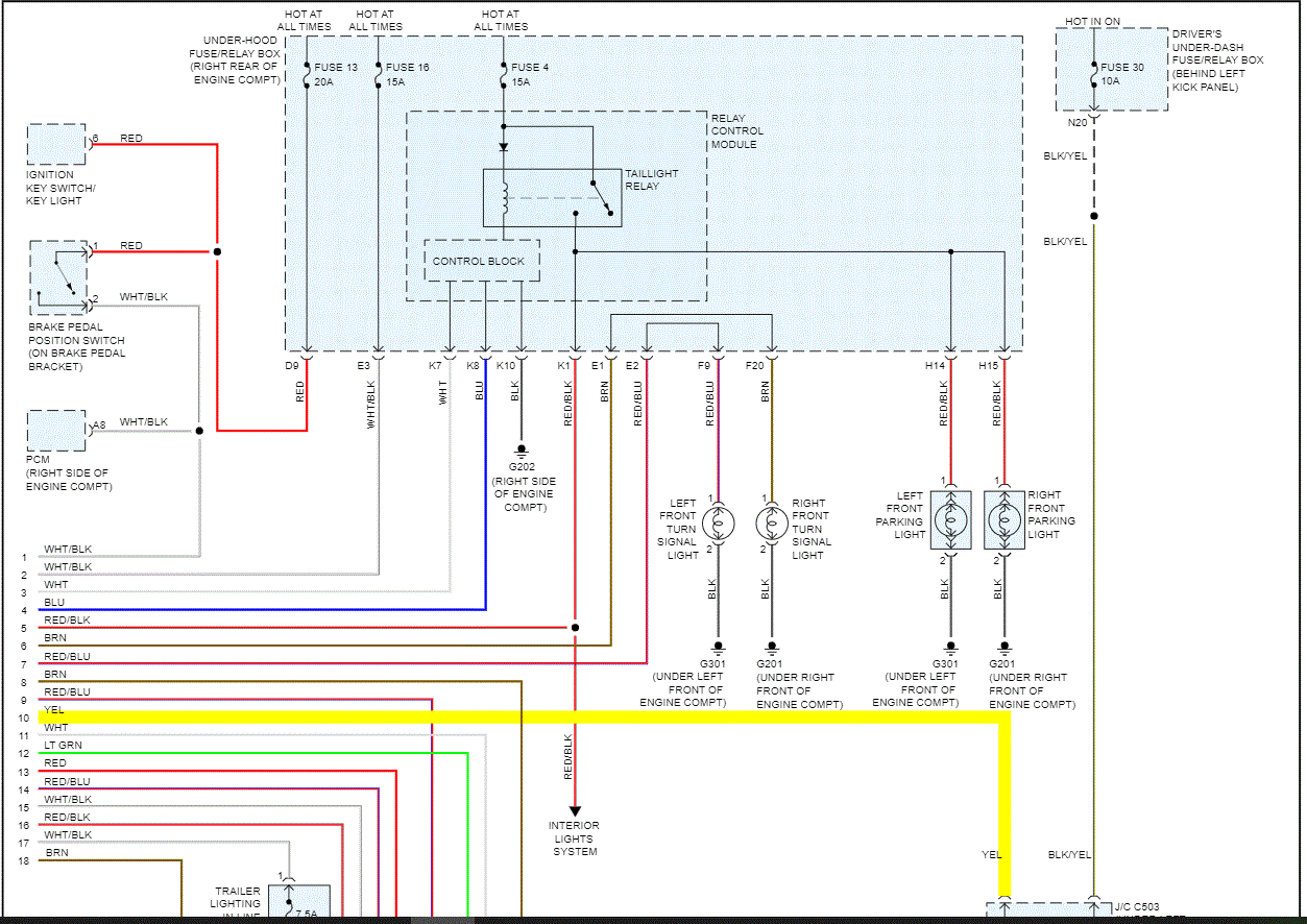

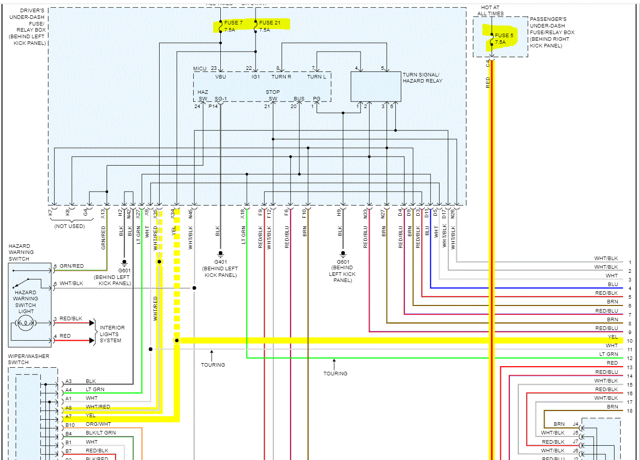

I attached the entire exterior lighting circuit schematic below. If you look at pic 1, there are fuses highlighted that are specific to the signals. At the top of pic 3, the fuses are for the parking lights.
I tried to find a pic of the fuse boxes, but they aren't listed in my manual. However, the fuse numbers are indicated in the schematics. Note: One of the fuse boxes (pic 1) is in the passenger compartment (under dash). The other is under the hood.
When you check fuses, in addition to making sure the fuse is good, make sure there is power to and from it. Here is a link you may find helpful:
Let me know if this helps or if you have other questions. I'll try my best to help.
See pics below. Note: The schematics were two pages. I had to cut them in half to make them readable for you. I did overlap them so you can follow from one to the next.
