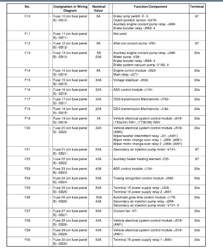

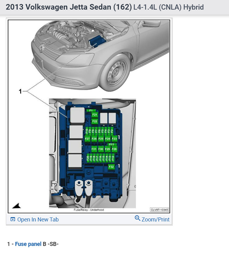

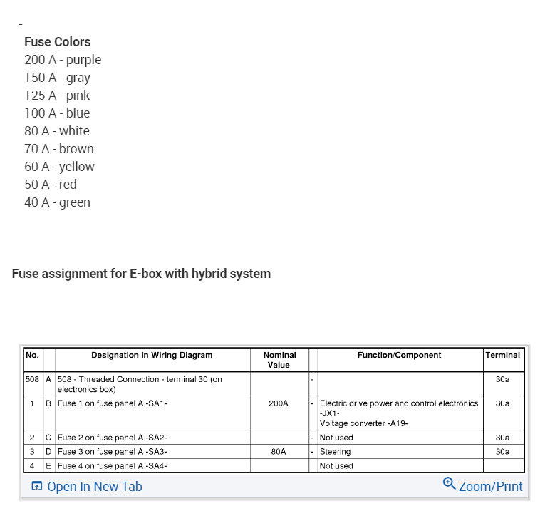

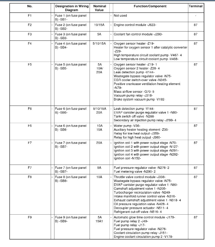

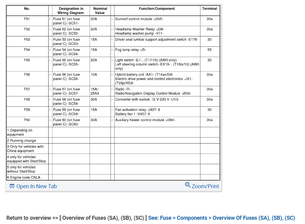

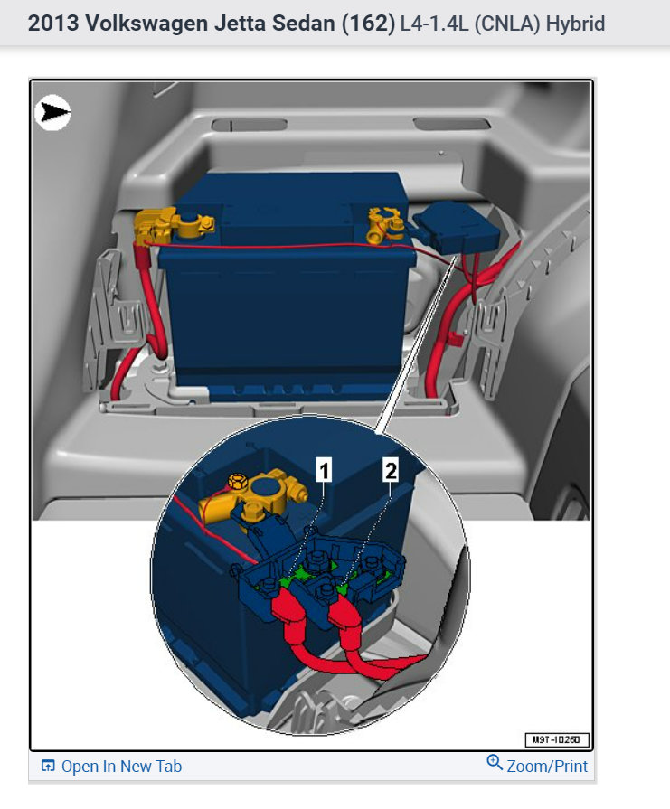

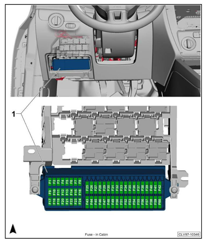

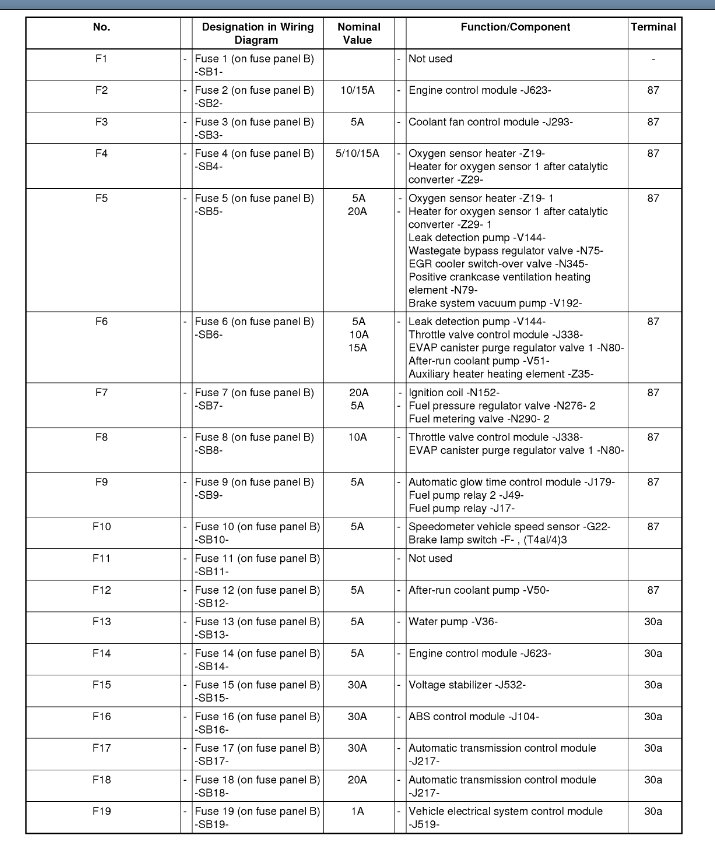

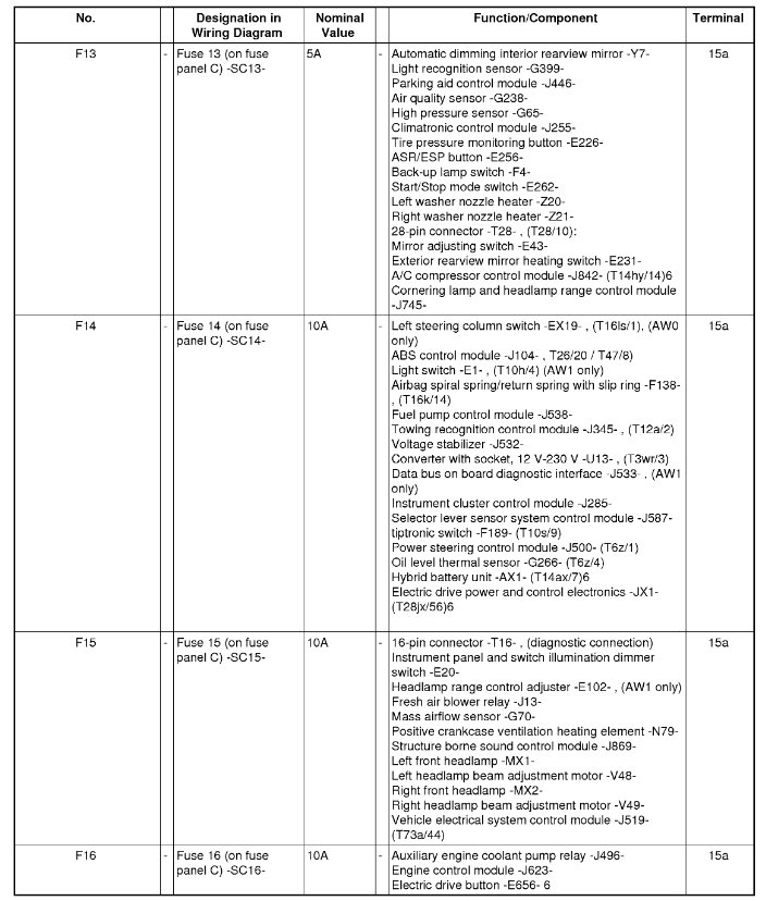

Hello, I’m needing to know what fuses and relays are supposed to be in my car. There are so many fuse boxes in this car, but it looks as if some are missing. Any help is so greatly appreciated.

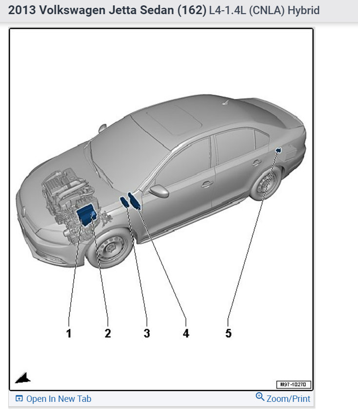

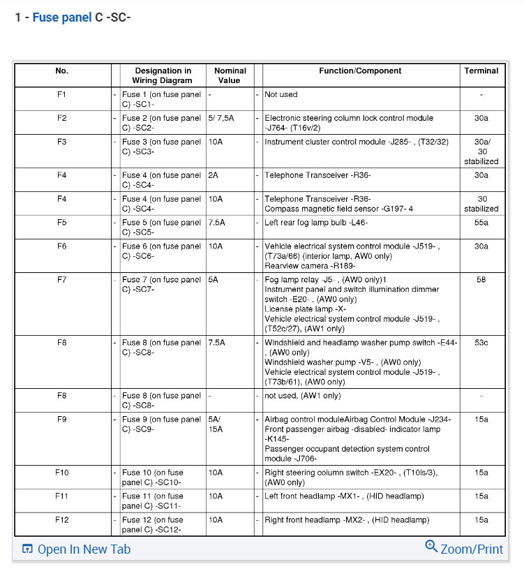

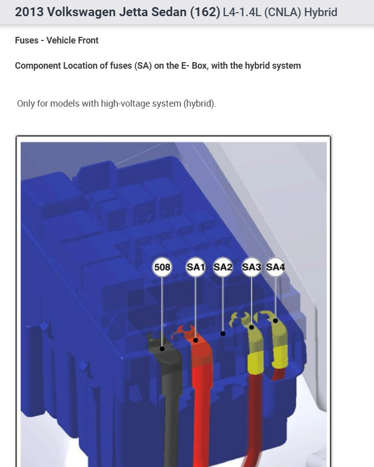

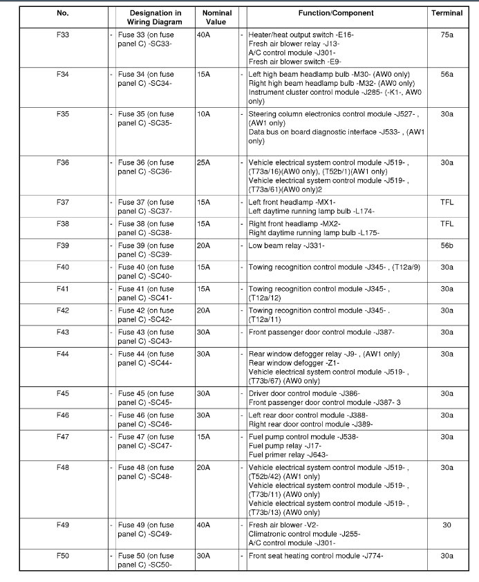

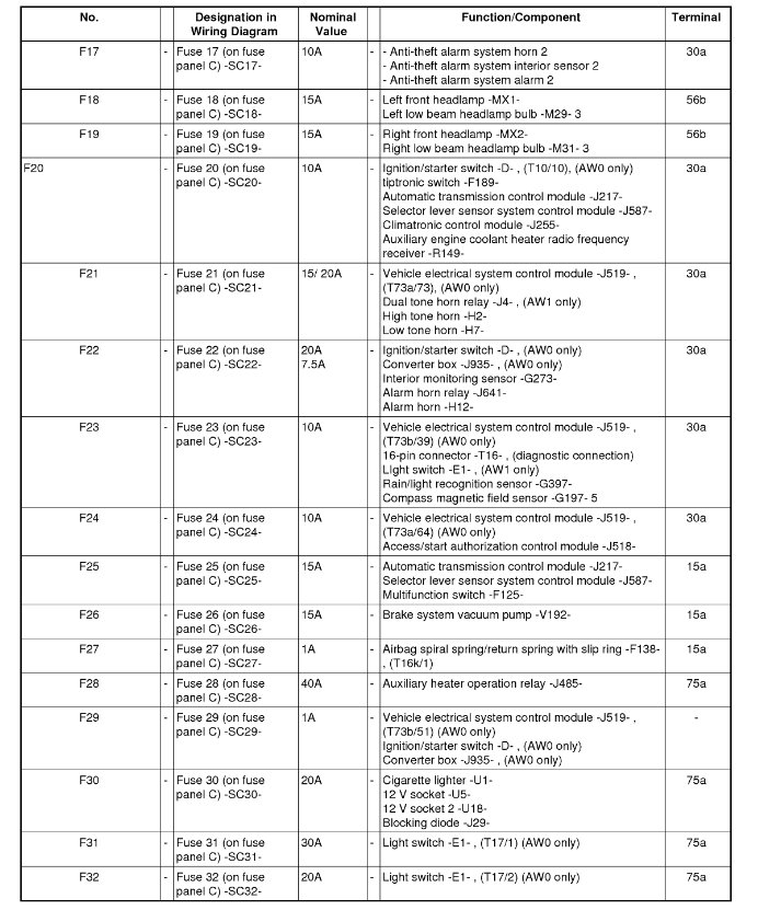

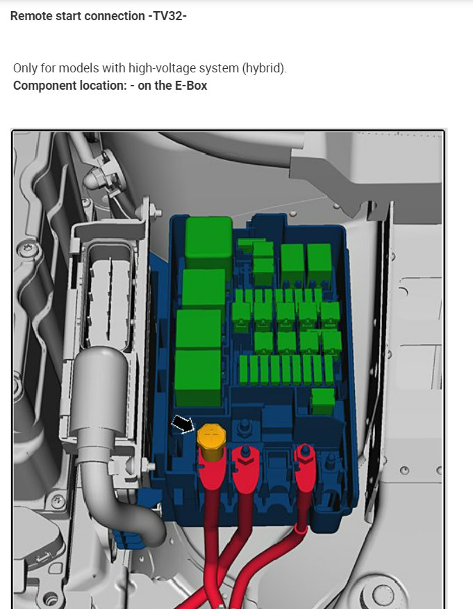

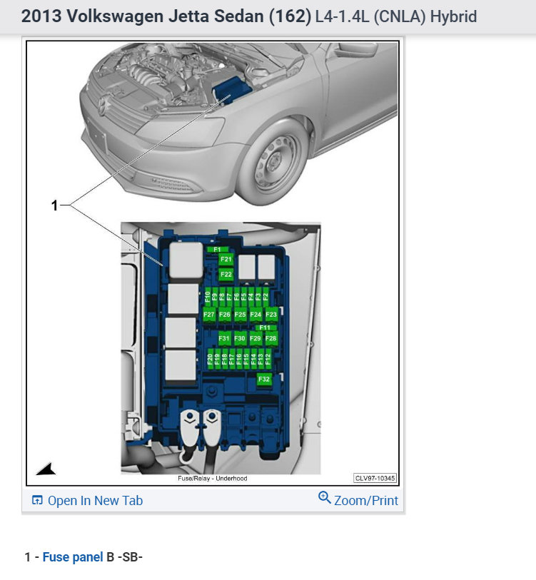

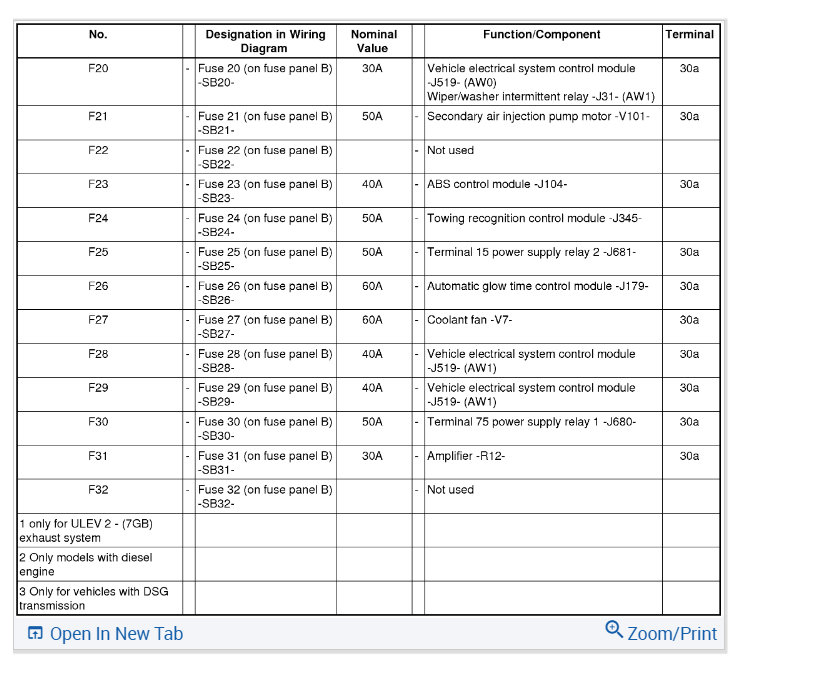

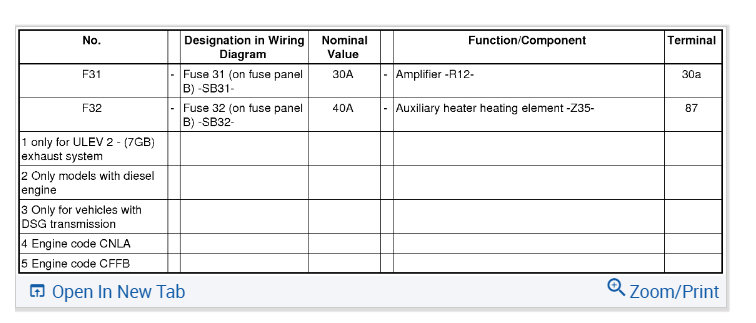

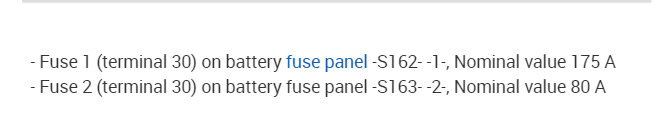

Can you upload a picture of what you are seeing so that way I can tell for sure what is going on? here is a guide to help check the fuses and the fuse panel location and identification for your car in the diagrams below:
Also there seem to be two different fuse panels depending on which options you have; I have included them both for you. Check out the diagrams (below). Let us know what happens and please upload pictures or videos of the problem.
