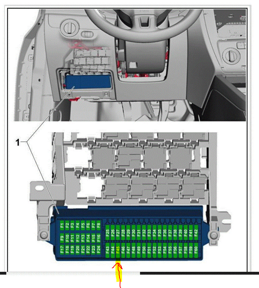

Hi, can you tell me where to locate it and what kind of fuse to use.

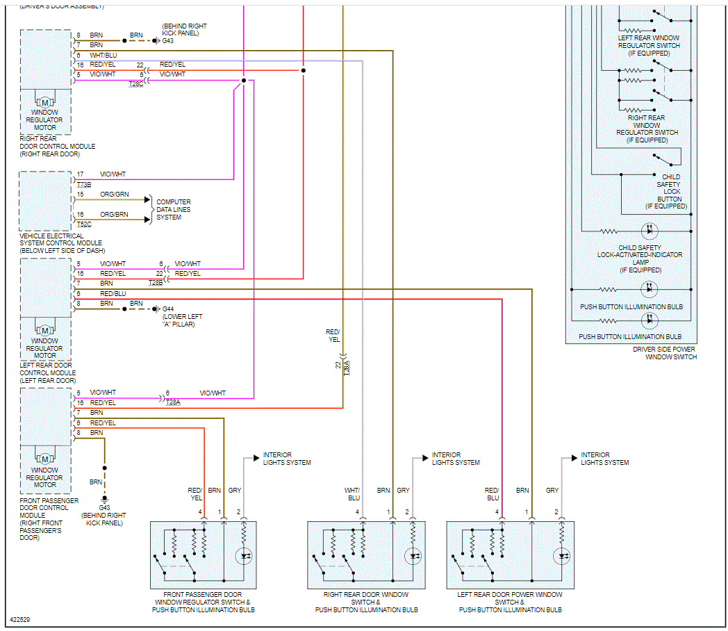

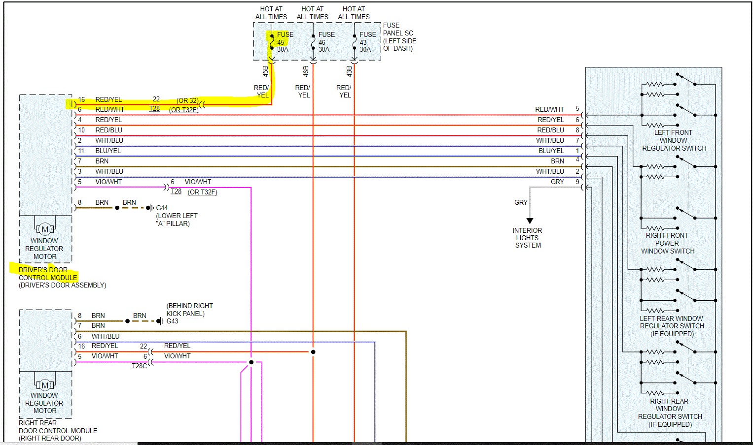

It will be located in the fuse box in the vehicle, left side. If you look below, I attached the wiring schematic of the power windows. I highlighted the fuse going to the left front window.
If you look at pic 3, I included a pic of the location and which fuse to check. Note that when checking a fuse, if the fuse is good, make sure there is power to it. Here is a link you may find helpful:
The fuse is 30 Amp.

I found it but it was good. My window wouldn’t go up once. I turned the car off and then on and it went up. It happened three other times and that’s when I checked the fuse. It seemed good and I didn’t replace it, but the window is working. Maybe me taking it out and putting it back in. Not sure...

It is very possible that there was a loose or corroded connection that is now making better contact. Regardless, I'm glad to hear it's working for you.
