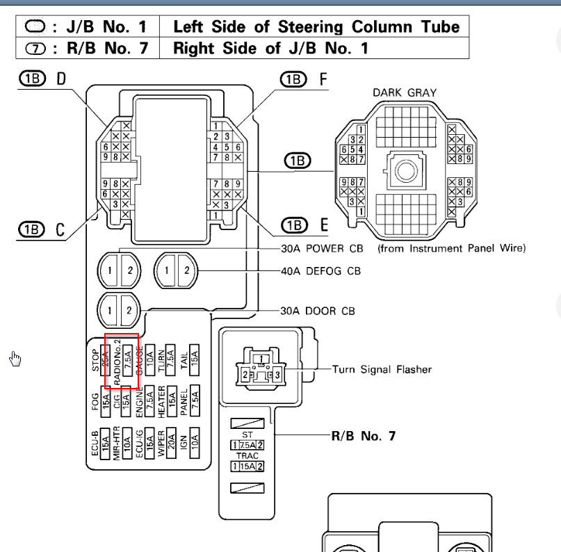

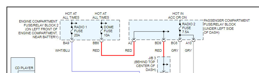

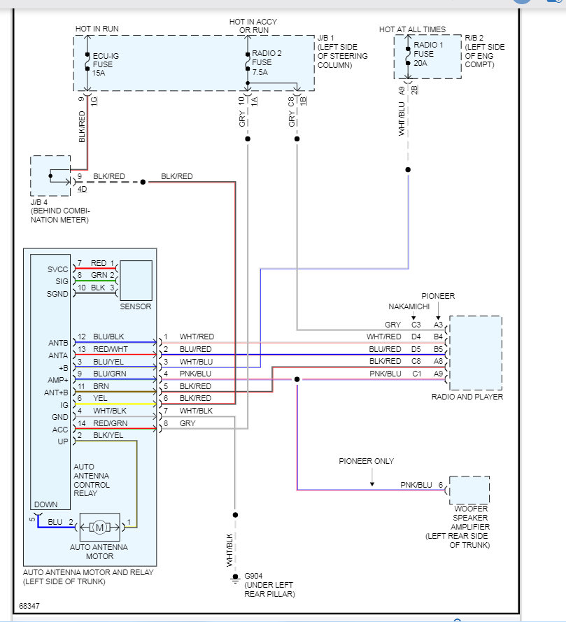

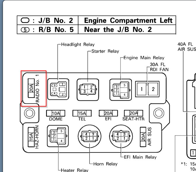

Radio and power antenna inoperable..Need diagram of fuse box.
May 28, 2020 at 10:14 AM
  • CAR REPAIR CONTRIBUTOR
I attached the info on these fuses. Let us know if you need more info and we can go from there. Check out the diagrams (Below). Please let us know if you need anything else to get the problem fixed. Thanks
