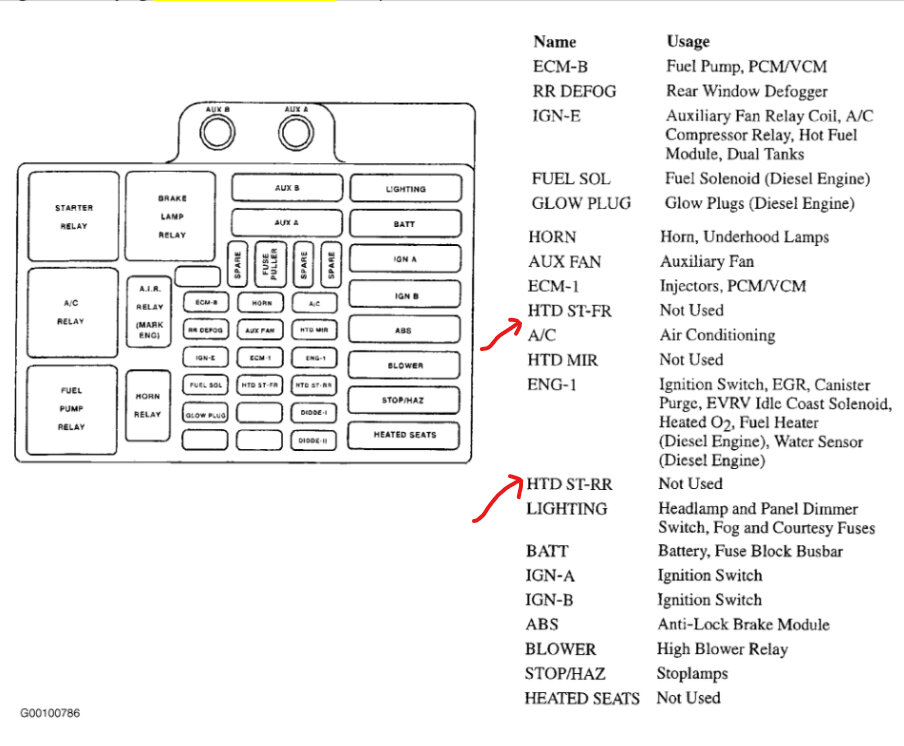

What is a htd st-rr fuse
Saturday, February 20th, 2016 AT 4:41 PM
WRENCHTECH
MECHANIC
20,761 POSTS

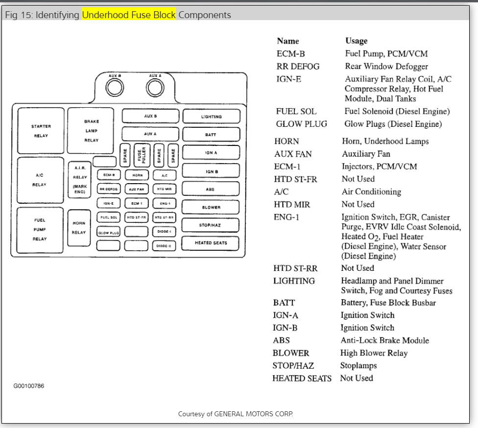

The htd st-rr is not used, check out the diagrams below. Check out the diagrams (Below). Please let us know if you need anything else to get the problem fixed.
