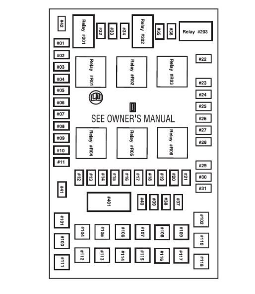

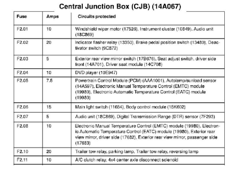

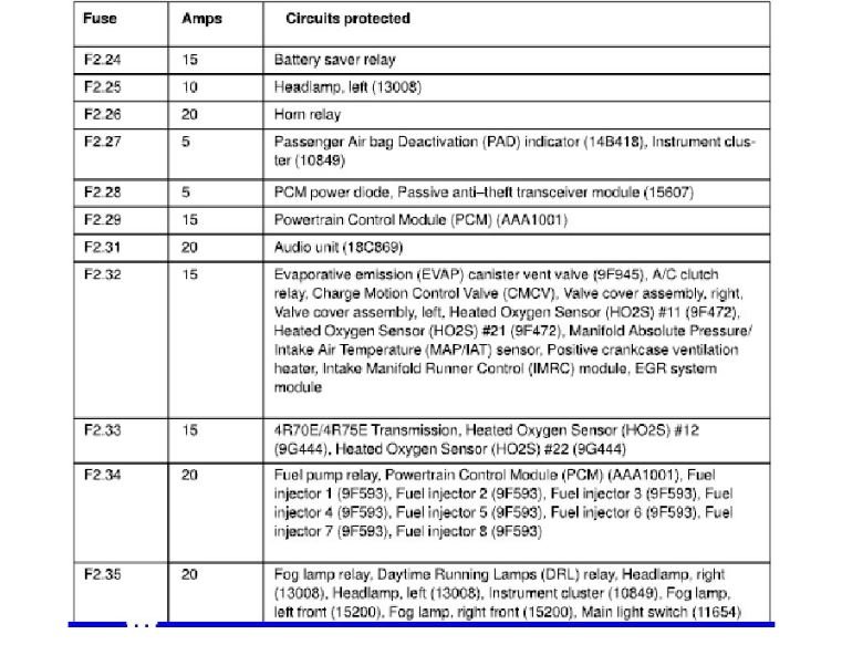

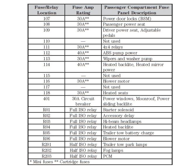

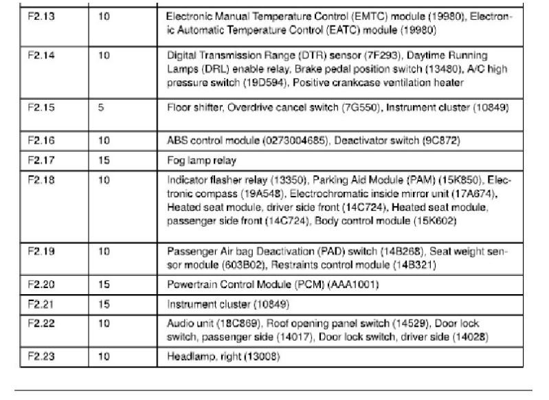

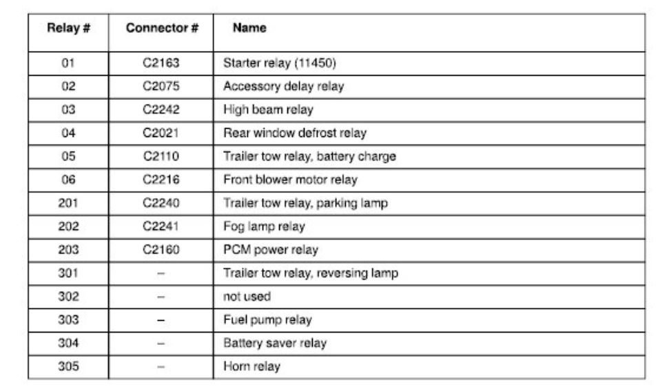

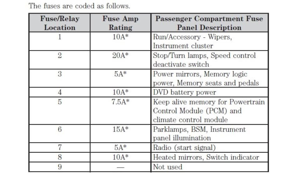

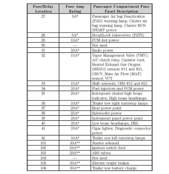

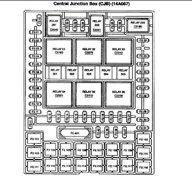

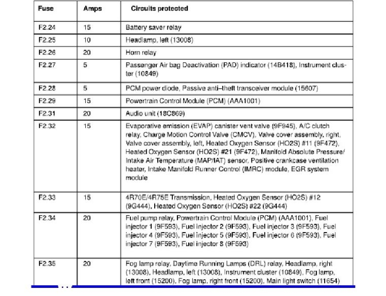

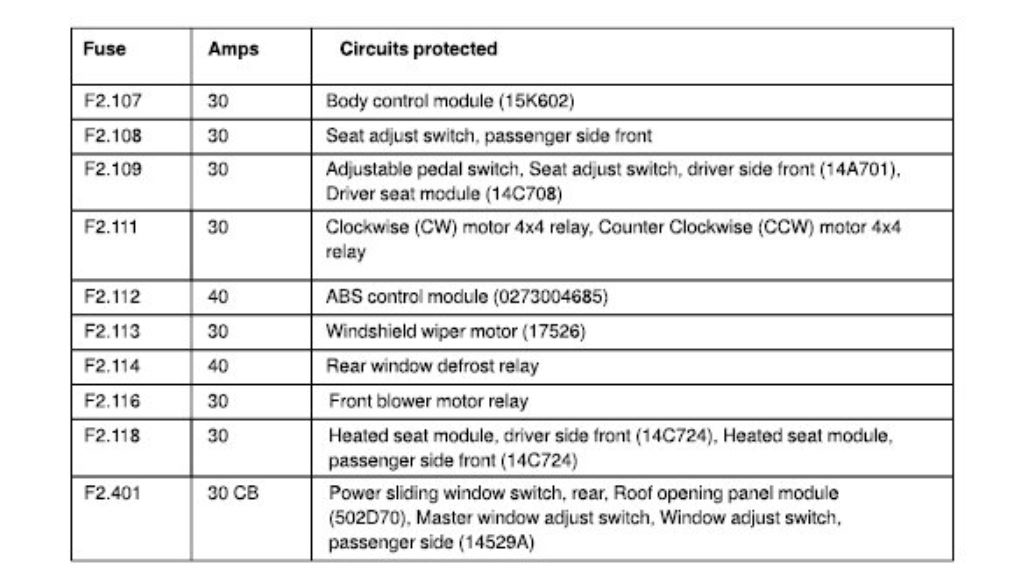

I need the diagram to interior fuse box passenger side.
Friday, June 7th, 2019 AT 1:07 PM
MECHANIC
52,796 POSTS
Good afternoon,
I will attach the fuse box legend. This guide can help as well
