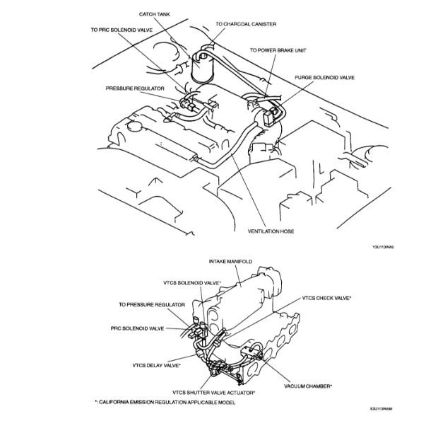

Fuel trim are high at idle or under load about 15%. What can cause this?
At wide open throttle the O2 sensor goes rich all the time which indicates it is not an air fuel problem right?

Long term fuel trim is 15% short term in the positive also. Can you give me vacuum hoses diagram?
Like I said at wide open throttle the O2 sensor goes rich all the time.
+1
Monday, May 7th, 2018 AT 7:58 AM
Sure.
Monday, May 7th, 2018 AT 10:02 AM
