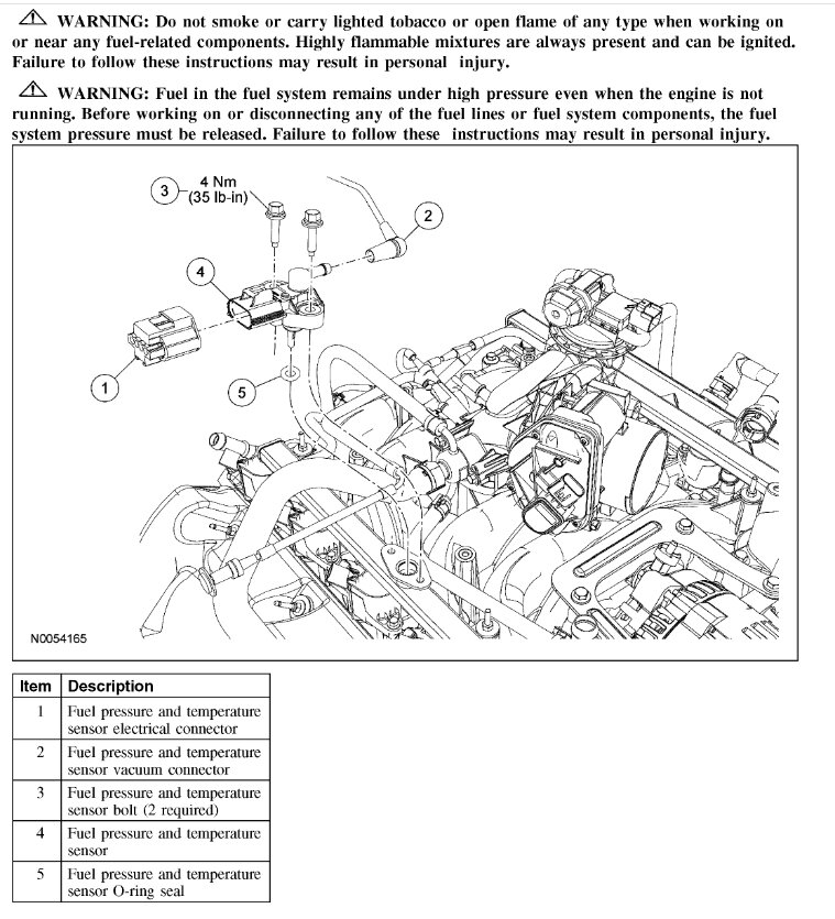

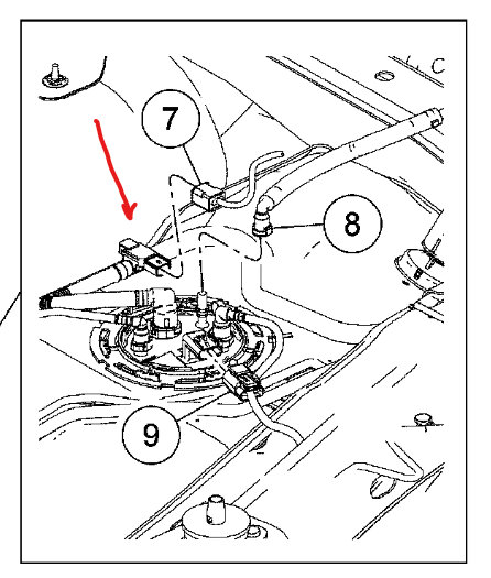

Here are the code meanings.
P0451 - Evaporative Emission Control System Pressure Sensor Range/Performance
P0642 - Sensor Reference Voltage "A" Circuit Low
P1450 - Unable to Bleed Up Fuel Tank Vacuum

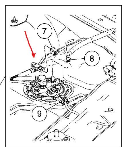

You might need the PCM reflashed, but these codes are pointing to a faulty fuel tank pressure sensor. Here is the location of the sensor so you can check the connector and if okay I would replace the sensor. Can I ask if the fuel cap is in good condition and has its O ring? Clear the codes once the job is completed. Check out the images (below). Please let us know what happens.

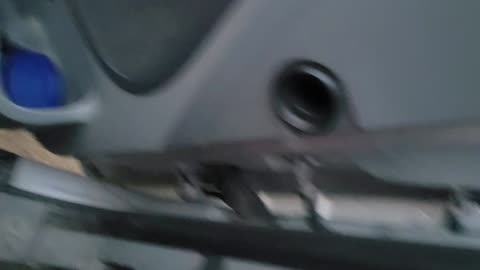

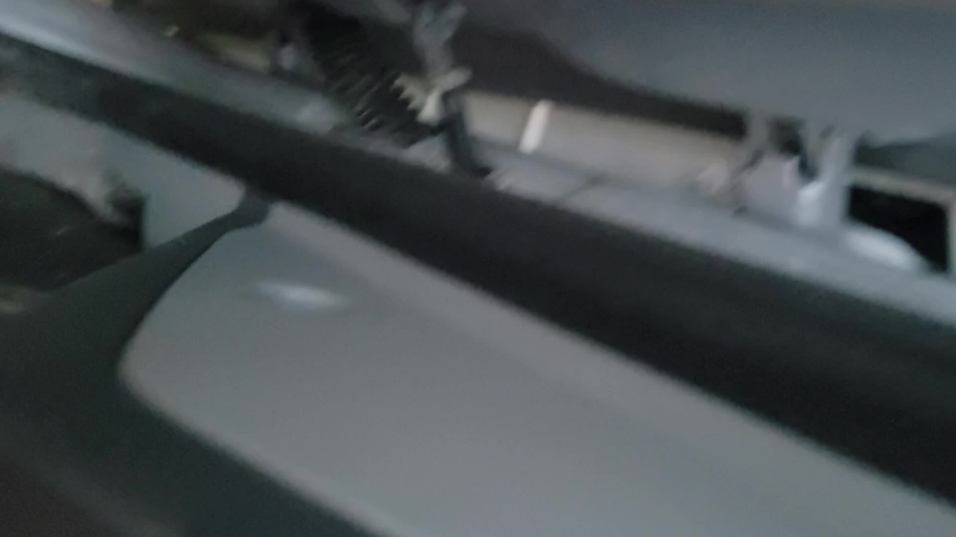

DANIELR
  • 26 POSTS

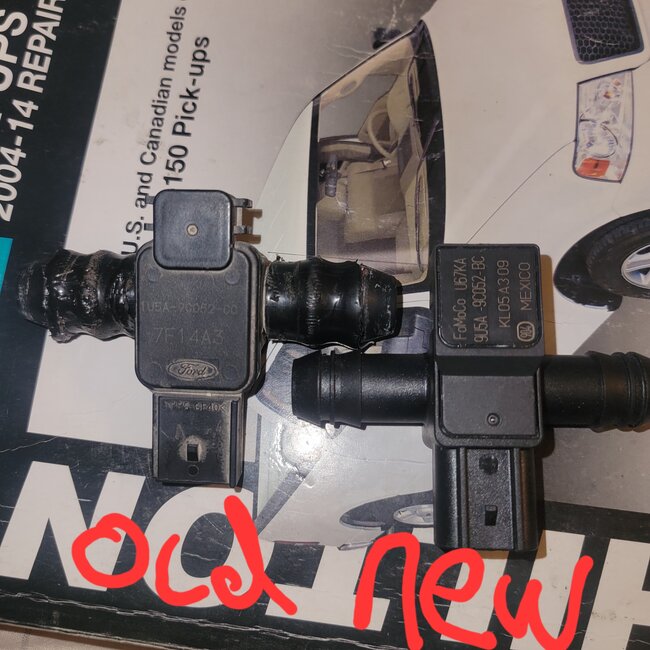

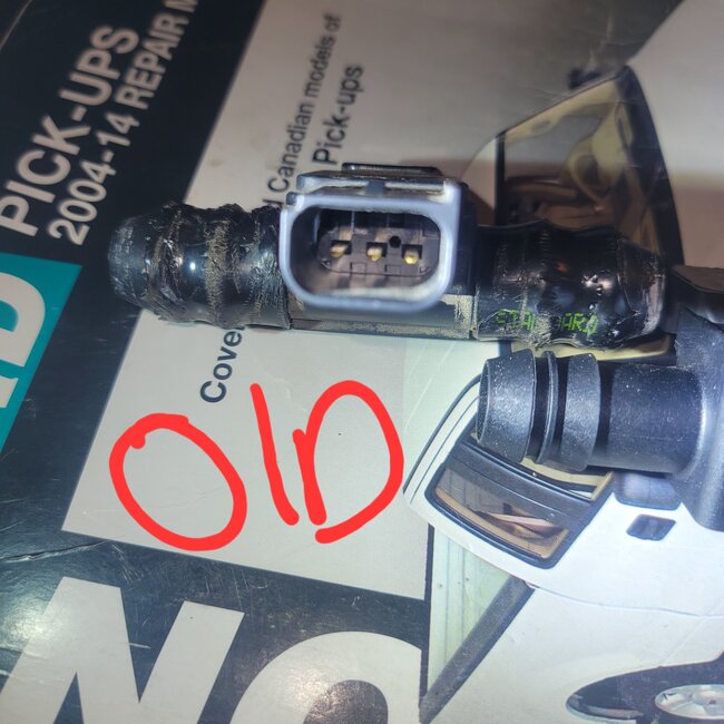

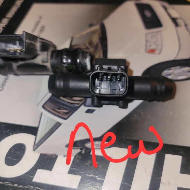

I dropped the tank and tried to replace the sensor. Auto zone Set a non-serviceable part O'reilly's can't find it at all.
And the one that I got off Amazon. I'll send you some pictures of right now. It's their the plugs different. Just a little bit like the nipples on the plastic piece. They're different spots on the old one in the new 1. So I could make it fit but I don't know if the wiring is going to be the same as hot ground negative. Or whatever and if u will notice the prongs are in different positions as well.
Thursday, September 12th, 2024 AT 11:27 AM
KEN L
  • MASTER CERTIFIED MECHANIC
  • 55,302 POSTS
That sensor is for the tank, the one you need is in the fuel rail, the fuel tank pressure sensor will not keep the engine from starting but the fuel rail sensor will.

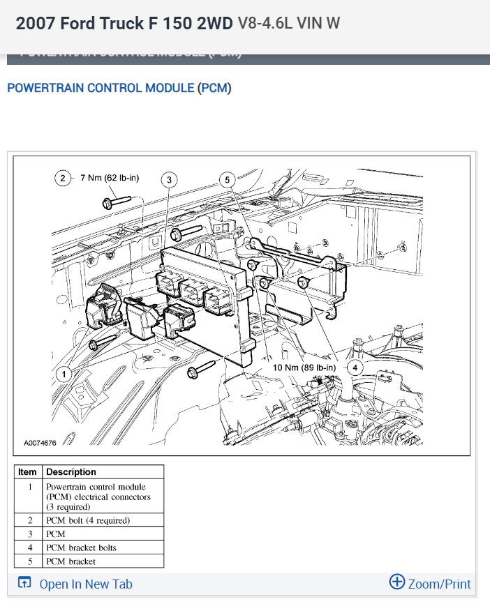

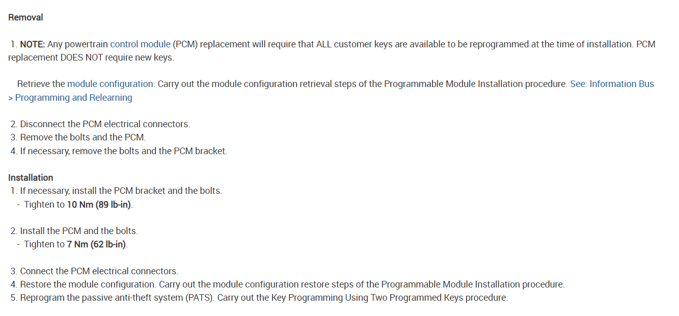

Yep, that is strange, I would remove the electrical connectors for the PCM and check for corrosion which can cause all kinds of strange problems. If everything looks okay I would get a rebuilt preprogrammed PCM by searching Google or Ebay. Here is the PCM location and how to change it out. Check out the images (below). Please let us know what happens.
Tuesday, September 17th, 2024 AT 9:36 AM
