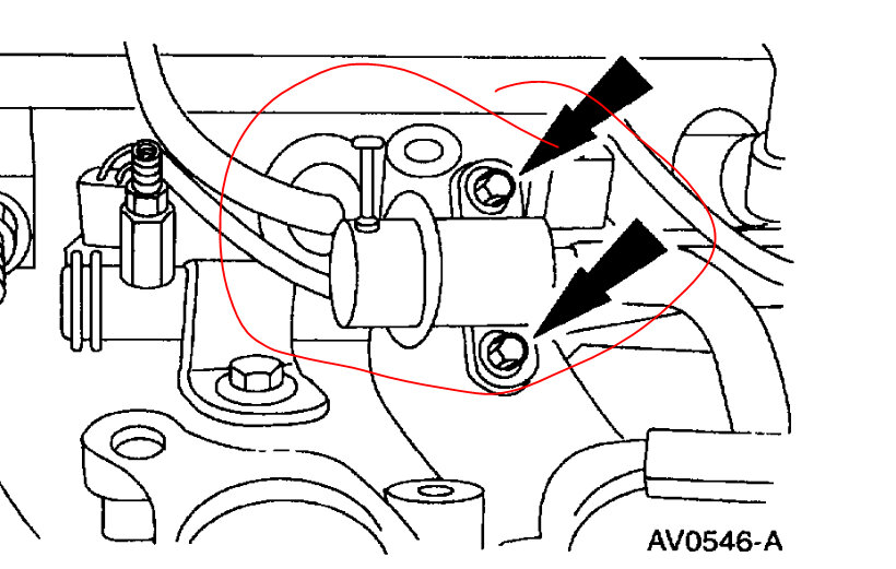

The line coming from the gas tank goes up the side of the fender. what is the valve the line hooks up too. It runs like it has a burnt valve and blows white smoke. it pushes too much gas into the intake.

I attached a pic below. I circled the fuel pulse damper. Is that the component you are referring to?
Next, if you are getting a lot of thick white smoke from the exhaust, that is usually an indication of coolant getting into the combustion chamber and being burned. Commonly, that is caused by a failing head gasket.
Take a look through this link and let me know if anything mirrors what you experience:
Let me know what you find or if I can help in any way.
