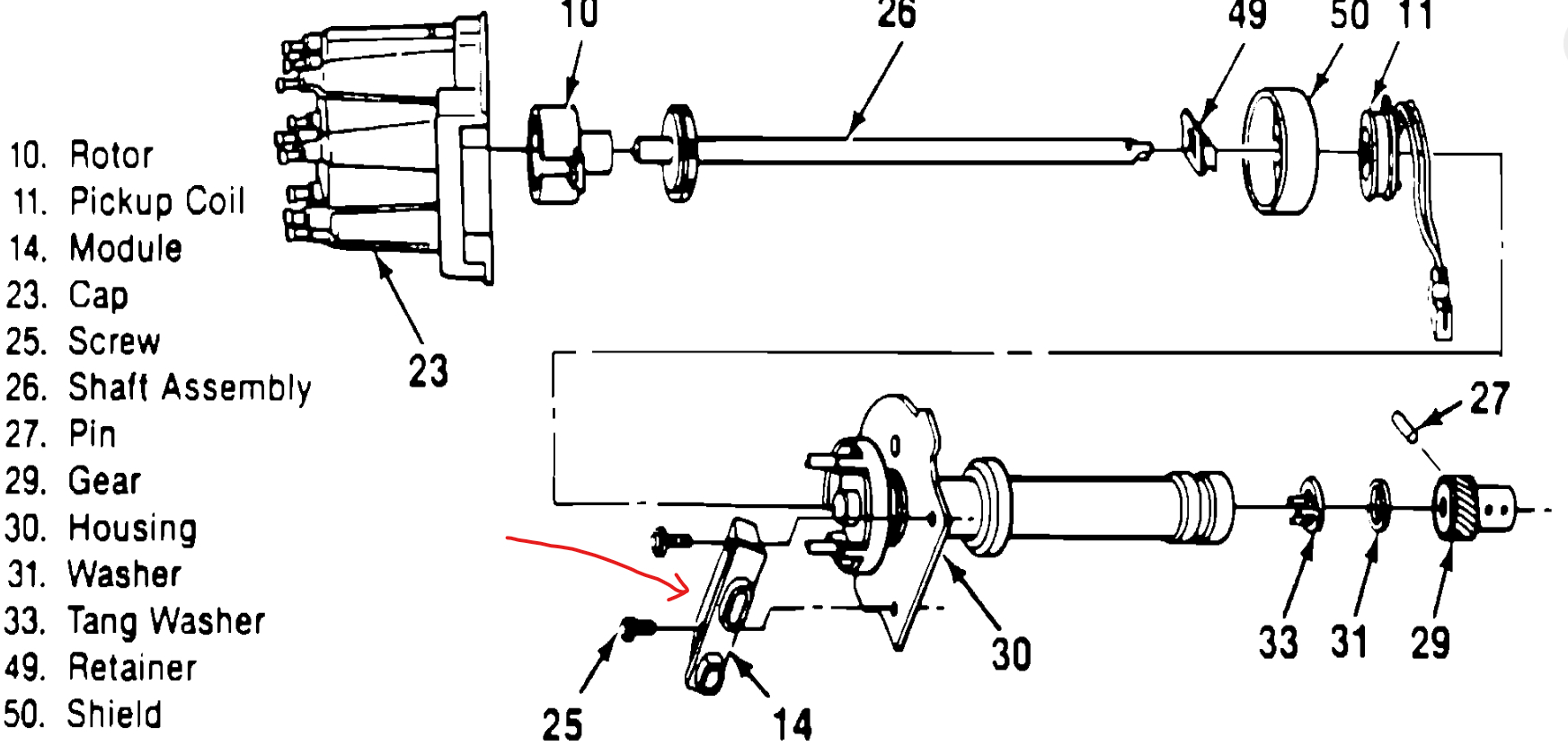

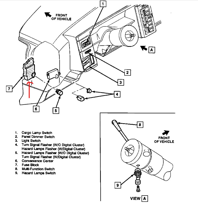

Replaced fuel relays and installed new fuel pump. With key on fuel pumps good, but when cranking motor all fuel stops.

This can be caused by the ignition module failing, I would see if there is spark. This video can show you how:
https://youtu.be/baq_aEWNQ0Y?si=9Ig8obOtUB0A4R3d
Also, check all fuses to see if any are blown, here are the locations and how to change out the ignition module in the images below in case you need it.
