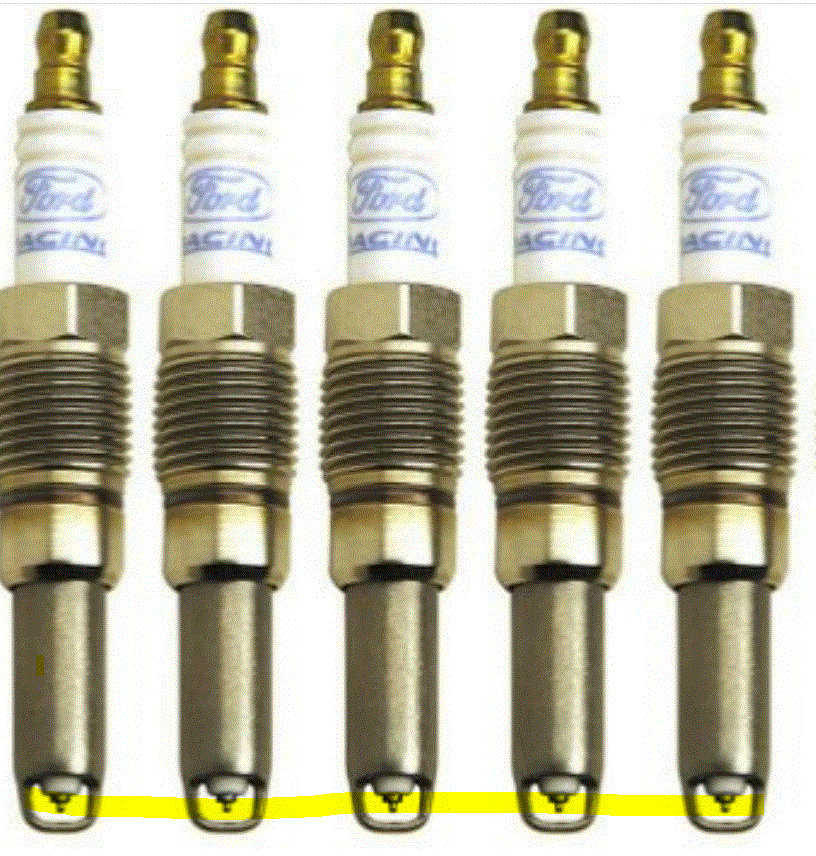

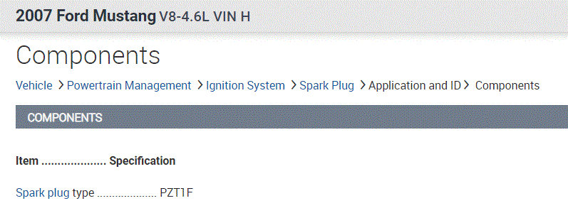

I think you're right. They look original. There is basically nothing left to the electrode. I looked in my manual and attached the plug specs below. Also, I found a pic of what the electrode should look like.
These aren't going to be cheap. If I had to guess, I would think they will be around 10.00 a plug or more. I could be wrong. Let me know what the part number is on the plug and if it matches pic 1 below. Pic 2 shows what they should look like.
This could have a lot to do with the issue you're having.

Yes, I thought they are bad, but again I have never seen spark plugs that look like this, with a looo Round it. I can get a discount from a local store with my account so that shouldn't be too bad. Just weird looking plug, if I remember correctly, it maybe is an Autocraft.

The plugs in your vehicle should be Motorcraft. That's what the book shows as OEM. The part number I sent also was from the manual, so it should be correct unless something was updated. Note: The plugs are a high-performance design for "racing." Since you are now part of our family, you're not allowed to race. We don't want to lose you. LOL Spoken like a true father. LOL
Regardless, I feel that even if the plugs don't take care of the problem (and I feel they should), they really need to be replaced.
Let me know how things work out for you. I'm interested in knowing if that takes care of the issue.

After changing the plugs with OEM Motorcraft, the difference is unreal! Thanks guys

The plugs you showed me have to be original. I've never seen a spark plug that worn out. LOL Now, the ignition can burn the fuel when you nail the throttle. That's what it needed. The poor thing was misfiring with all the fuel introduced.
