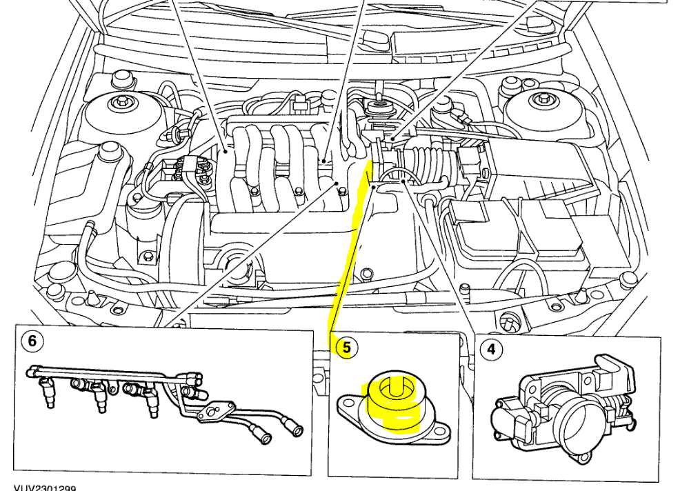

My car started accelerating weirdly, it would over accelerate and then under when trying to go fast. Eventually, this turned into stalling while idle for a few minutes after starting.
It "feels" like a bad fuel/air mixture, but I am pretty sure that's not it. That is just an easy way to explain how it feels.
A code comes up for a "fuel rail pressure sensor" but for the life of me, I can't find this on my car. I read that Cougars made before May 1999 don't have one.
Does anybody know where mine would be? If I don't have one, what I would have and where that would be?
Or if a bad EGR Vacuum Solenoid could throw a code for the rail sensor as a bad EGR Vacuum Solenoid seems to fit my symptoms exactly.

First, could you provide me with the code that was retrieved? I have several different possible causes of problems based on codes.

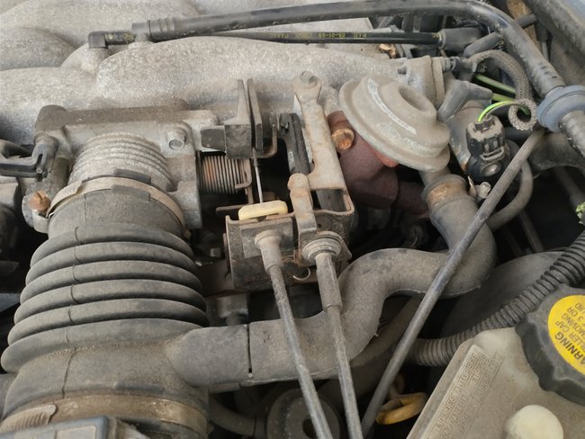

Now, take a look at pic 1. I highlighted the fuel pressure regulator. If I recall, this was used prior to the electric pressure sensor. See if this is on the fuel rail.
See pic below.

I looked in that area of the diagram you sent and found this. It looks kind of like what I think the new part looks like?
Friday, October 1st, 2021 AT 12:31 PM
  • 110,192 POSTS

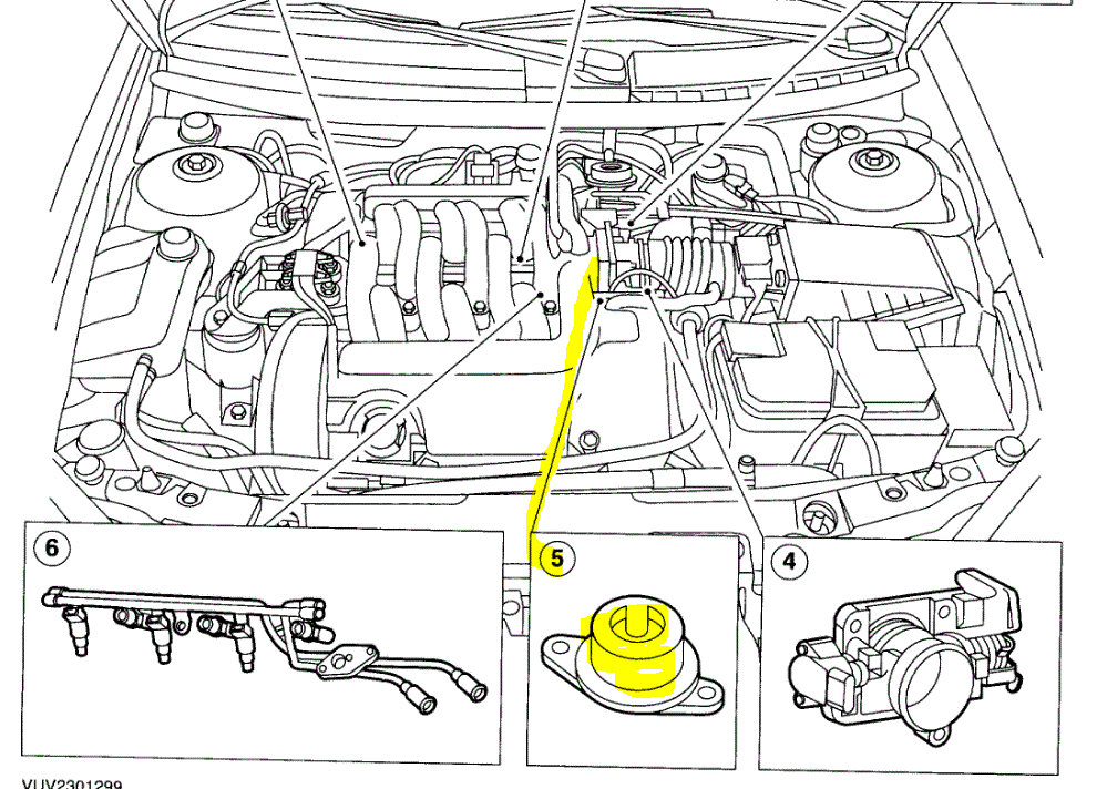

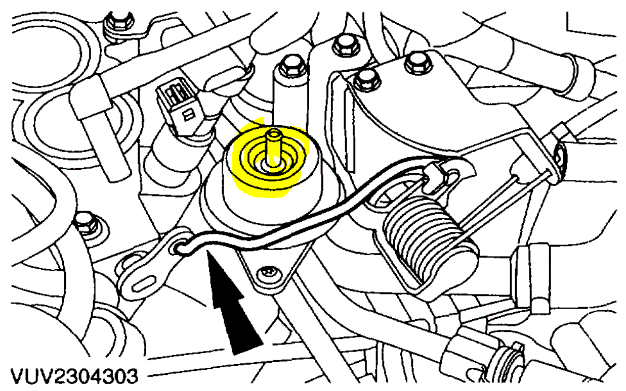

That looks like it's attached to the fuel rail. The regulator should be vacuum operated according to my manual. That has an electrical connector. If you look at pics 1 and 2 below, it shows the vacuum regulator location. If I recall, it will be partially under the upper intake manifold. See if it's there. If it isn't, then what you sent a pic of is either the fuel rail pressure sensor or fuel temperature sensor.

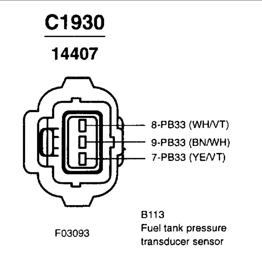

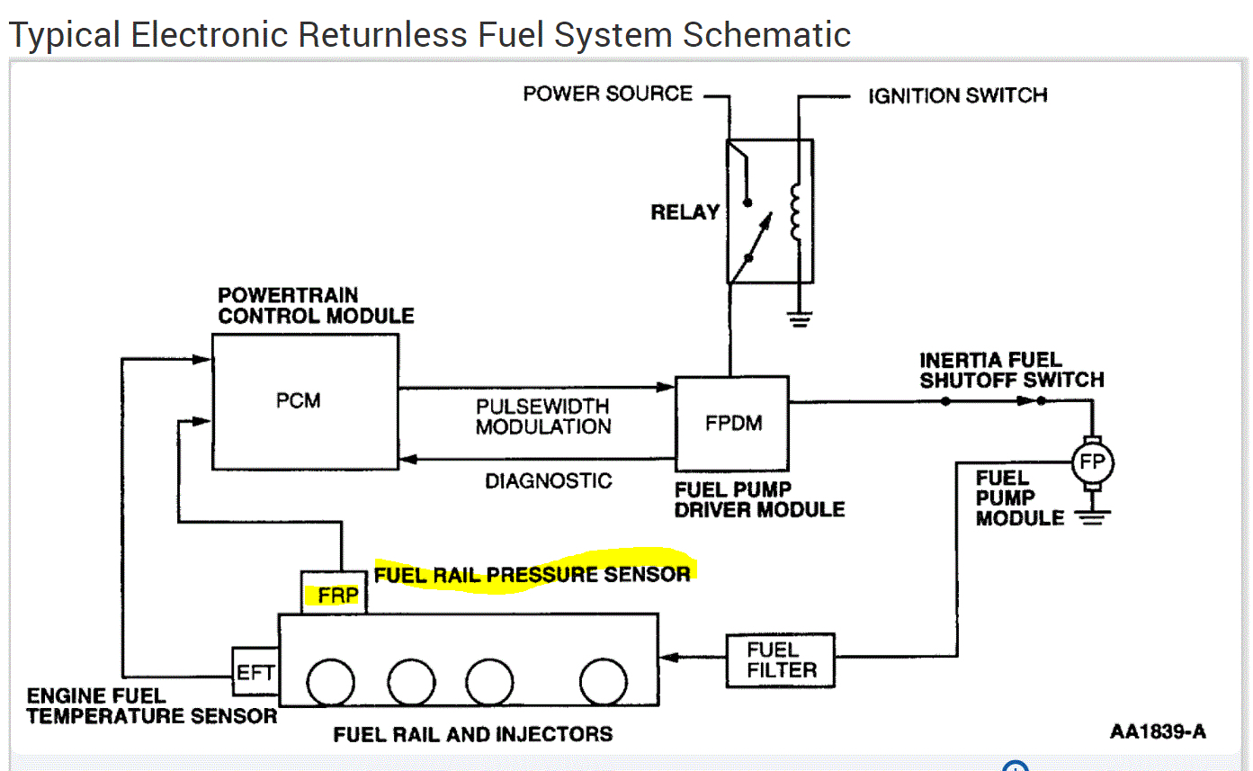

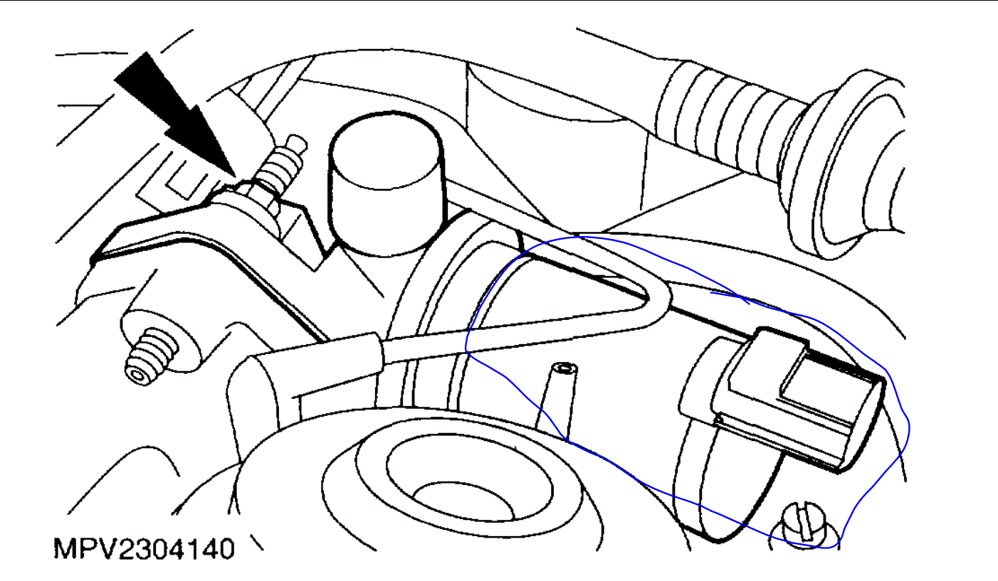

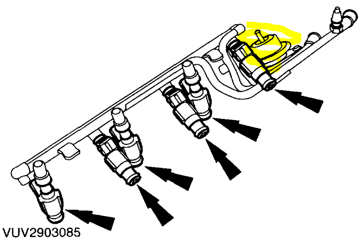

Pic 3 shows a schematic for the fuel system at the fuel rail. I highlighted the FRP sensor. Pic 4 is a pic from the schematic indicating the sensor will have three wires to it. The pic indicates wire colors as well, so we need to confirm they match.
Let me know what you find.

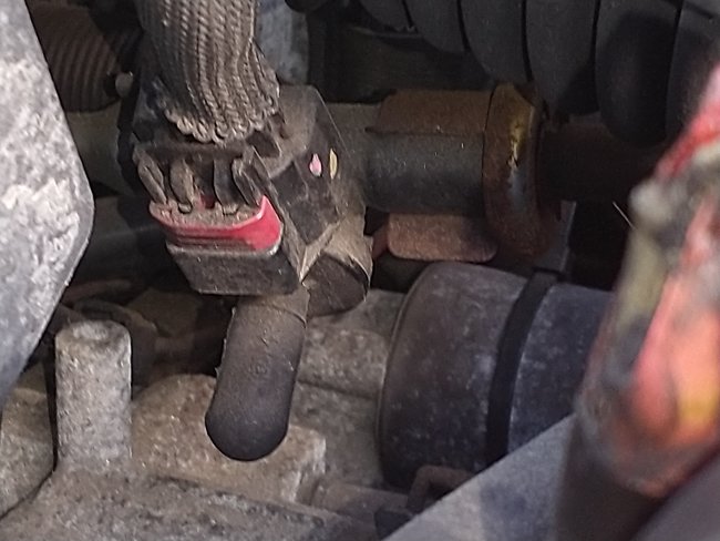

So here is my engine at that area in the diagram. I am unable to locate anything that looks like the right part here unless the diagram you gave is from under the engine looking up? The first picture I sent in the previous post does have a wire connected and is bolted with 2 small bolts to the engine and does have a small hose attached. That "nub" at the bottom is actually a small hose.

I feel like the part may be the first picture I sent you, although it is not in a very easy place to get at (under everything) so I am hoping it is not. It is in the area of the diagram you posted, just underneath everything.

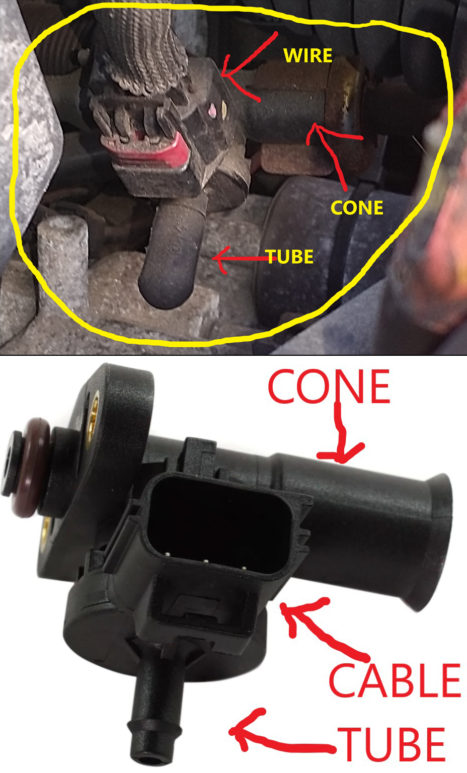

In my case this part looks like: https://www.carparts.com/details/Mercury/Cougar/Replacement/Fuel_Pressure_Sensor/1999/V6/6_Cyl_2-dot-5L/RM54360002.html
Called a "fuel injection pressure sensor". Would the code I am getting go with that part?

Looking at the pic, I'm not sure what you are referring to. The link you sent looks correct. The component will be connected to the fuel rail.
Could you circle the part you're referring to in the pic?

That is a tube even though in the photo it looks like a cap. It's just a 90-degree tube. And I have no idea what is connected to the "cone" part. Any "replace" videos I watched only had the 1 tube and the electric cable attached. But I could not find one for my vehicle.
Thursday, October 7th, 2021 AT 1:00 PM
  • 110,192 POSTS
The cable is for the wiring, the tube is a vacuum port, and the cone appears to be where the fuel line would attach. That is where the pressure is identified.

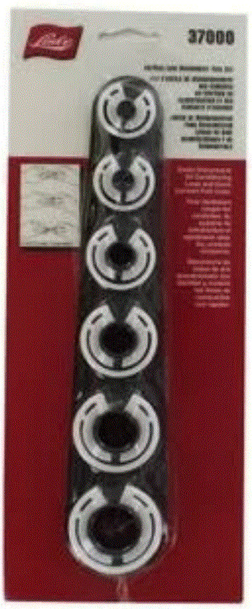

Yes, you do need a tool. When you look at where the line connects, there will first be a safety clip (usually metal) that you will remove by hand. Once that is removed, look closely where the two connect. You'll notice a spring going around the fitting.
At this point, select the correct size disconnect tool (same diameter as the spring). Next, push in on the fuel line, and using the tool, push the spring back at the same time you are gently removing the fuel line.
I attached an example of the tool below. You can get these at any parts store, and they aren't expensive.
Let me know if you have questions or if there is something I can do to help.
See pic below.

Have you removed the IAC to check for dirt, corrosion, or anything stuck to the panel? That can cause the idle issue you described.
See pic below for location. It's mounted on the throttle body.

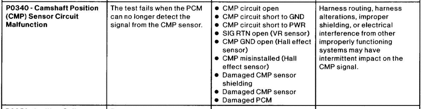

Sorry, I meant P0340.

The water could simply be condensation, especially if it is cold. The code makes sense to me now. LOL I attached a pic below which identifies possible causes.
That is the only code, correct? Also, could you record what it does and upload it for me to hear? If possible, do that for me. I will listen to it and share it with two other very good techs here and get their ideas as well.
