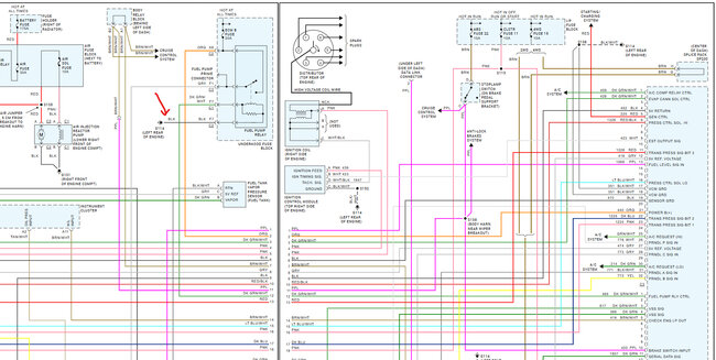

The fuel pump relay is controlled by the PCM which might be going bad. Do you have any trouble codes?
This guide can help:

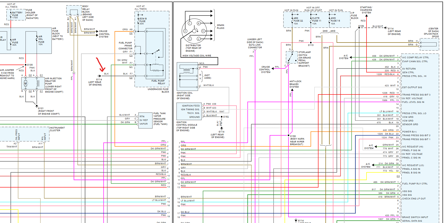

Also, when trying to start the engine do you have a security light flashing? Here is the wiring diagram for the fuel pump relay and PCM so you can see how the system works. I would also check the ground for the relay which is on the rear of the engine block which I have marked on the diagram as well. Check out the images (below). Please upload pictures or videos in your response of any problems so we can see what to help you with.

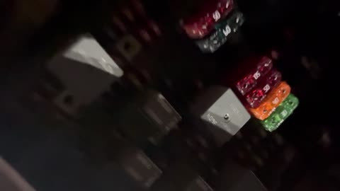

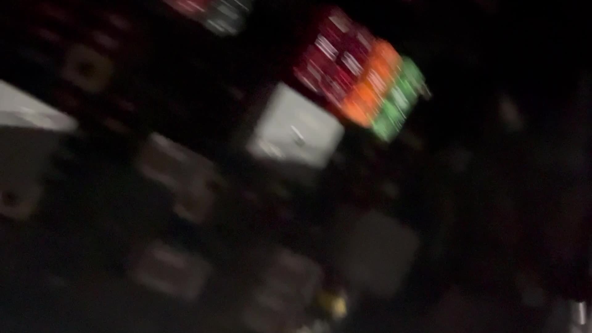

This is what it does.
Mar 3, 2025 at 2:53 PM
  • 54,503 POSTS

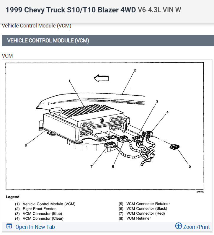

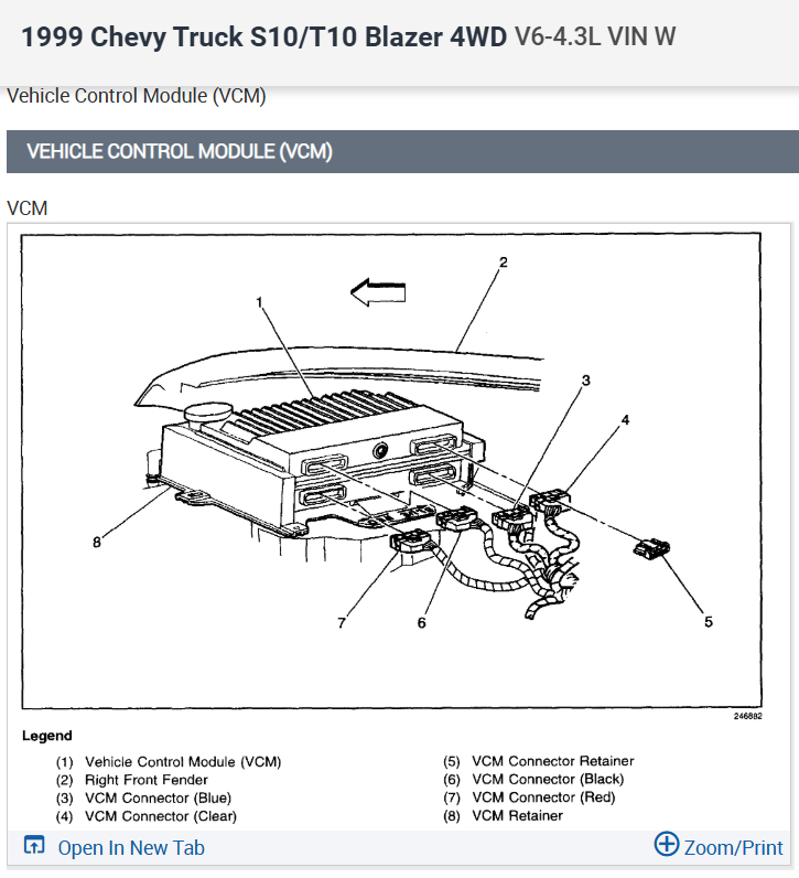

Thanks for the video. Is the ticking duration the same each time? If so, it looks like the PCM needs to be replaced. Here is how, you can get a preprogrammed unit by searching Google or Ebay. I would also check the grounds from the battery to the engine and chassis/body.
