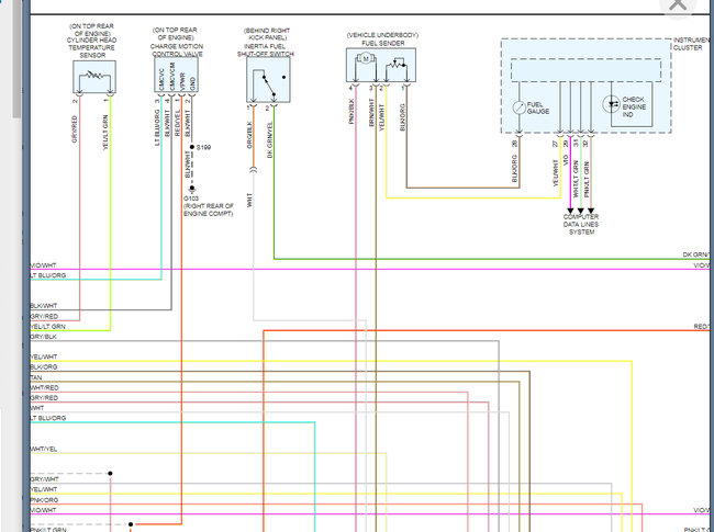

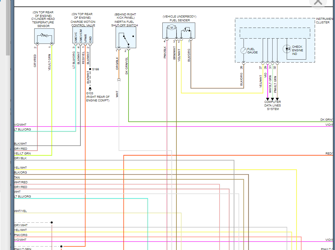

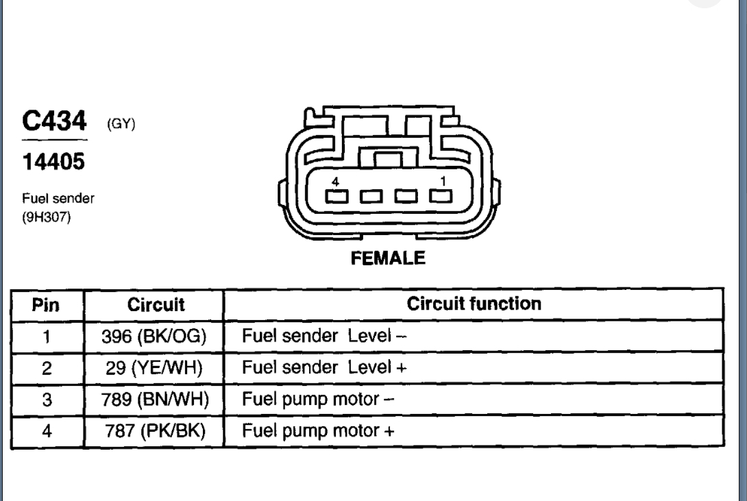

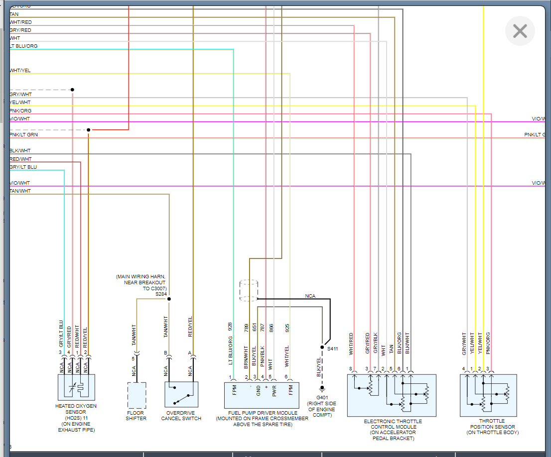

Hi, i need the wiring color codes for the plug going to the fuel pump please. While changing the fuel pump I tore the wires out of the plug that goes into the fuel pump. bought a new plug but can't remember what wires goes where. TIA
Aug 13, 2021 at 2:46 PM
  • CAR REPAIR CONTRIBUTOR
I am attaching not only the wiring diagram but also the connector view as I suspect this is what you will really need as it includes the wire colors and position in the connector.
