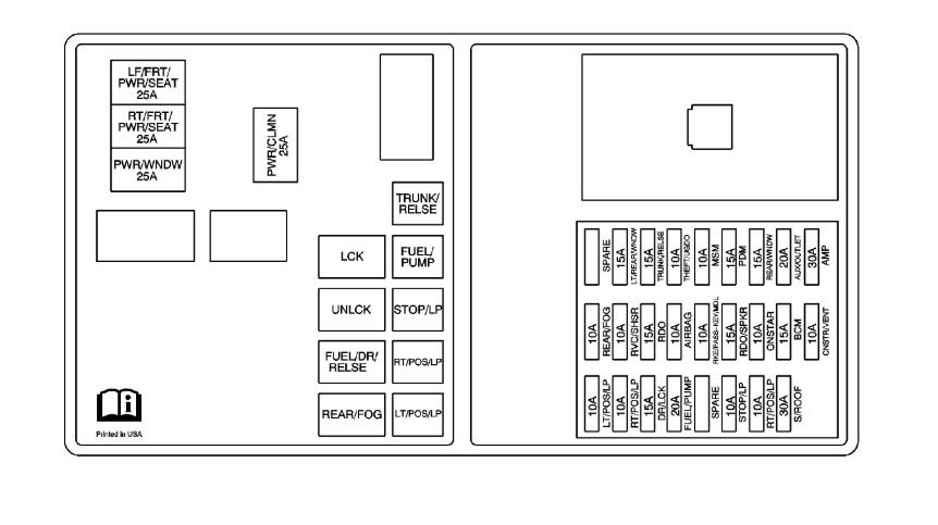

Good afternoon.
The relay is in the fuse center. I attached a picture for you to view and they are marked.

Hi. My diagram does not have a fuel pump relay mark on it. Trying to send an image of diagram.

I sent a picture of fuse box diagram.

Sent a picture.

I have no fuse box under the seat. The one under the hood has no relay for fuel pump.

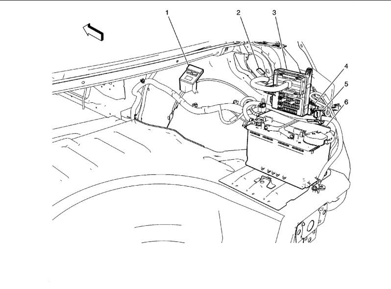

This fuse box is in the trunk.
+1
Monday, November 5th, 2018 AT 7:54 AM
COLLET WILLIAMS
  • 10 POSTS
2010 Cadillac CTS.
Monday, November 5th, 2018 AT 7:56 AM

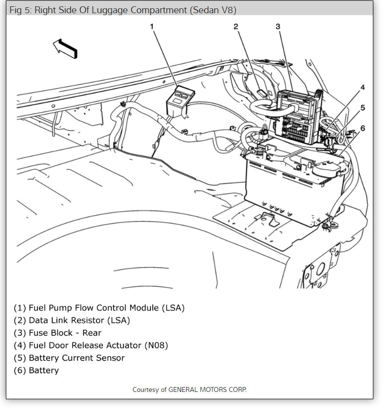

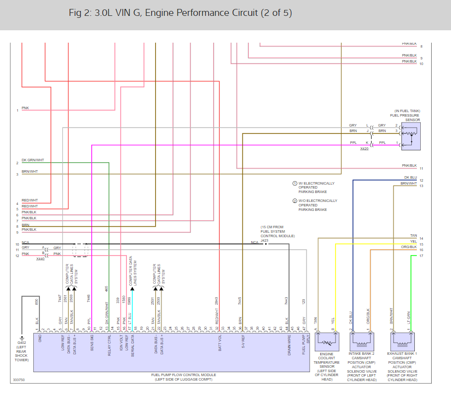

In the trunk.
1 - Fuel Pump Flow Control Module (LSA)
2 - Data Link Resistor (LSA)
3 - Fuse Block - Rear
4 - Fuel Door Release Actuator (N08)
5 - Battery Current Sensor
6 - Battery
Monday, November 5th, 2018 AT 7:57 AM

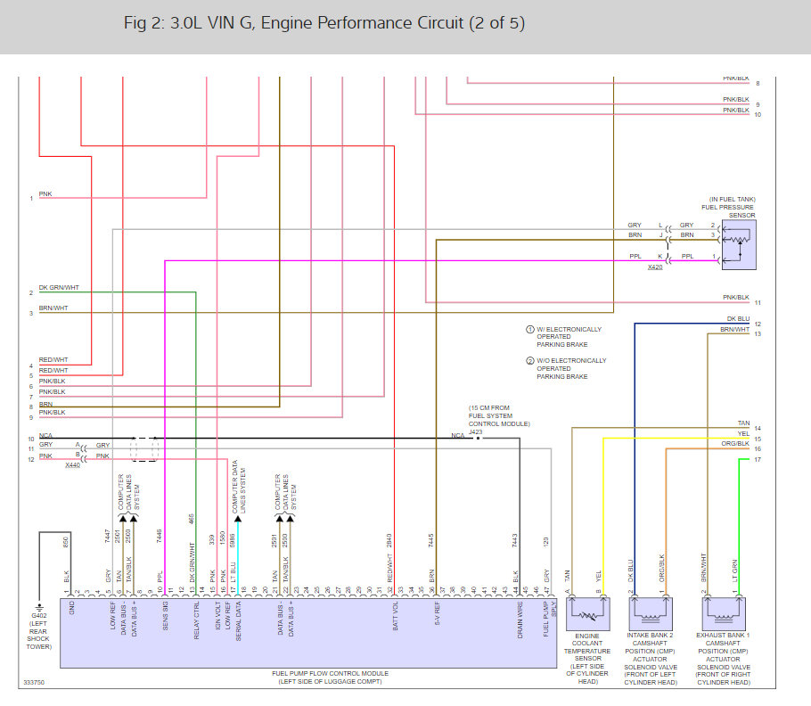

Yes, I am not hearing my fuel pump engage. So I was trying to check fuel pump relay. Got codes P062B, P1682, P069E, and P0231.
Monday, November 5th, 2018 AT 8:03 AM
COLLET WILLIAMS
  • 10 POSTS
I do not see fuel pump relay.
KEN L
  • MASTER CERTIFIED MECHANIC
  • 55,383 POSTS

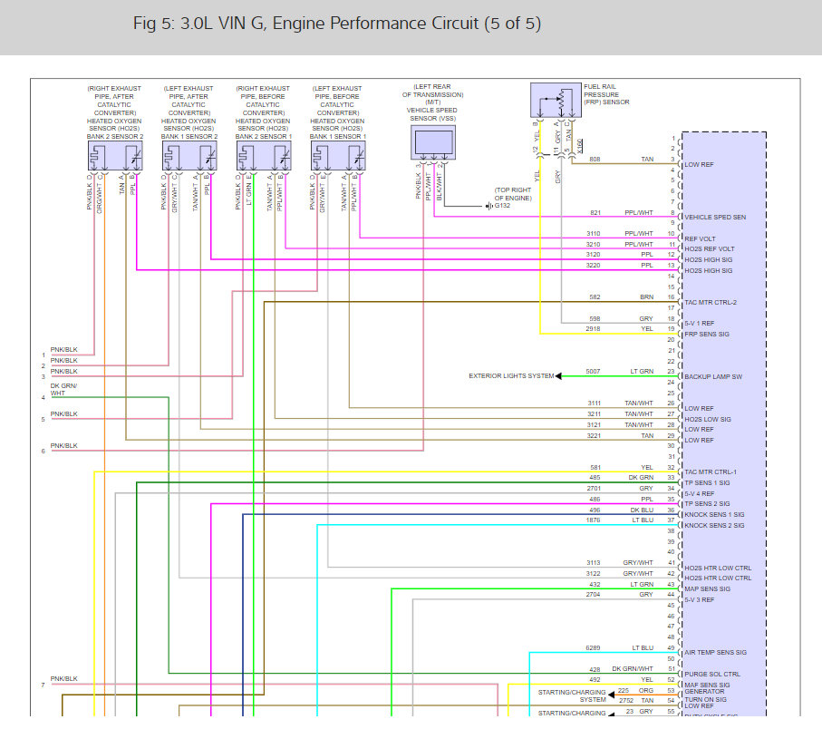

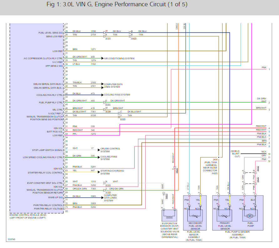

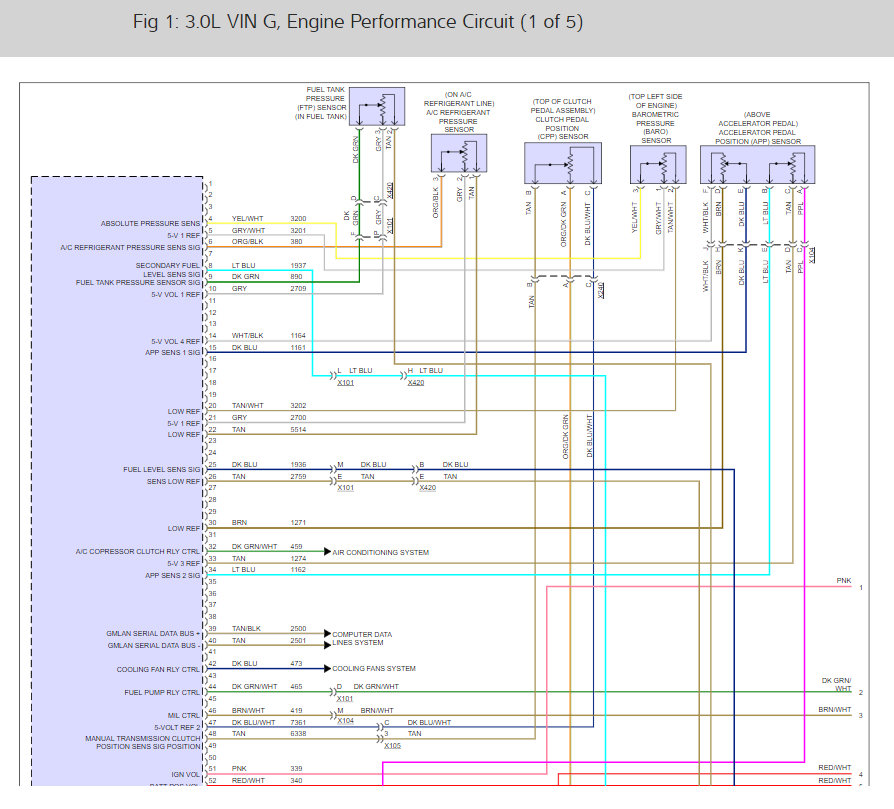

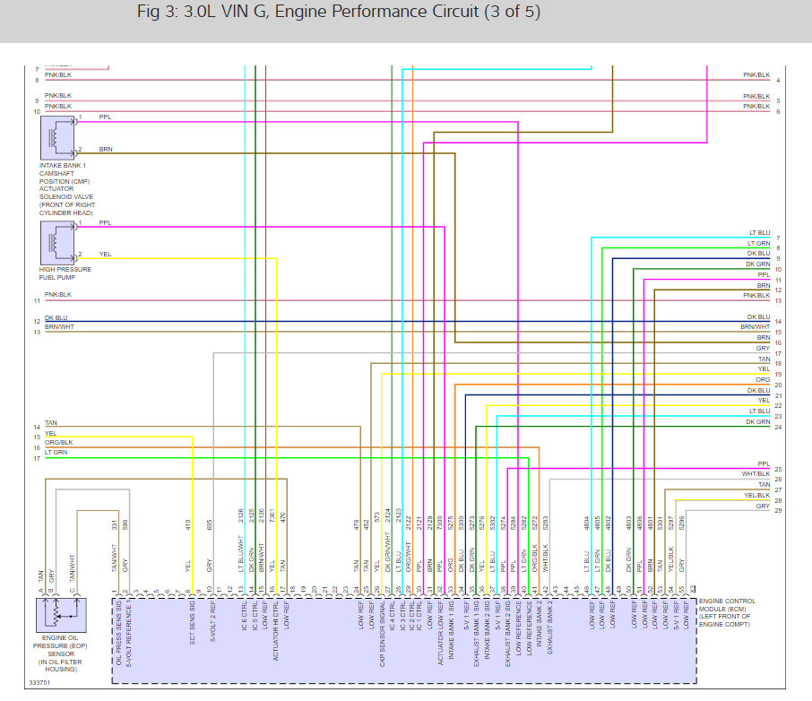

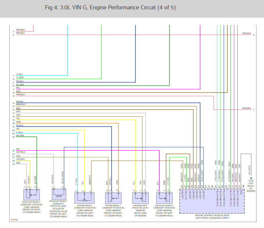

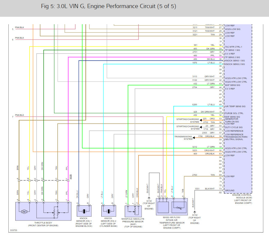

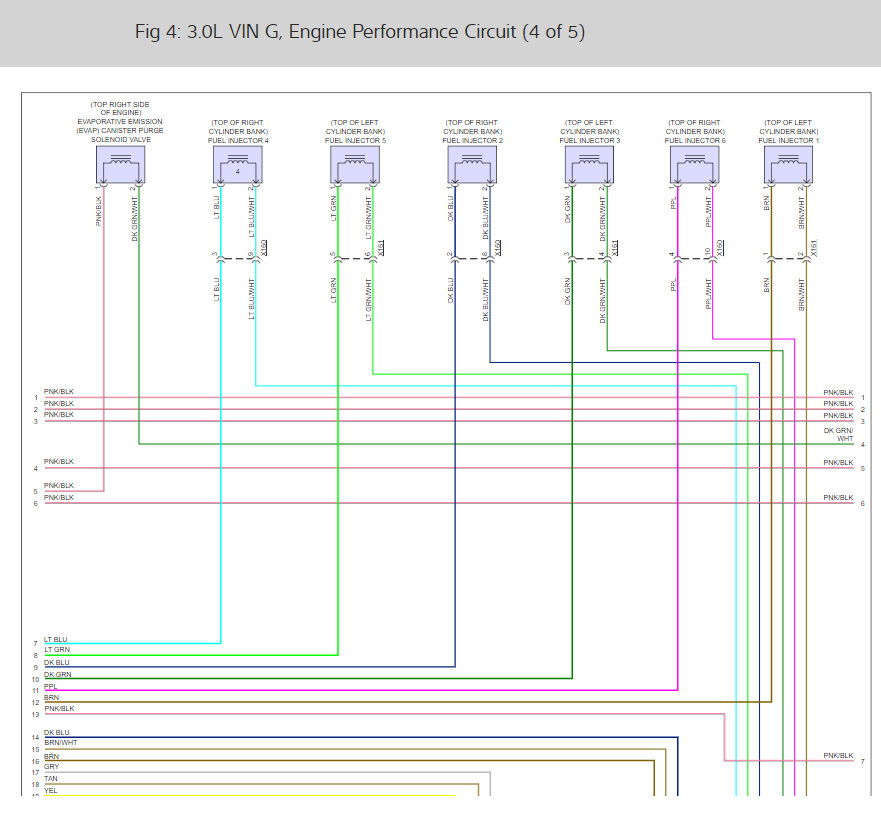

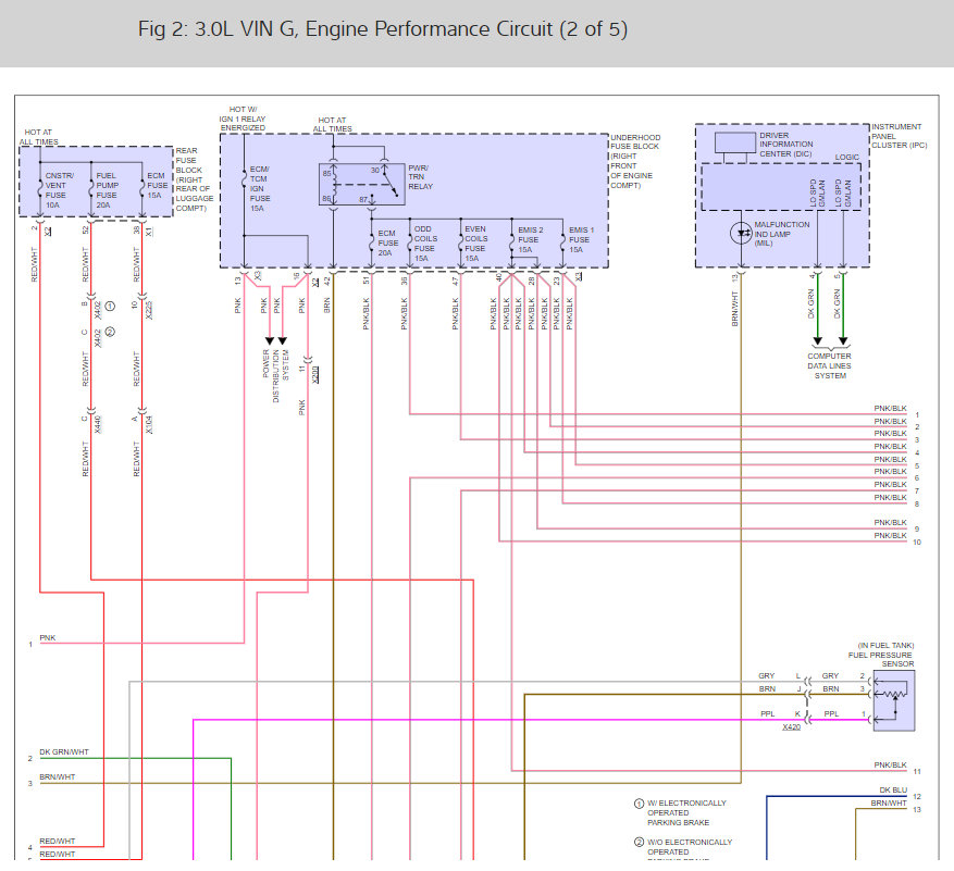

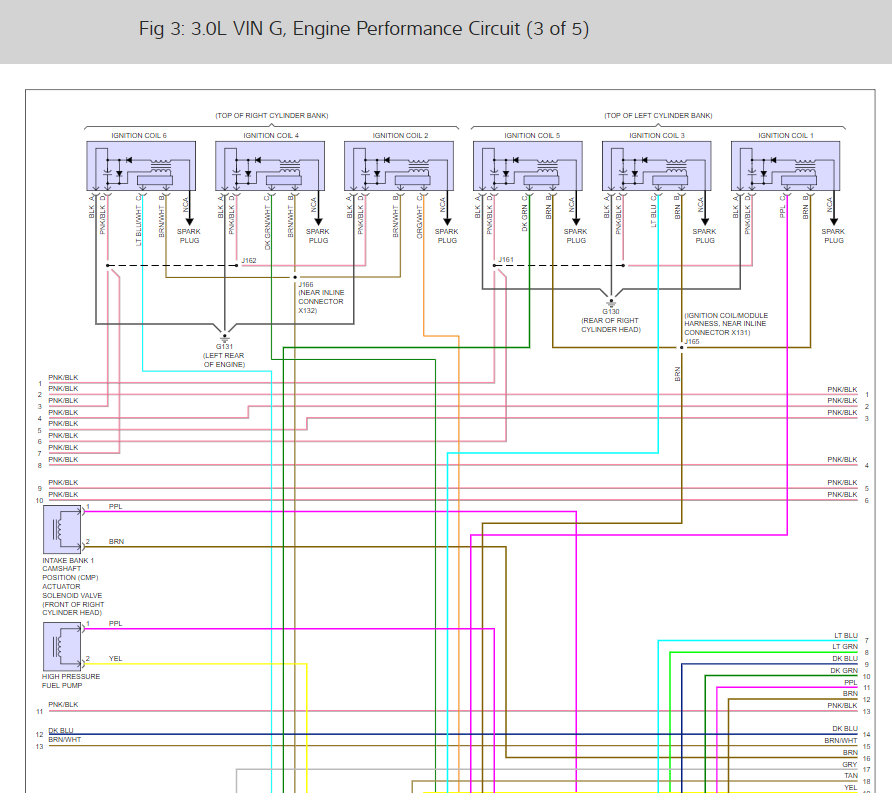

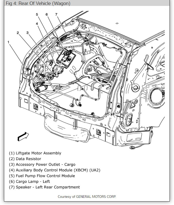

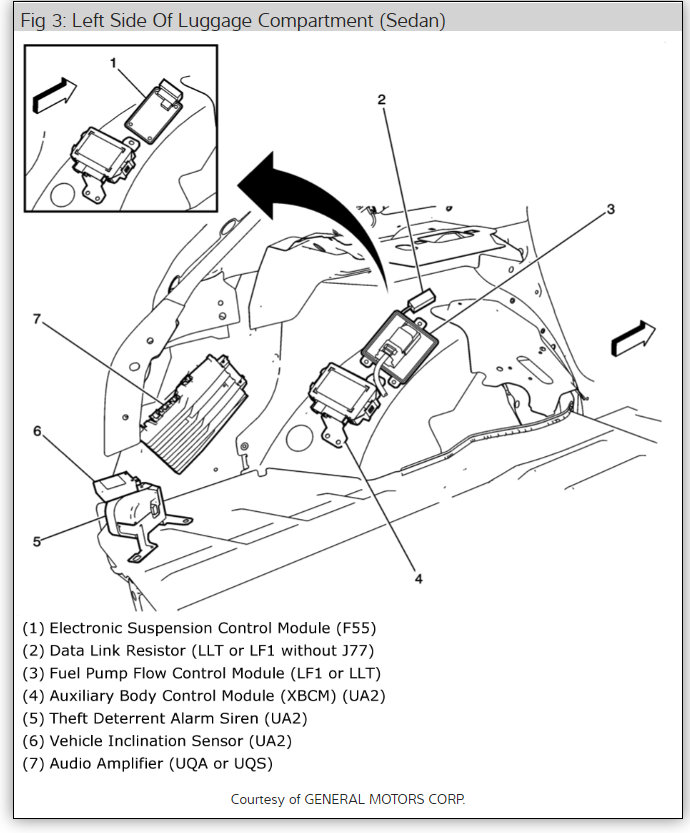

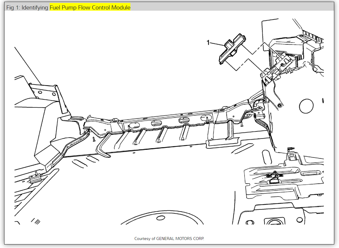

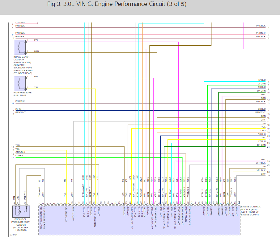

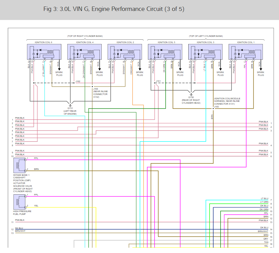

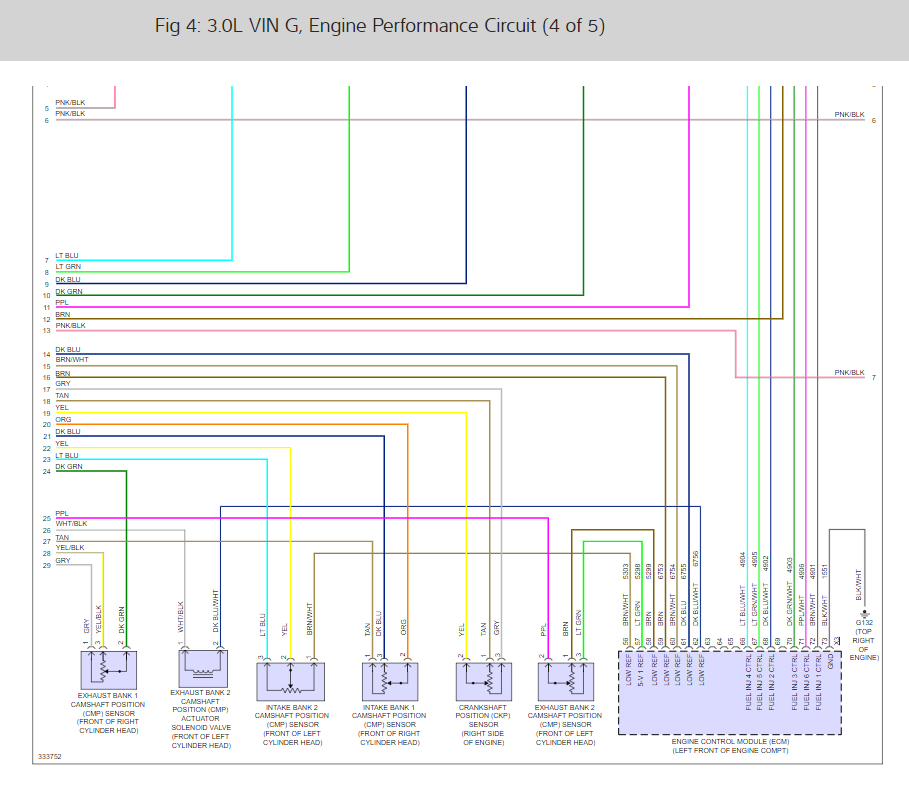

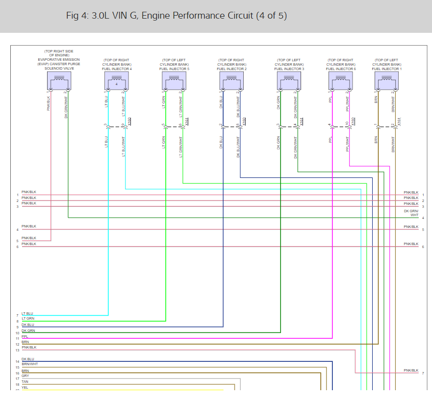

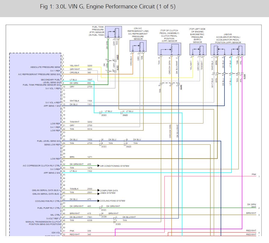

There is no fuel pump relay only the control module. Here are the engine and fuel pump wiring diagrams so you can see how the system works.
Here is a guide so you can check for power to the pump to see if the pump is bad. Use the wiring diagrams below:
There are different locations for the fuel pump module here are all options.

The 62 code is the key. You have a failed PCM and it needs to be replaced. That looks like it has set all the other codes as well.
