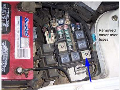

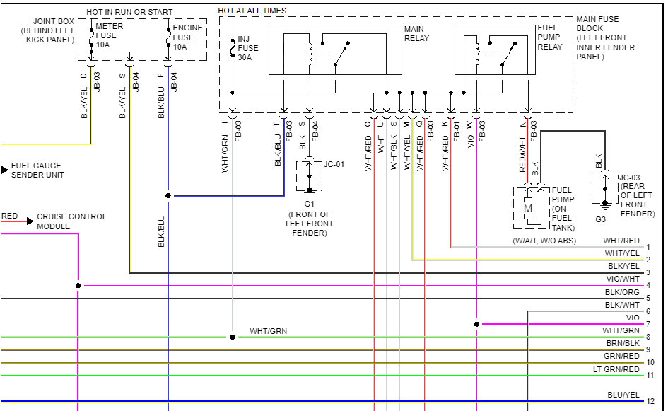

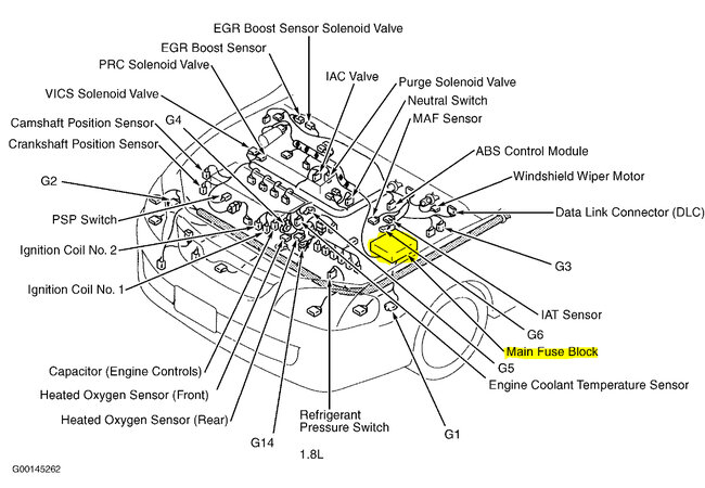

I can’t figure out where the location for the fuel pump relay is.

The fuel pump relay is located in the main engine fuse block, just ahead of the driver's side front strut tower, next to battery. See images below.

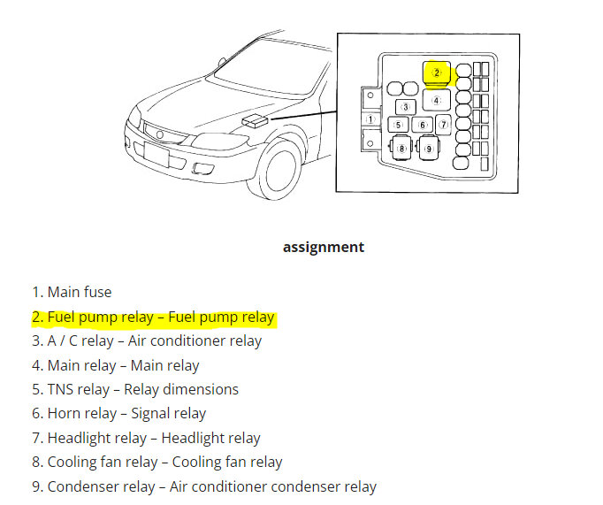

So, I know that the fuel pump relay is in the main fuse box under the hood, but my question is, what relay is it?

It is the topmost relay, see image below.
