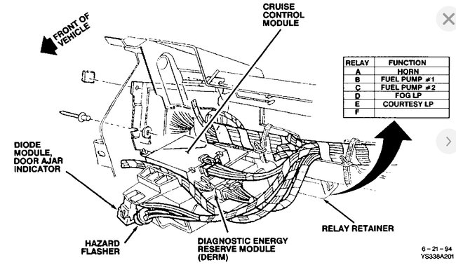

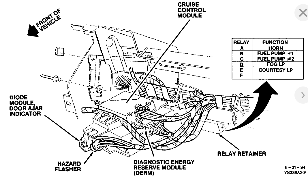

I can't find anyone who knows where the fuel pump relay is located. Called my local Chevrolet dealer, Eklers, etc.

Here is a tutorial showing how to test a relay:
It's located behind the right hand side of the instrument panel. I've attached a picture below.Hope this helps and thanks for using 2CarPros.
