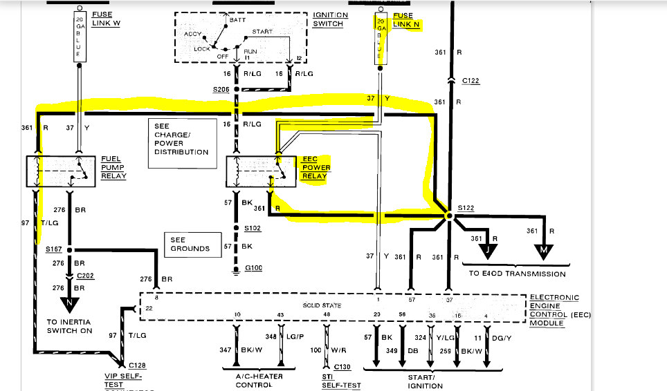

Had a mechanic install a new fuel pump and rear gas tank in my truck. Had low voltage to the pump, figured that out (fusible link issue). Along the way to diagnosing that issue managed to knock out the ignition (turn the key on but no lights, no juice to the starter). Figured that out. Now engine turns over and have fuel pressure at the rail but seems the injectors are not opening. He believes it may be another electrical issue. He needs a better schematic to find the connection between the ignition and the injectors.
NOTE: prior to the fuel pump going out the truck ran fine. The battery is fully charged and there's plenty of fuel in the tank and the fuel selector switch is working properly.
Anybody else ever run into this scenario before? Thanks a 3/4 ton for any helpful advice.

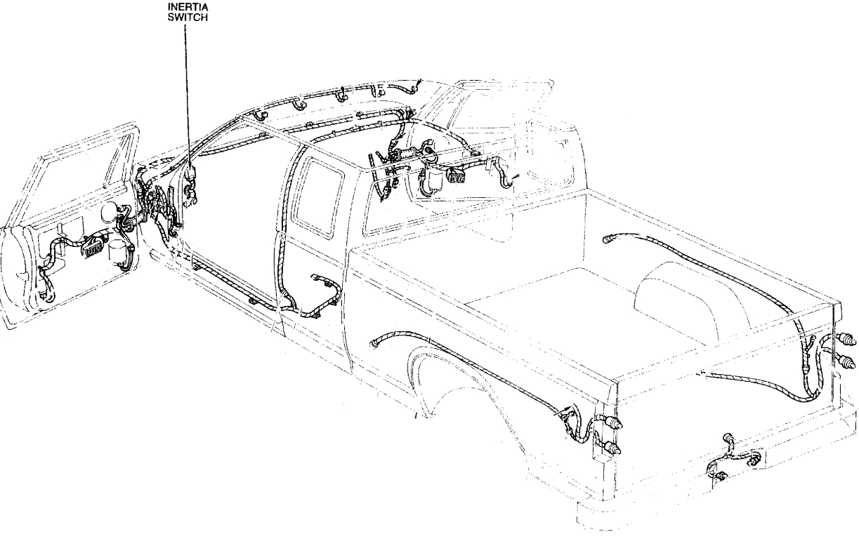

I attached the wiring schematic I have, below. As far as this issue is concerned, these don't all happen by replacing the pump. Do you hear the pump operate when you first turn on the key? I ask because the fuel pump relay gets power from the same location as the injectors.
Let me know. Based on everything you mentioned, we may have an issue or a damaged ECM. To me, it sounds like something was shorted and caused a few different failures.
Let me know if the pic helps.

Thanks for getting back to me so quickly. The schematic helps. New info: I erred when I stated that the fuel pump was working when the key was on. Apparently he (my mechanic) had already run a bypass wire from some other source of power located behind the kick panel on the passenger side directly to the fuel pump wiring. That's when he determined that the pump was working. He now needs to make power to the pump and injectors from the ignition. Does that make any sense? I hope I described the problem adequately.

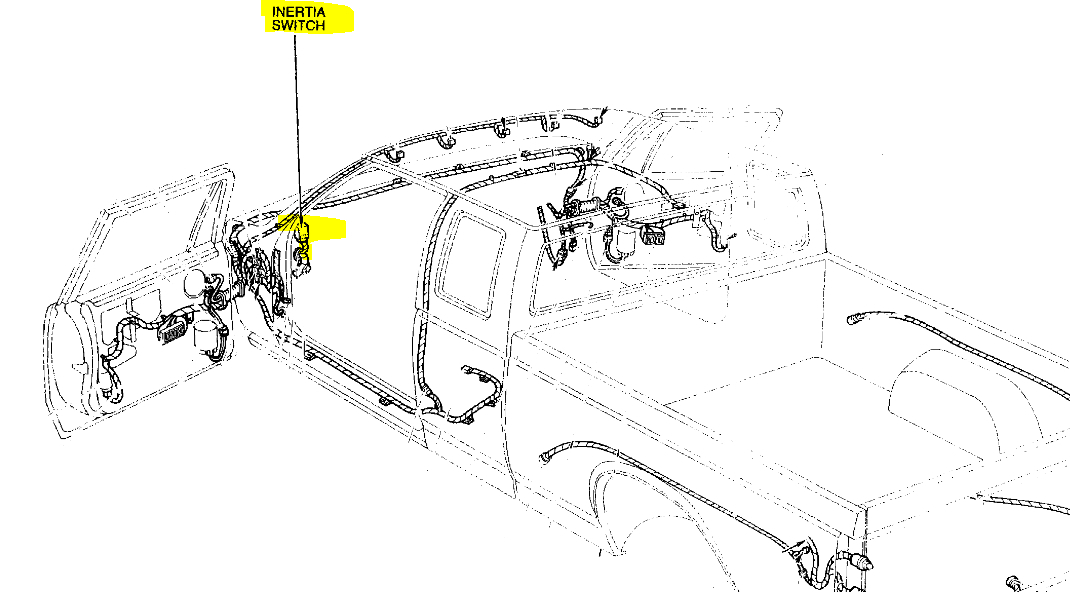

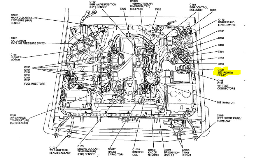

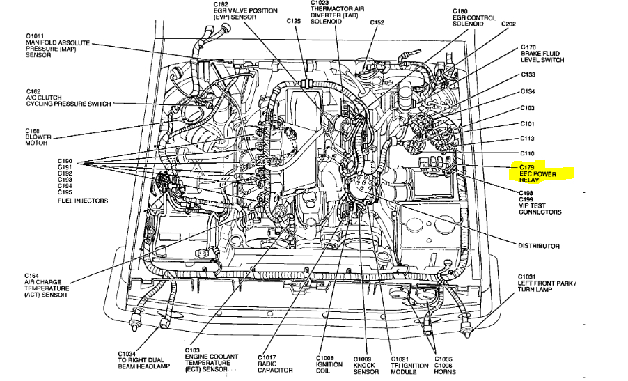

Yes, that does make sense. However, before we jump the gun, tell him to switch the EEC relay with a different one having the same part number. If this relay fails, you will lose spark and fuel.
I attached a pic below showing its location. Also, have him check to see if there is spark to the plugs. If there is no spark, this is my first suspect. If there is spark, see if the inertia switch needs reset. See pic 2.

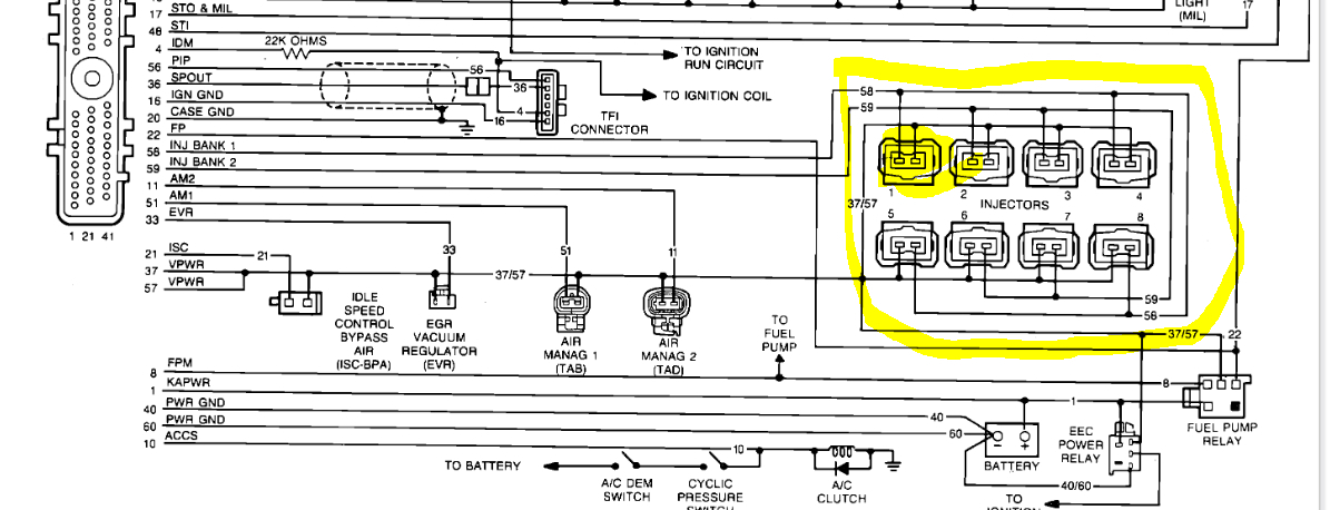

I noted that there are fusible links that may have failed as well. See pic 3. He can remove the fuel pump or eec relays and check if there is power to them as well. If there is, have him also check if the inertia switch has power. In pic 3, I highlighted how the primary side of the fuel pump relay gets power from the EEC.

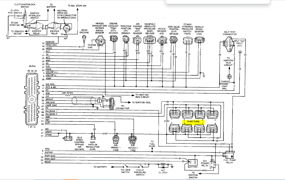

I finally got a chance to get back to work on the old Ford f250. I got the fuel pump and tank back in the truck, fresh battery, 5 gallons of gas. I hear the pump running, have excellent pressure at the fuel rail, have good spark to the plugs. But nothing is combusting. Is it possible that the injectors are not opening?

Because of the model year, the schematics I have aren't very clear. However, each injector will have two wires. With the key in the run position, check to see if one of the two has power. Use a simple test light.
See pic below.

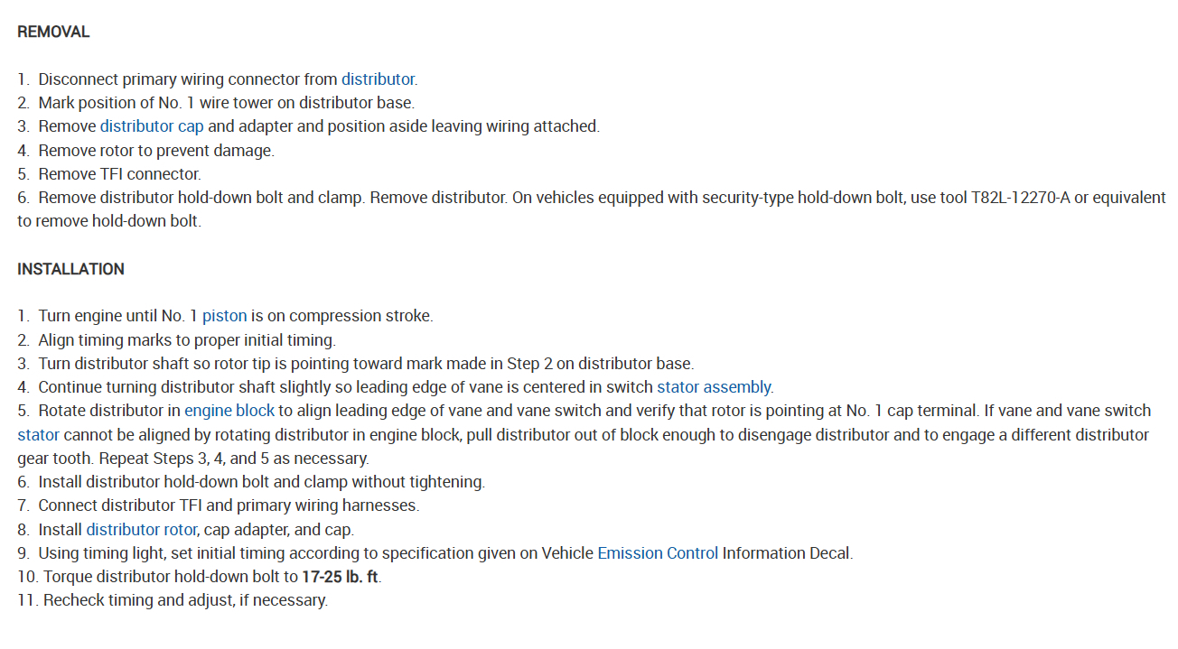

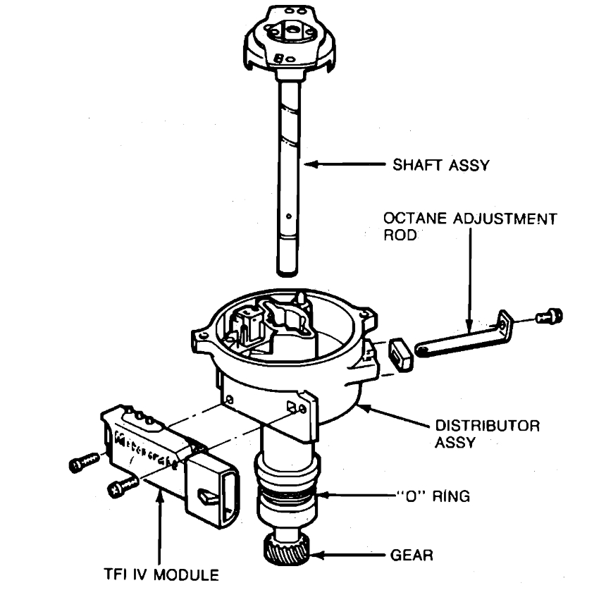

Either the module is defective, or the ignition timing is off which can be due to a bad roll pin at the distributor gear. Here are the instructions on how to install the distributor and module correctly. Also, did you try resetting the inertia switch, push down on the button on top?
Sunday, February 23rd, 2025 AT 10:08 AM
ATOMICDR
  • 49 POSTS
I did check that inertia switch and it was fine. I went ahead and just swapped out that new ignition control module with my old one and once again the engine starts right up with a quick spray. So much for quality parts these days. Now on to finding the true source of the problems.

I have seen the ignition coil be bad and overload the ignition module FYI. So, I would change them both, also use spark plug and wires should help as well.
