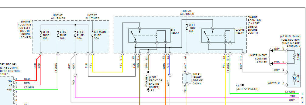

What all can cause fuel pump not to hum when turn key on?
Apr 24, 2026 at 4:50 PM
  • 54,487 POSTS
Sure, it can be the pump is burned out or the C/opn relay is not working or the MAIN EFI fuse is blown which is in the fuse panel on the left side of the engine compartment. The fuel pump can have a bad ground as well which is at the left C pillar. Here is the wiring diagrams for the system so you can see how it works. Check out the images (below). Let us know what you find.

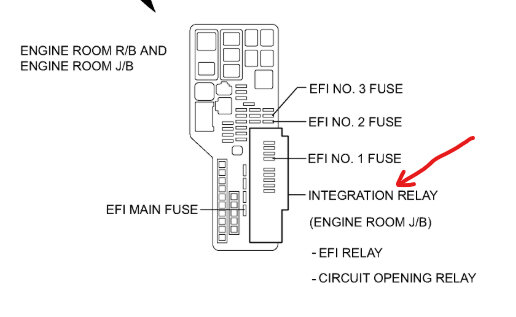

the pump hum when i jump wire it. where is the C/opn relay and the MAIN EFI fuse located?
Apr 25, 2026 at 9:33 AM
  • 54,487 POSTS
The fuse is in the under the hood fuse panel. The fuel pump relay is part of the integration relay. Check out the images (below). Please let us know what happens.

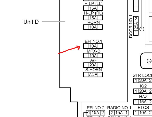

why the INJ fuse keep blowing and how do I find the problem? I done replace the fuse 3 time. no spark no fuel pump sound when turn key on no start. I use my test light to check for a short at the fuse box inside the car I hook the clip end to battery positive and the pointed end to one side of the fuse box socket with key off.
Jun 21, 2026 at 12:54 AM (Merged)
  • 54,487 POSTS
So this happens when one of the injectors is shorting out. I would remove them and run this test from this guide.

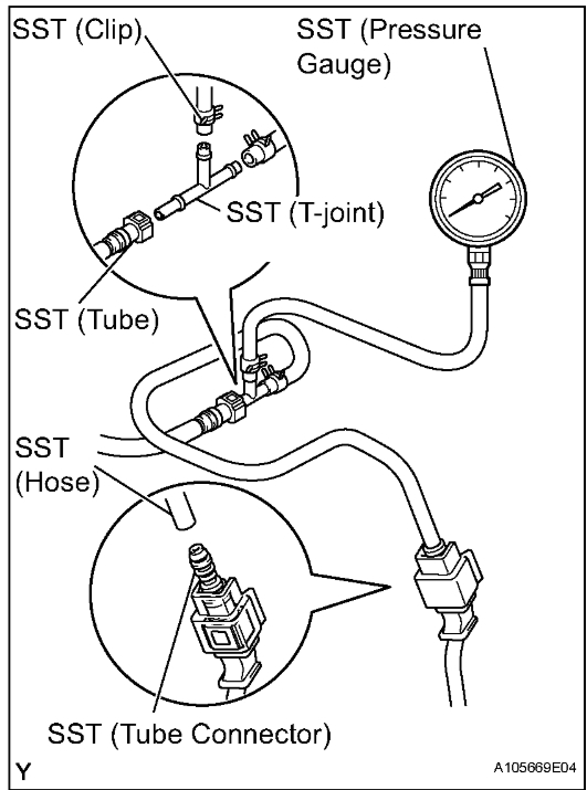

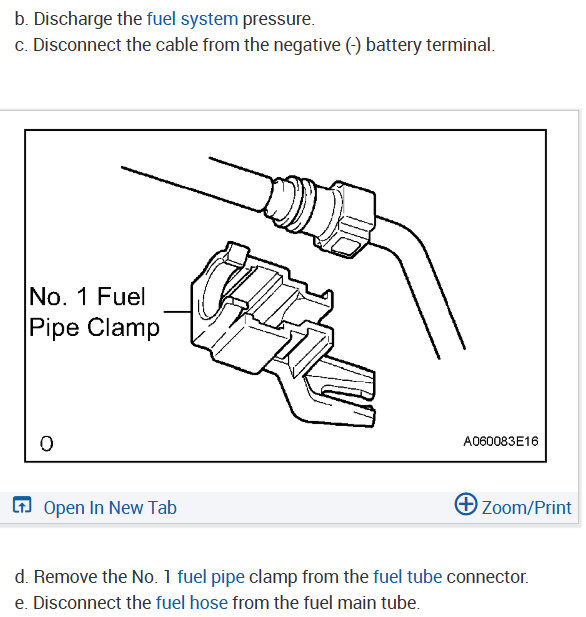

what is the fuel pressure psi number is? i check the fuel pressure while cranking the numbber was 34psi. when engine running the number is 44psi is those in normal range?
Jun 21, 2026 at 12:55 AM (Merged)
  • 54,487 POSTS
Normal fuel pressure is about 44 to 50 PSI with the engine running. Toyota’s 2AZ-FE fuel spec is listed at 304–343 kPa, which converts to about 44–50 PSI. Here is a video to go over to help with instructions in the diagrams below for your car.
https://www.youtube.com/watch?v=kgEixCsqcYM
Are you still fighting the #3 and 4 cylinder misfire? Please upload a short video in your response of the problem, so I can see what's going on. Check out the images (below). Let me know how it goes
