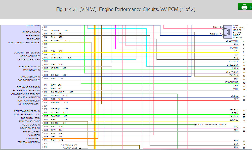

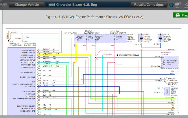

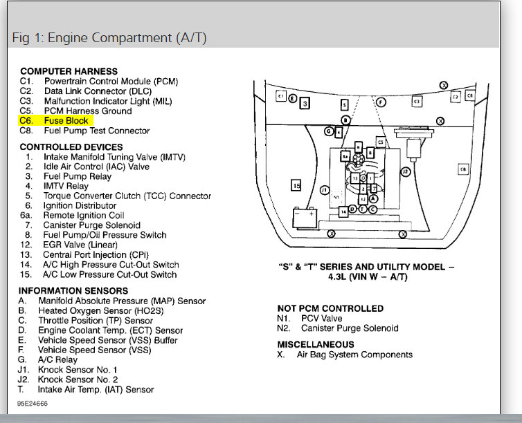

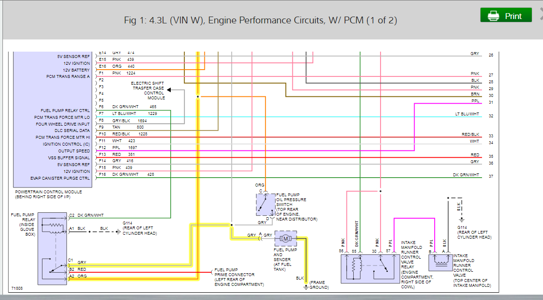

Check the ground to the fuel pump and also check the amperage of the fuse to the fuel pump circuit. If the ground to the fuel pump has a lot of excessive resistance to it will not allow the current to return to the battery, heating the wires up to the point of melting them. The fuse protecting this circuit might be too high of an amperage fuse and not blowing like it should. Think of electricity like water, they flow and work very similarly. If you had water in a pool (battery) and it was flowing to a water wheel to turn it (fuel pump) through a pipe(wire) and the return pipe(ground/vehicle body to battery -) was blocked not allowing the water to return to the pond, but the water kept coming from the pond, do you think that return pipe would be under pressure? Would the water wheel eventually stop turning? I have included wiring diagrams for the fuel pump in the diagrams down below with the part of the fuel pump circuit we are concerned with high lighted.
Please check this out and get back to us with what you are able to find out please.

Okay, with the van running can you test the black from the connector to the ground where it connects to the body. Test in VDC, please, as before and get back to us with that reading to please. This is what is known as a voltage drop test and it will tell us if there excessive resistance in the ground wire.

Okay, there's your problem. The ground wire or the ground connection to the frame is bad. You should have no more than 0.1 volts in any segment of the circuit. The goal of any circuit is to dump all available voltage across the load, which in this circuit is the fuel pump, but because of corrosion, broken wire, bad connector, you are dumping 3.21 volts across the ground wire because of the resistance in this segment of the circuit. Replace the connector a new one and run a new ground wire and make sure the connection to the frame is clean, tight, and metal to metal and you should be back on the road worry free.
