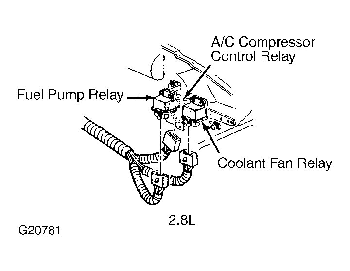

I have a z28 IROC. It will not start or run without fuel being squirted into throttle body. Where is the fuel relay?

Hi and thanks for using 2CarPros. Com.
The fuel pump relay is located on the upper left side of the firewall under the hood. I have attached a picture for you to help locate it.
Let me know if this is what you needed or if you have other questions.
Image (Click to make bigger)
