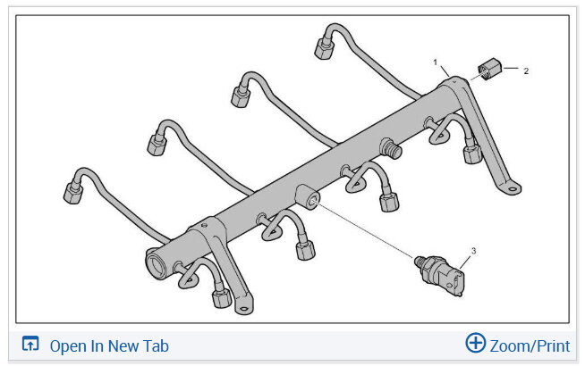

Failing High-Pressure Fuel Sensor (MOST COMMON)
The sensor at the end of the fuel rail sticks or reads incorrectly during cold start.
So I would replace the sensor which should fix the problem, did you notice the camshaft lobe when you had the pump off? Here is the location of the sensor and I will email it to you as well. Check out the images (below). Please let us know what happens.
Nov 13, 2025 at 10:55 AM
GF
Thanks Ken, I replaced the high pressure sensor back in May. I suspect the replacement was faulty though but only realising this now. I have the old one off the car but can't see anywhere online on how to test its resistsnce (if thats how you test it) put ohms meter accross all 3 pins in every variation but get no reading on my multimeter. i have raised a warranty replacement that should arrive next week. Will let you know how i get on. I have had that inlet manifold off and on about 3 times now lol! thanks again for all you help. i feel a fix is near!
Nov 13, 2025 at 11:02 AM
  • 54,494 POSTS
Yep, you are on the trial, it will be difficult to test the sensor unless you test it in operation since that is when it fails, unless it has an open circuit which most do not. I would get a new part because the old one sounds defective. Please let me know.
