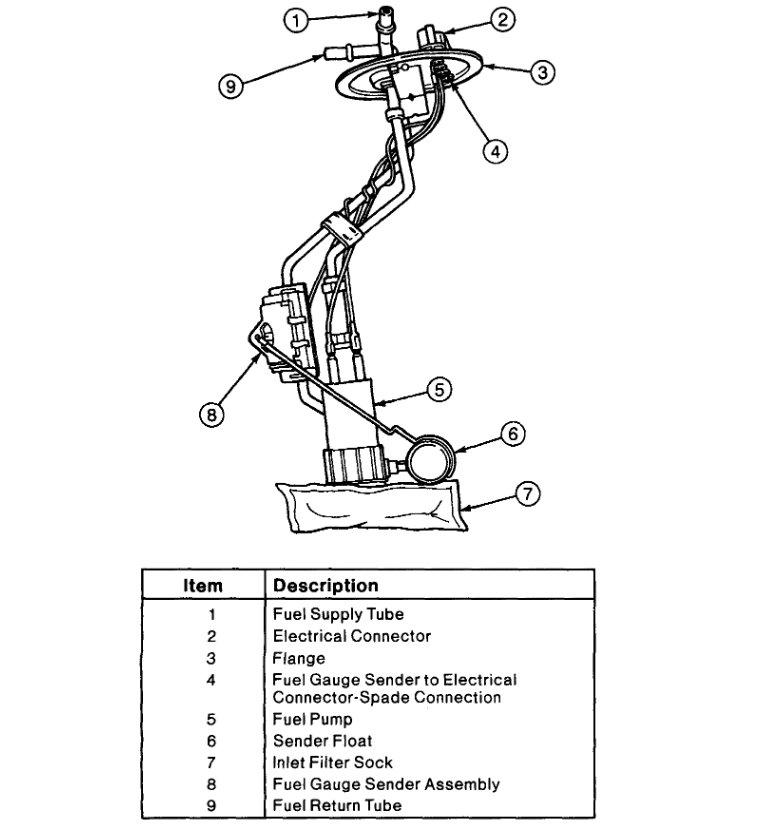

I did the press check. Results. Koeo jumps to 10 PSI, drops to 0, idle with vacuum on 30, without vacuum 36. It looks like I need a new pump, filter or regulator or a combination of all three. What do you think? Again, thanks a million for all your help. Youu guys are awesome.

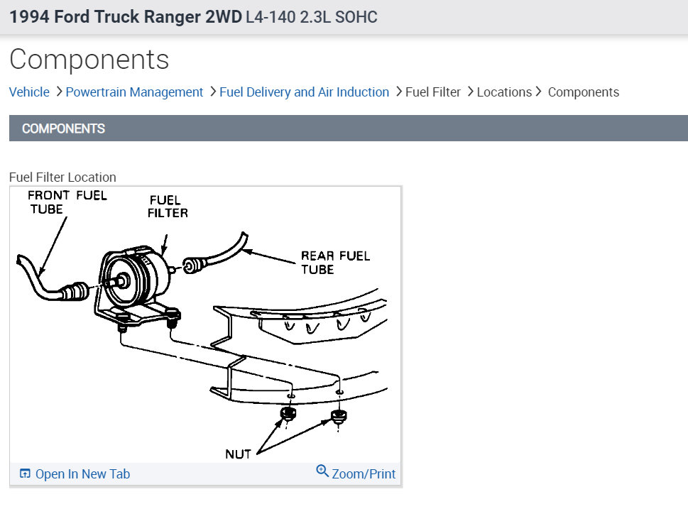

I would do the filter first. here are the instructions on how and a video to show you how to get the lines off of the filter:
https://youtu.be/Boi0DPXVHbM
REMOVAL
CAUTION: If the fuel filter is being serviced with the rear of the truck higher than the front, or if the tank is pressurized, fuel leakage or siphoning from the tank fuel lines could occur. To prevent this condition, maintain the vehicle front end at or above the level of the rear of vehicle. Also, relieve tank pressure by loosening the fuel fill cap. Cap should be retightened after the pressure is relieved. If the vehicle is warm, change the fuel filter before the pressure rebuilds.
1. Shut engine Off. De-pressurize fuel system. Use caution to prevent combustion from fuel spillage.
2. Raise vehicle on hoist.
3. Remove push connect fittings at both ends of fuel filter. Install new retainer clips in each push connect fitting.
4. Remove filter from bracket by loosening filter retaining clamp enough to allow filter to pass through.
INSTALLATION
1. Install filter in bracket, ensuring proper direction of flow as noted by arrow. Tighten clamp to 1.7-2.8 Nm (15-25 lb in).
NOTE: The "flow" arrow direction should be positioned as installed in bracket to ensure proper flow of fuel through the replacement filter.
2. Install push connect fittings at both ends of filter.
3. Lower vehicle.
4. Start engine and check for leaks.

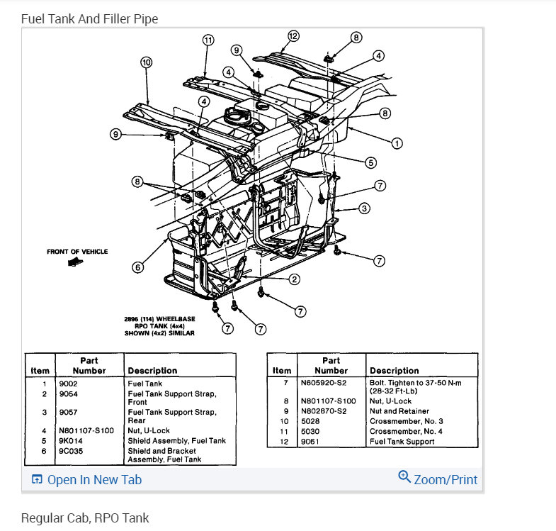

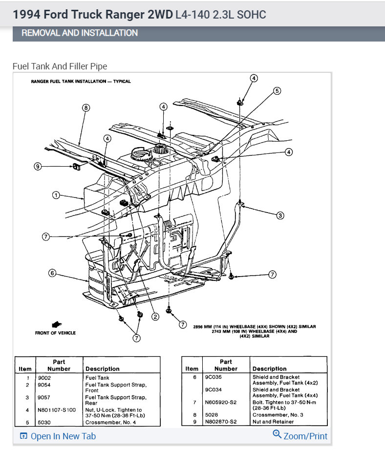

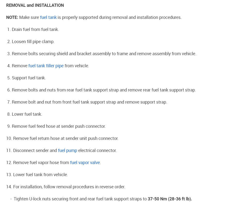

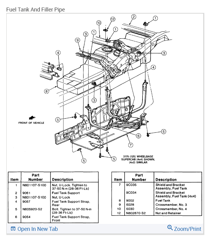

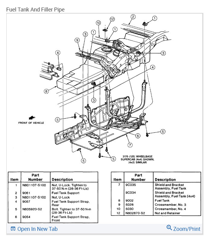

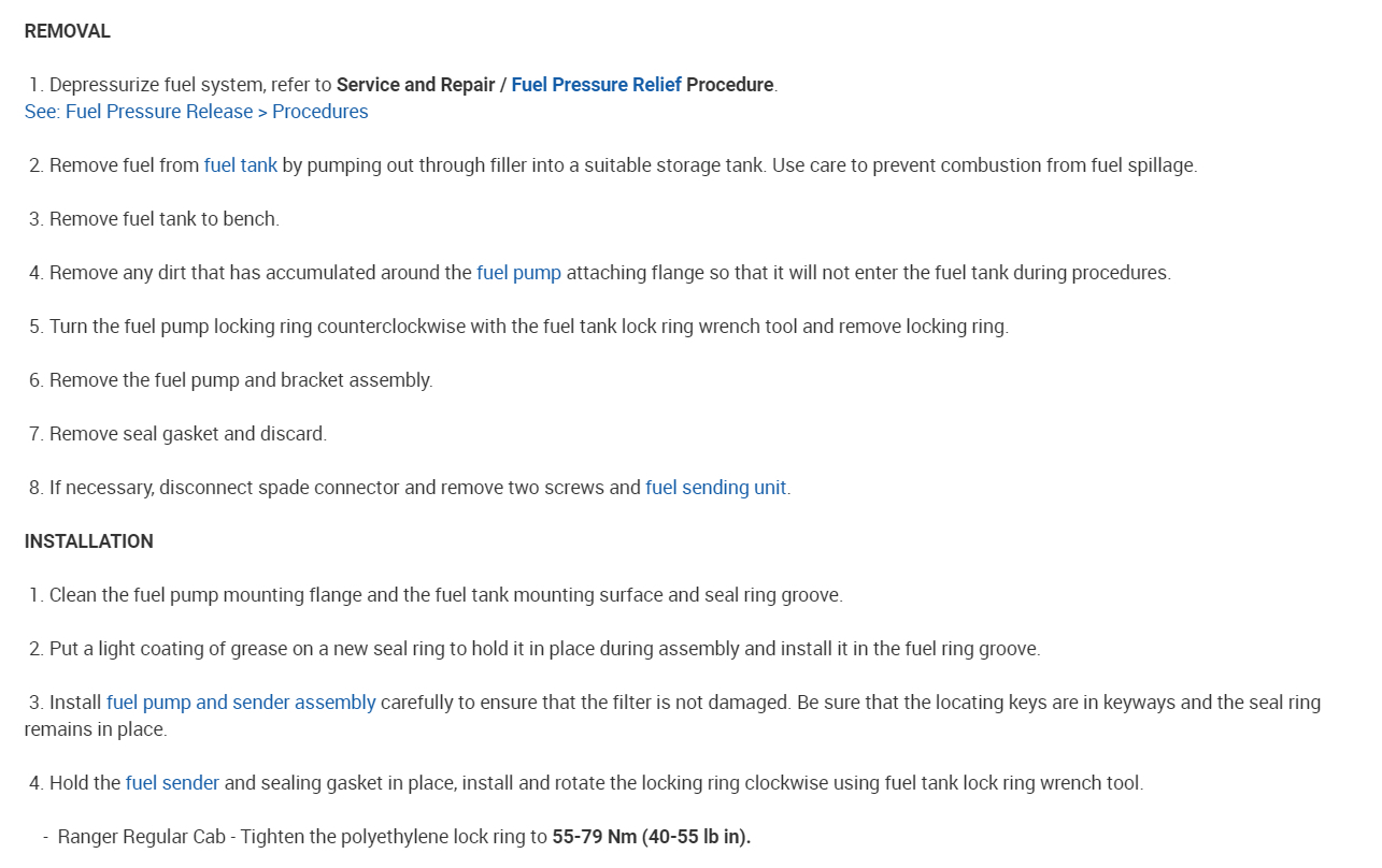

If this doesn't help, I would do the fuel pump.
This video will help you see how the job is done on a similar car with images below to show you how on your truck:
https://youtu.be/SOmd3BoE4YU
Check out the diagrams (below). Please let us know what you find.
