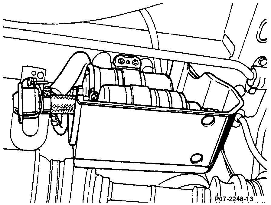

Had fuel relay switch replaced, car has no power. almost seems like it's starving for fuel.

Here are the directions for your vehicle. The attached pictures correlate with the directions.
___________________
1984 Mercedes Benz 380SL (107.045) V8-3.8L (116.960)
Replacing Fuel Filter
REPLACING FUEL FILTER
pic 1
- Remove protective cover.
- Disconnect fuel lines.

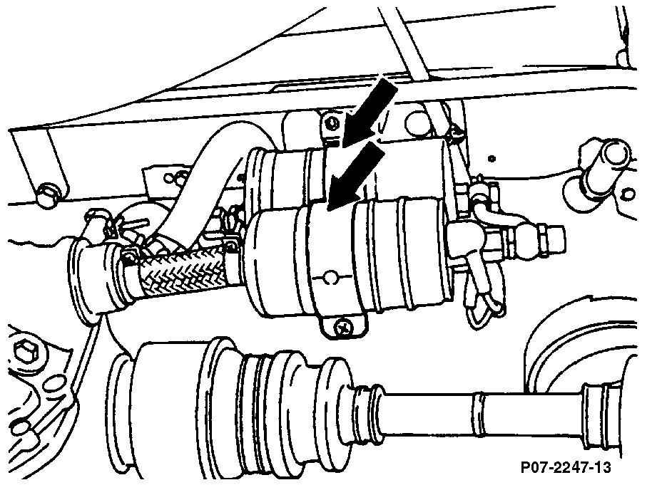

pic 2
- Loosen mounting screws (arrows) and remove filter.
- Unscrew fitting from old filter and attach to new filter with new seal ring.
- Install new fuel filter in flow direction with plastic sleeve.
- Sleeve should project on both sides of the holder since contact corrosion may occur if there is direct contact with the holder.
- Replace plastic sleeve, if necessary.
- Connect steel line to filter.
- Retighten mounting screws.
- Check for leaks.
