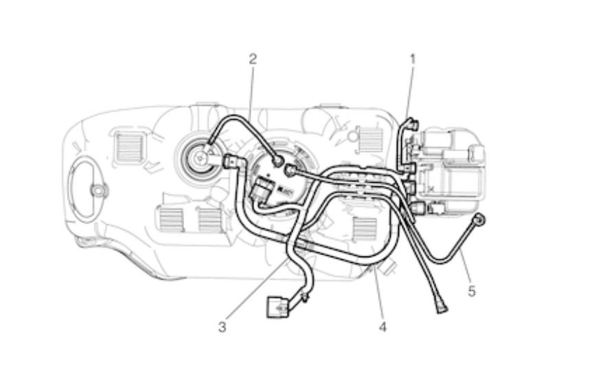

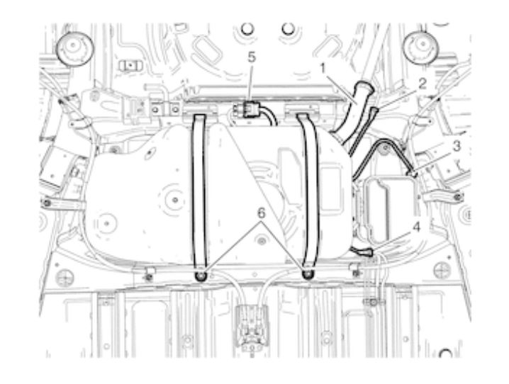

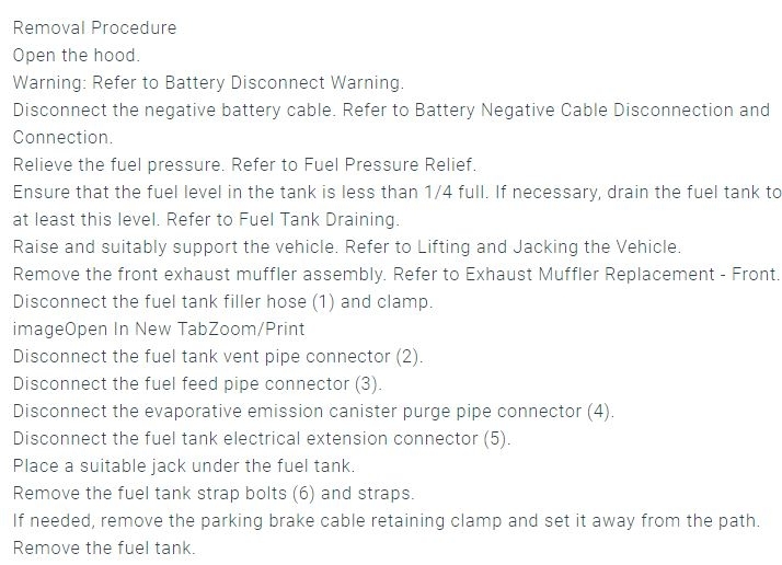

Wondering where to find the fuel filter on my car I need to replace it.
Wednesday, February 5th, 2020 AT 6:57 AM
4 Replies
MECHANIC
52,796 POSTS
Here is a guide to help you step by step with instructions in the diagrams below to show you how on your car.
https://www.2carpros.com/articles/how-to-replace-an-electric-fuel-pump

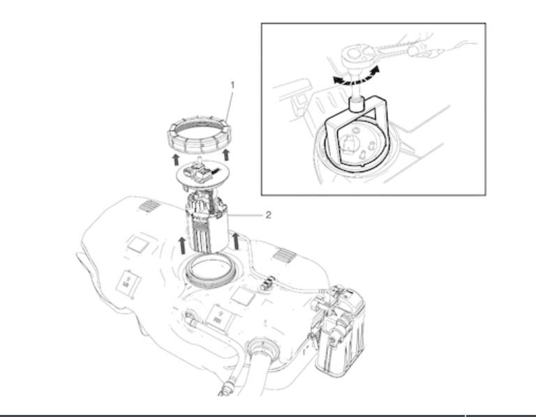

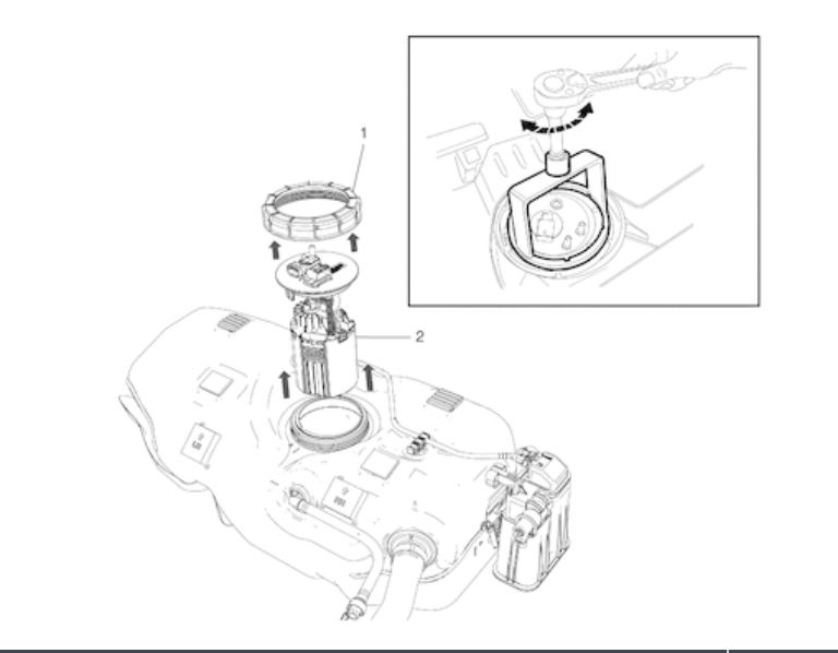

Can't find fuel filter
-1
Monday, October 19th, 2020 AT 4:55 PM (Merged)
HMAC300
MECHANIC
48,601 POSTS
That 's because it's in the tank with the sender and fuel pump
