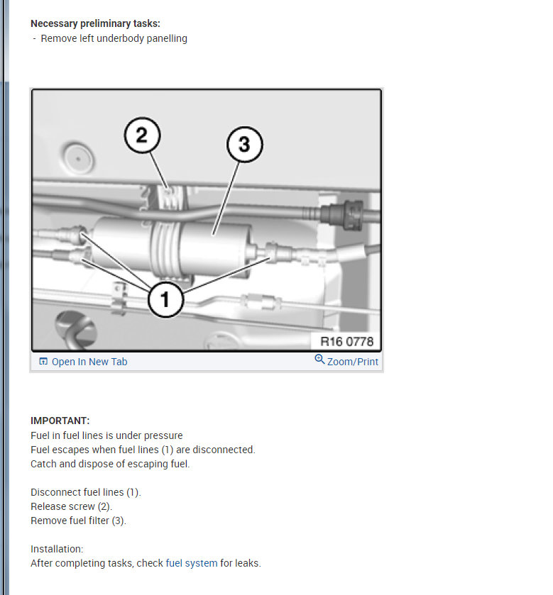

Hi, hope you can help me. Bought an F10 last year. Probably the fuel filter has never been changed. The car is running fine but I want to have a go at changing it anyway as I will also be changing the engine oil and filter. My question is, do I need to disconnect a fuse that controls the fuel flow before removing the fuel filter? If so, which is the fuse? This is a 520d f10 reg 62. Advance thanks. Sal
Wednesday, November 4th, 2020 AT 3:04 PM
13 Replies
You do not need to remove the fuse. Just make sure you have the new filter connected before you cycle the key. There will be some pressure in the line so just wrap a rag around the first line that you remove and then you will be fine until the new filter is installed.

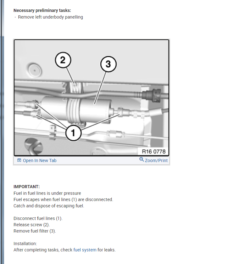

Here is the process for this from the manual. Let us know what questions you have. Thanks

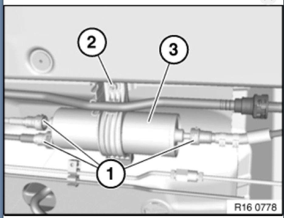

You shouldn't need to touch the clamps. In the image the items marked as 1 are what you remove from the filter, then reattach once the new one is installed. The clamps you see are not regular clamps they are crimped onto the line and don't get removed or replaced unless the line is damaged.
