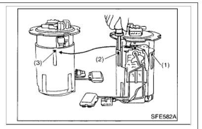

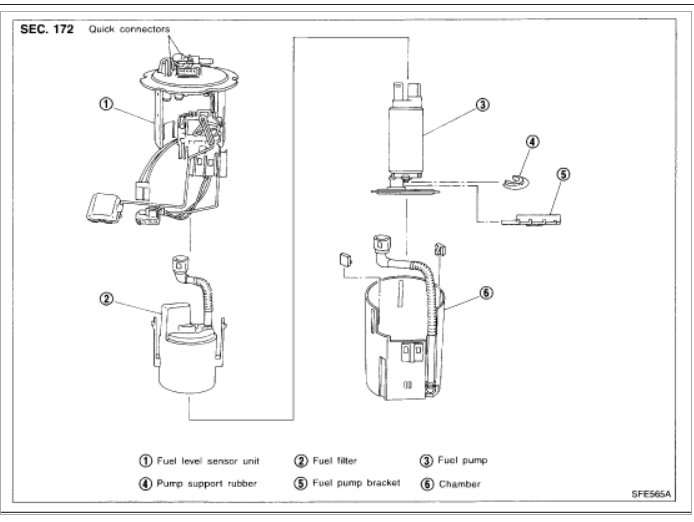

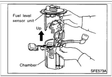

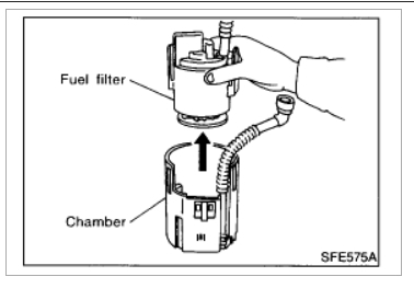

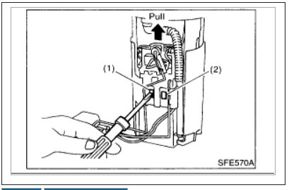

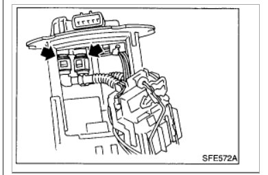

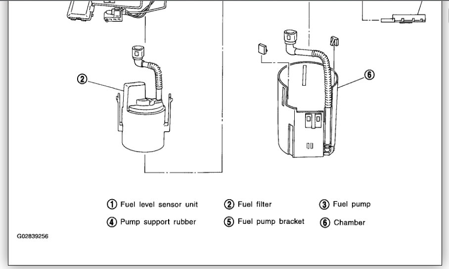

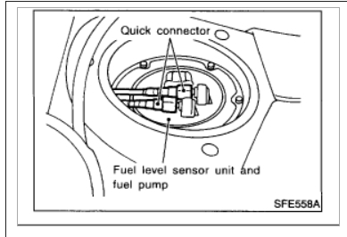

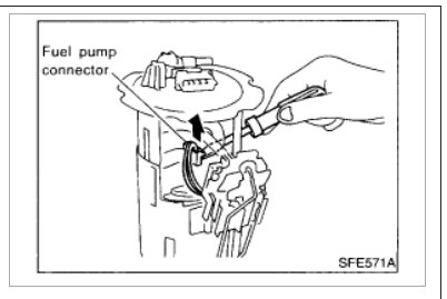

Where is the fuel filter located on the car listed above?
Apr 12, 2019 at 11:25 AM
SCGRANTURISMO
  • 4,897 POSTS

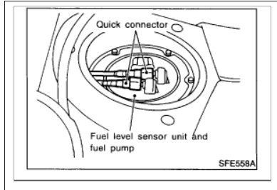

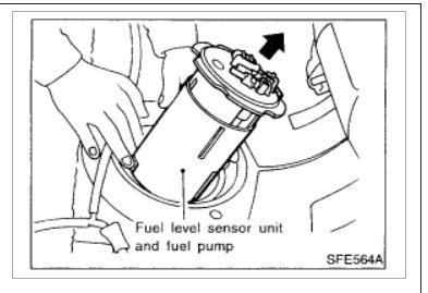

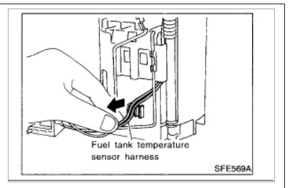

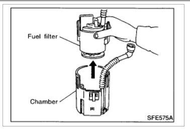

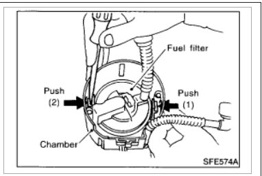

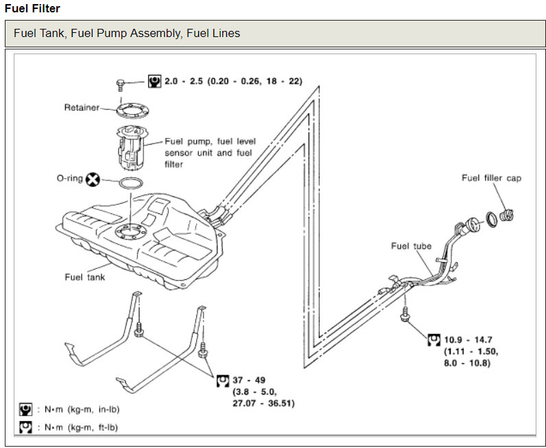

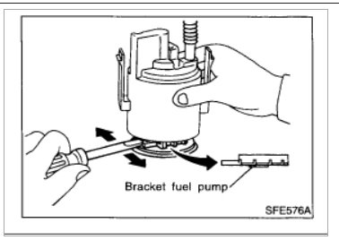

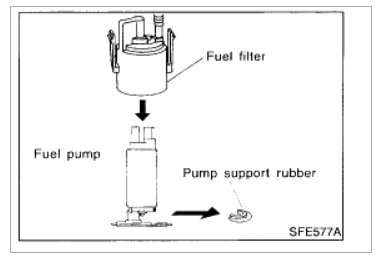

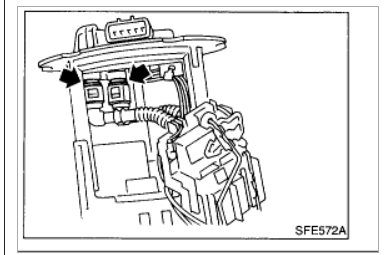

It is located in the fuel tank as part of the fuel hanger assembly. I have included an exploded diagram of the fuel pump and hanger assembly in the diagrams down below.
Here is a guide to help walk you through
https://www.2carpros.com/articles/how-to-change-a-fuel-filter
If you have any other vehicle related questions, please, feel free to ask them. That is what we are here for.
Thanks,
Alex
2CarPros

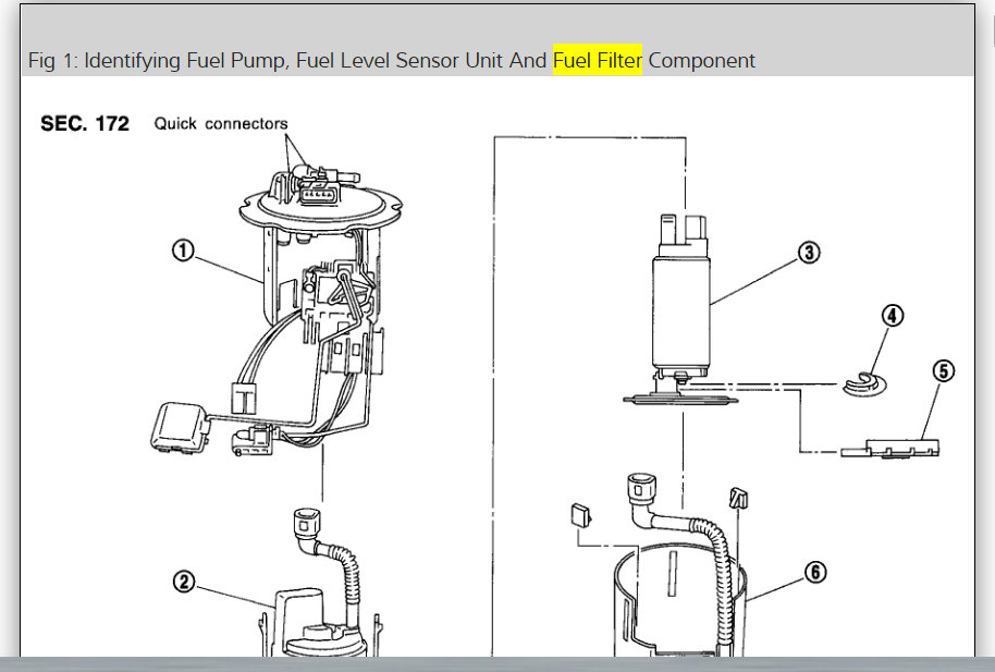

please tell me the location of the fuel filter?
Sep 23, 2019 at 12:17 PM (Merged)
  • 54,897 POSTS

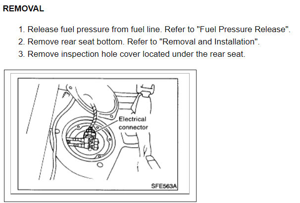

The fuel filter for this car is located int he tank and is considered a lifetime filter but I have seen them plug up. There is a hatch so you don't need to drop the tank. Here are diagrams below on how tot do the job.
