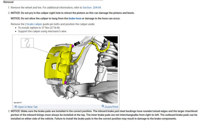

I had my transmission replaced and they said I need new front brakes as well, I need to save money now and want to do them myself can you help me?

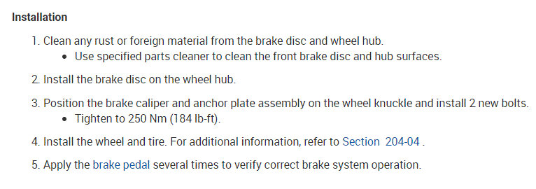

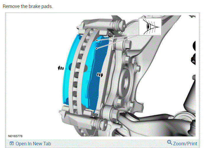

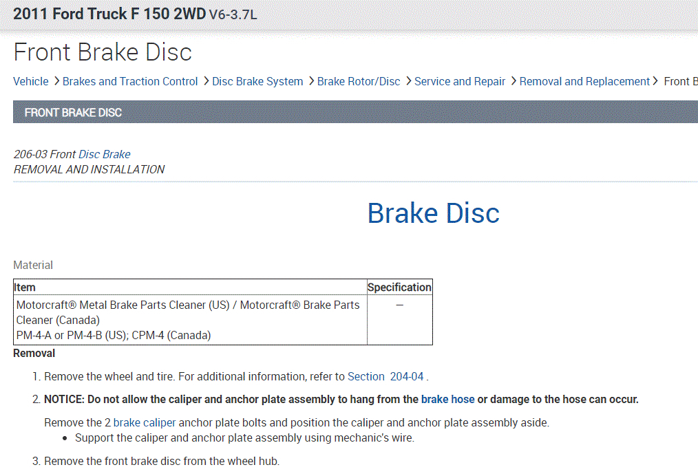

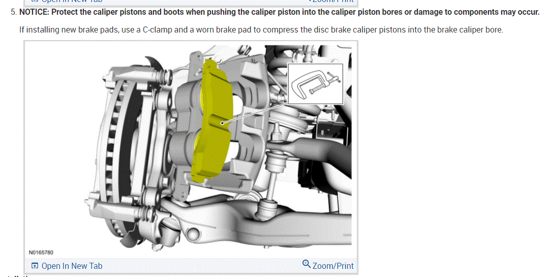

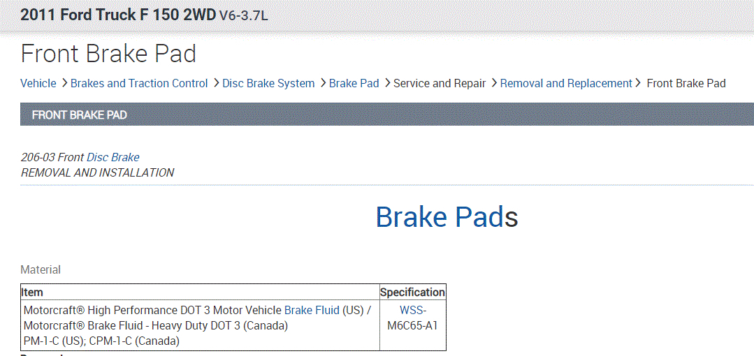

Replacing front brakes and rotors really isn't too hard of a job. You can expect them to last approximately 25,000 miles, but that varies based on driving habits and terrain.
To get started, here is a link that shows in general how it is done. You can use this as a guide.
Here is a video showing it done on a slightly older F-150. However, the process is very similar.
https://youtu.be/Iv9mWLv9QLM

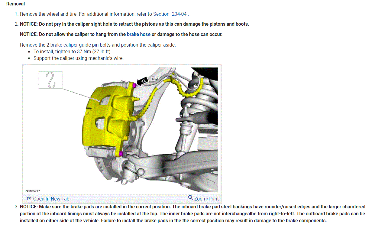

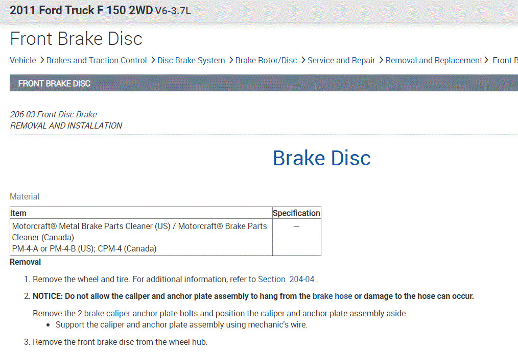

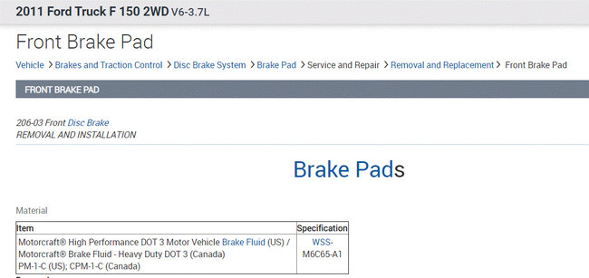

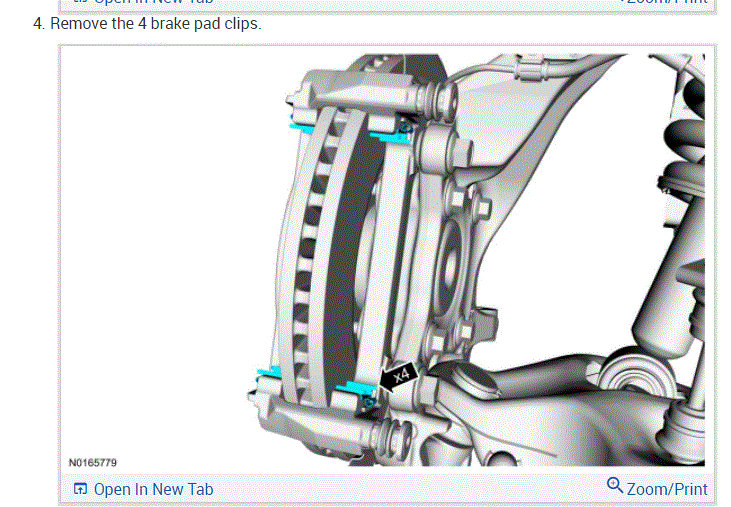

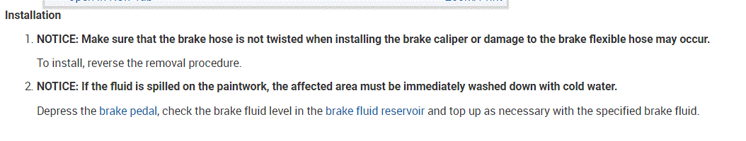

If you look at the attached pics, they provide the directions and pics specific to your vehicle.
See pics below
