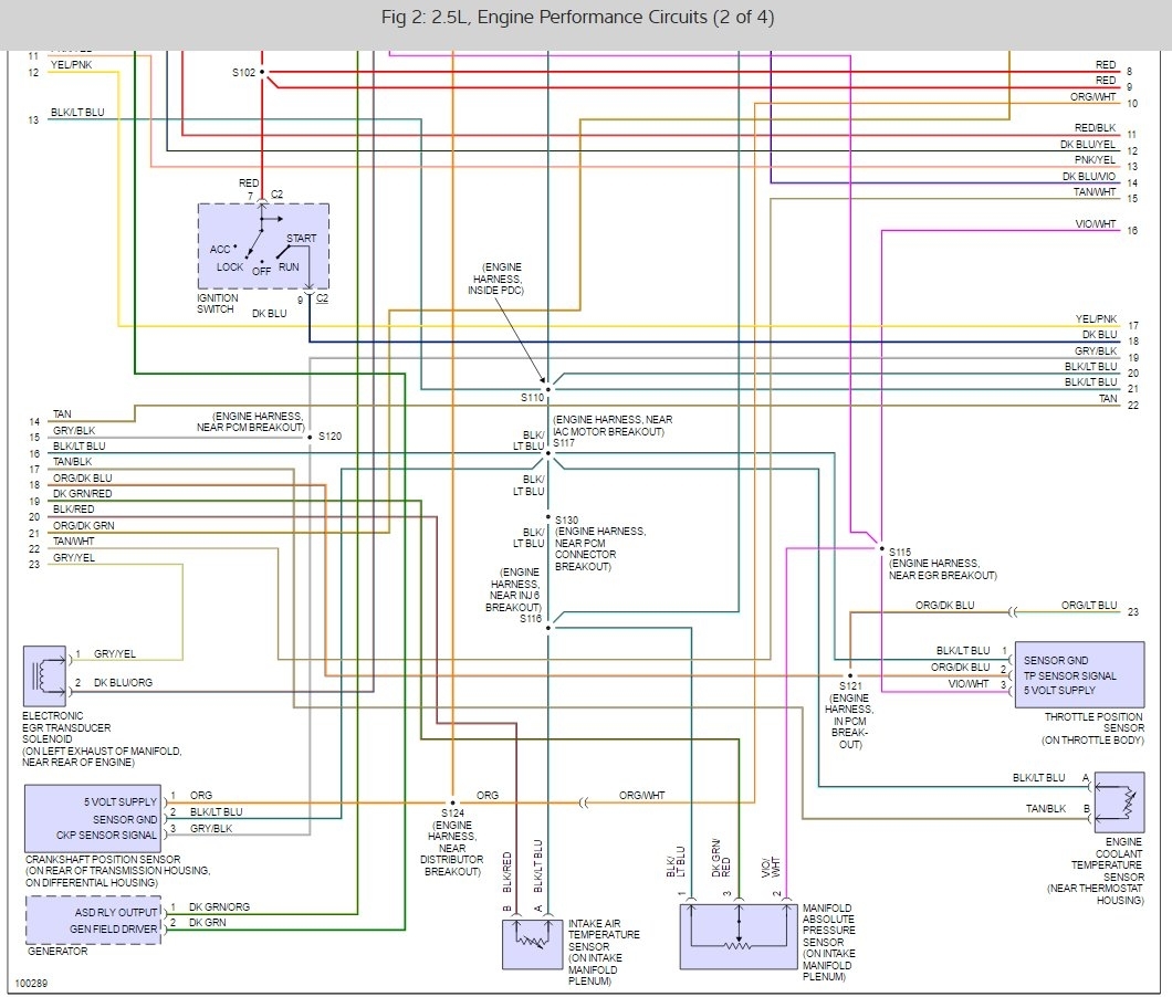

Fuel shutting down after initial start. Will run for a few seconds then it shuts down, but will restart after I energize the pump.

No codes. It starts. Then it is like it runs out of gas then when I shut the key off and turn it back on. It will start and do the same thing. The factory alarm is messed up and will not work. But it starts then shuts down. Tried everything I could think of but still no results.

The fuel stops no more pressure. Then turn the key off and turn it back on it will start again and run for a few seconds then shut down.

Btw 146_150. Then 0. It is like something is shutting it off after it is running.

It is like a shut off trigger is activated and stops fuel.

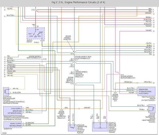

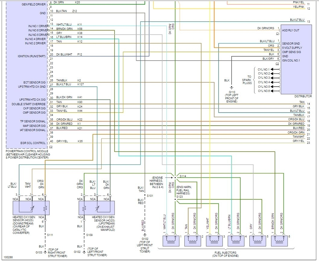

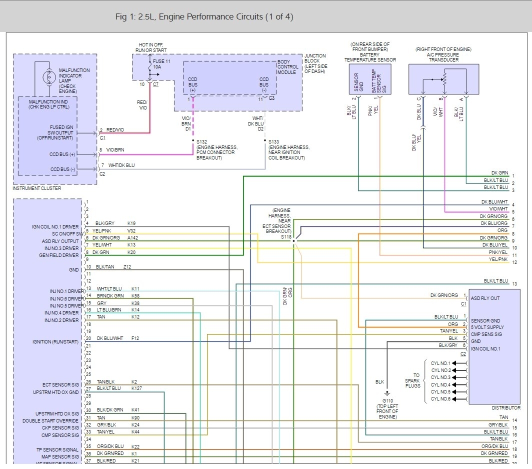

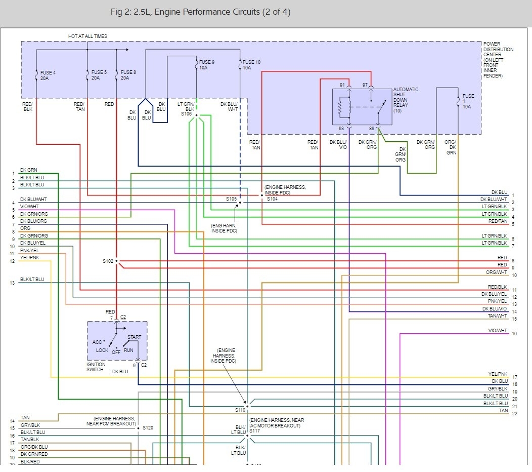

It sounds like the ASD relay is going bad, here is a wiring diagram and relay test guide and location to help you get the problem fixed. I would also try unplugging the 02 sensors for now to see if you have a heater shorting out.
Please run some tests and get back to us so we can continue helping you.
