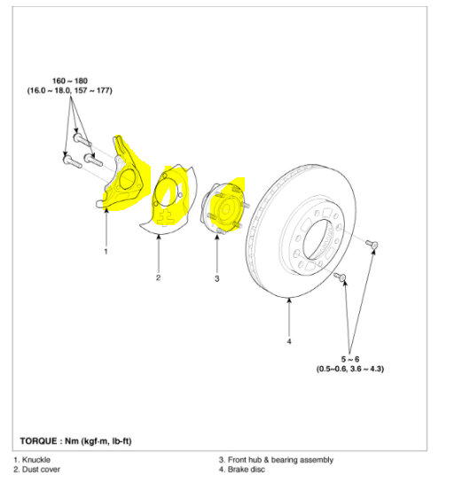

Yes, that certainly can be done, but it is going to be extremely expensive. Also, I'm not sure if we will find the knuckle with the bearing, hub, and brake dust shield already together. The brake dust shield needs to be installed prior to pressing the bearing into the knuckle. See pic below.

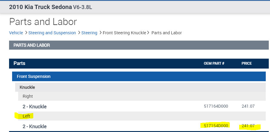

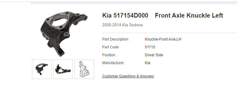

Also, I attached a pic showing the OEM part number and I found one online. However, it is only the knuckle.
If there is a salvage yard near you, check to see if you can find a good new one. If you can't, I would recommend having this one repaired. Otherwise, you will be purchasing the knuckle, hub, bearing, and dust shield because the old one will need to be taken apart to get some of the parts.

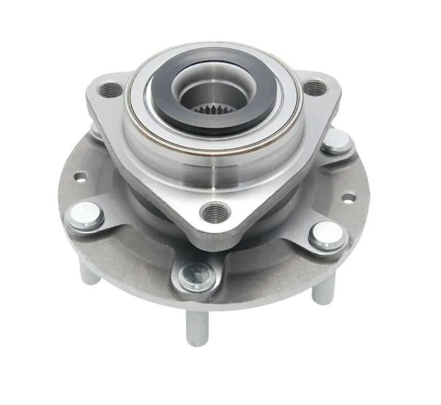

I have watched you tube wheel bearing removals and I am a little confused. Some show removing the nuckle and others show just replacing the bolts that hold the hub on. Which one does this model of van have lol? Thanks again Mark
Nov 2, 2023 at 11:16 AM (Merged)
BORIS K
  • 836 POSTS
Hello

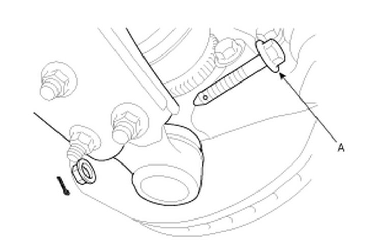

The 2010 model Kia Sedona is the MK2 model which has a bolt on hub. See image 1
So you would need to raise vehicle and remove the front wheel.

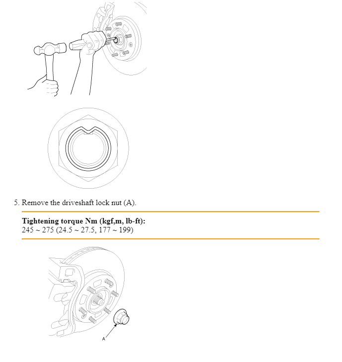

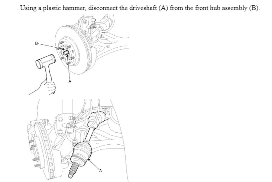

Loosen the outer CV joint centre nut
See image 2

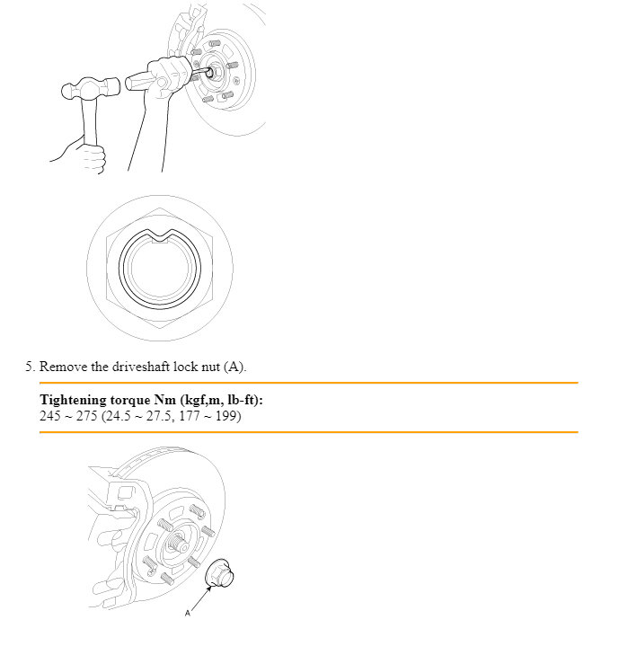

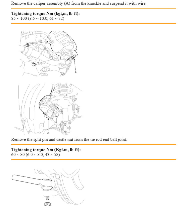

Next remove the front brake carrier and brake disk. Loose tie rod, See image 3

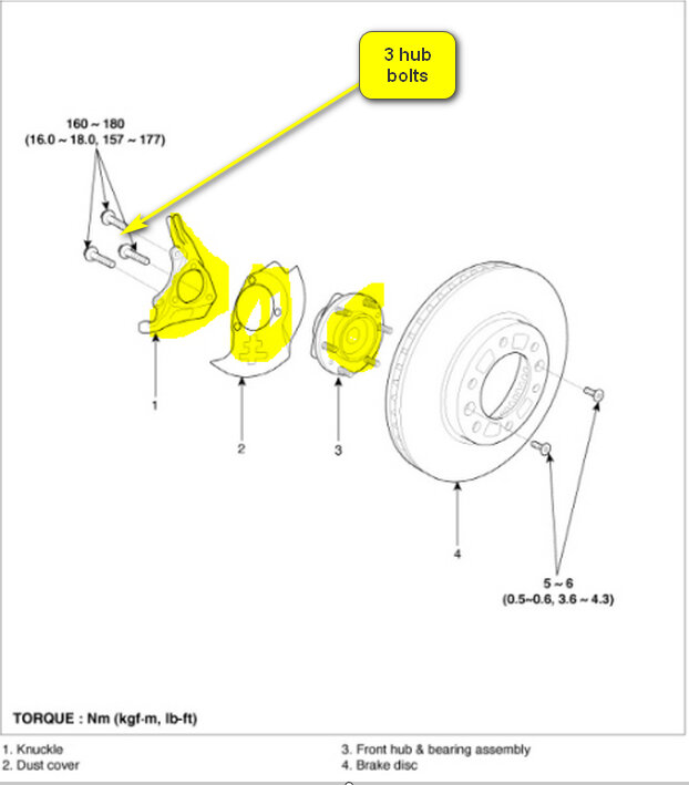

Loosen and remove the lower ball joint so that you can remove the CV joint from the hub.
See image 4+5
Once done next remove the 3 bolts holding the hub assembly to the knuckle. Image 6
Remove the old hub assembly, fit new hub assembly and reassemble
Mind the tighten torque for the 3 hub bolts, 160-180Nm
The tightening torque for the centre CV joint nut is 245-275Nm
