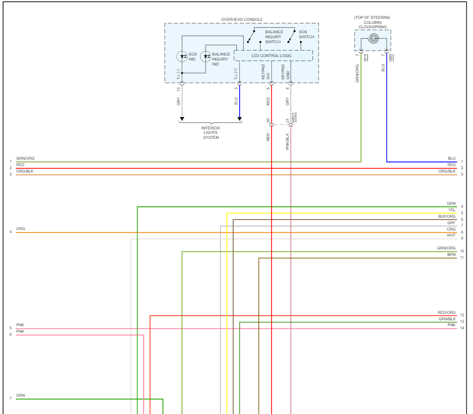

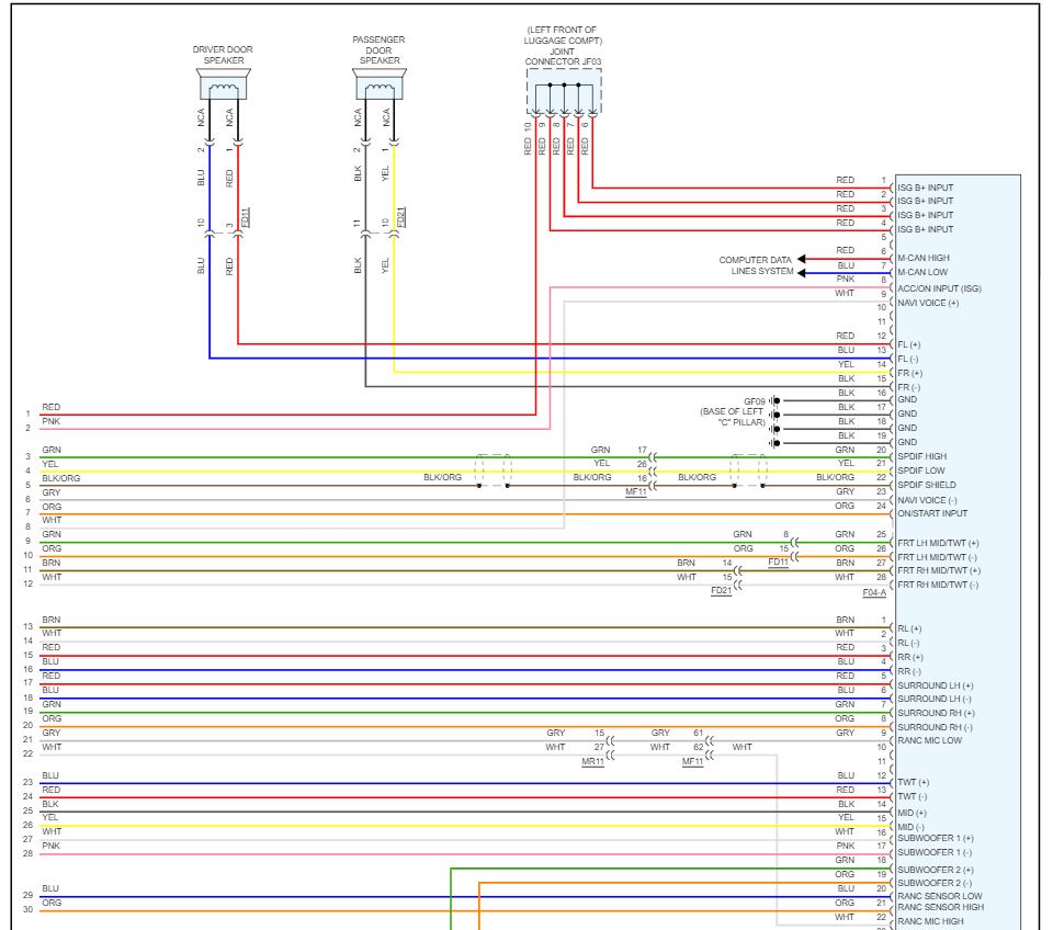

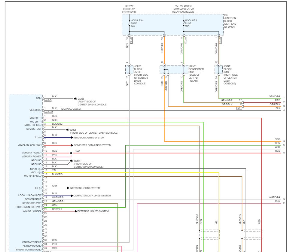

I am having a very strange issue, I have all 4 channels connected to my amp and have sound coming to all 4, however if I fade the sound to the front there is no sound and therefore cannot hear any phone calls either.
I have tapped into the wires in the kick panel that match the +/- of the respective speakers. Does anyone know or have a diagram of which wires are from the HU and how those run to the speakers?

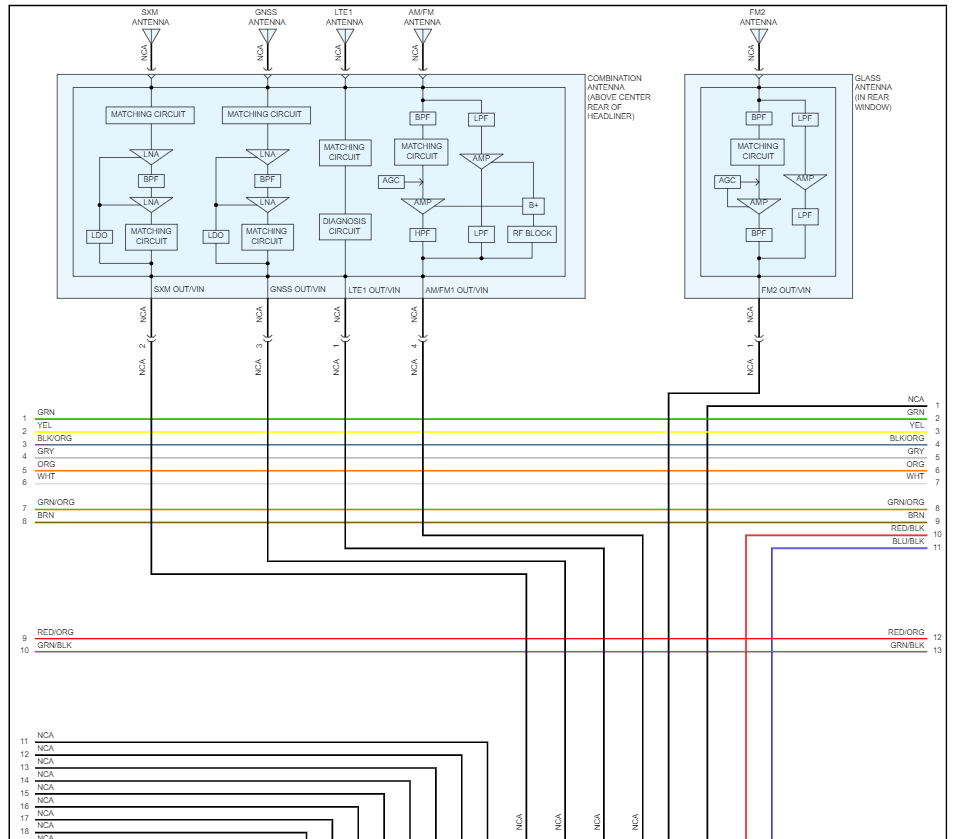

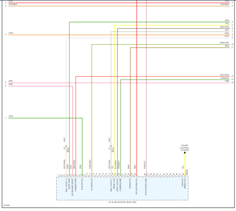

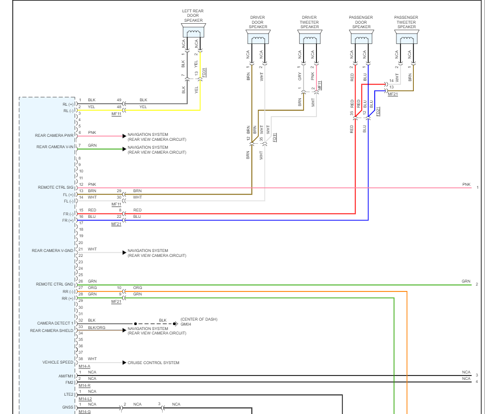

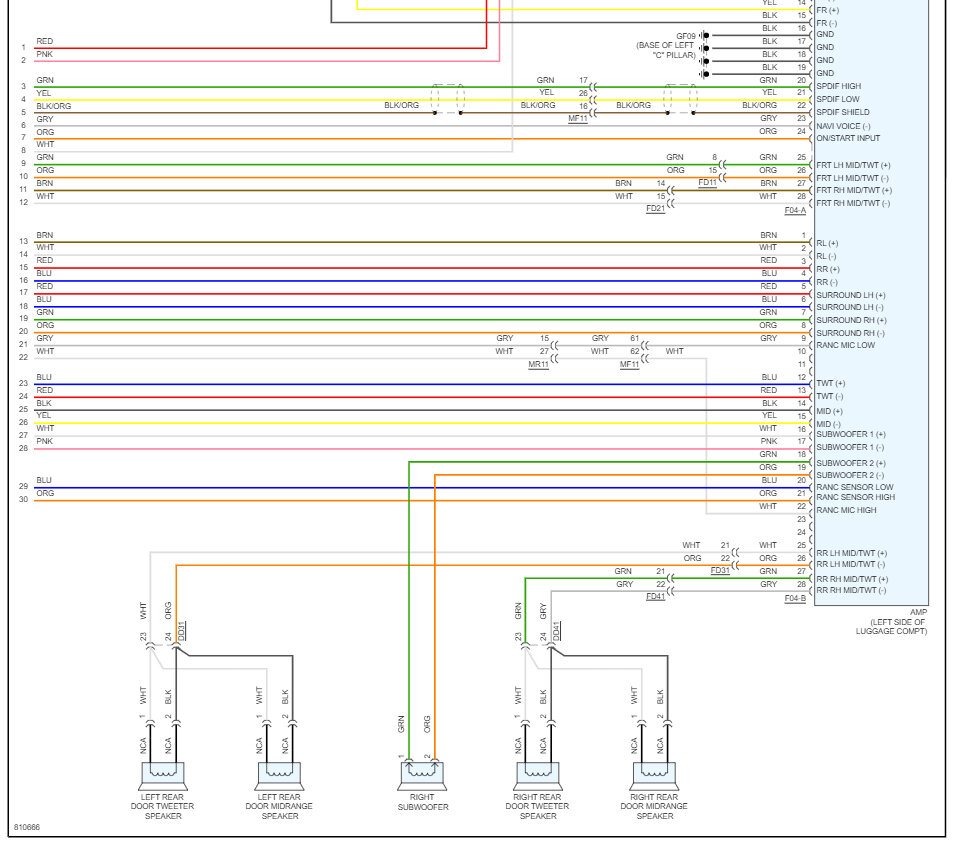

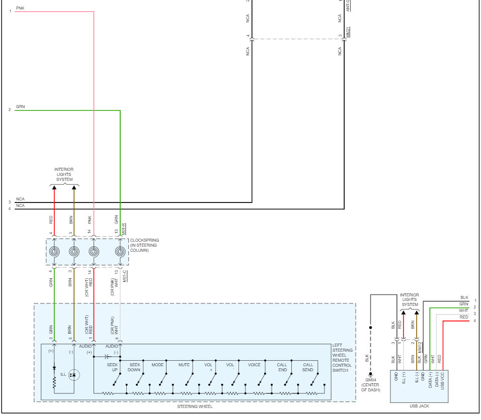

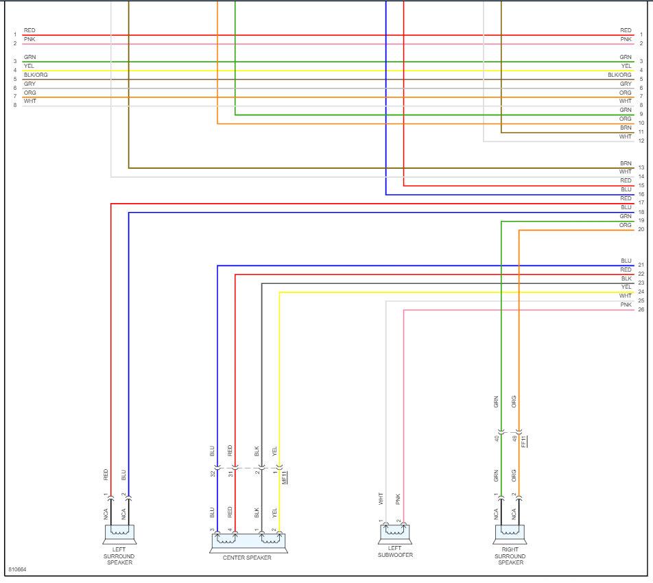

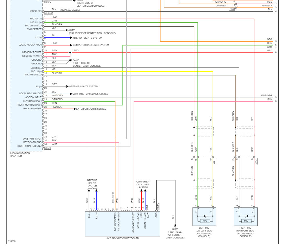

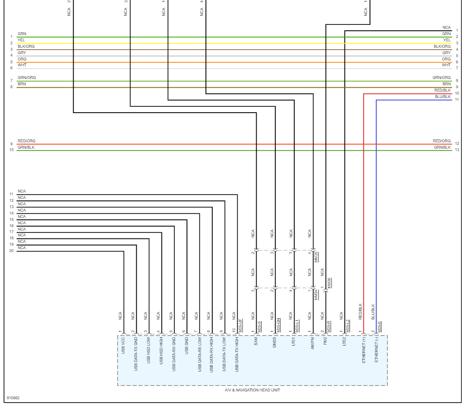

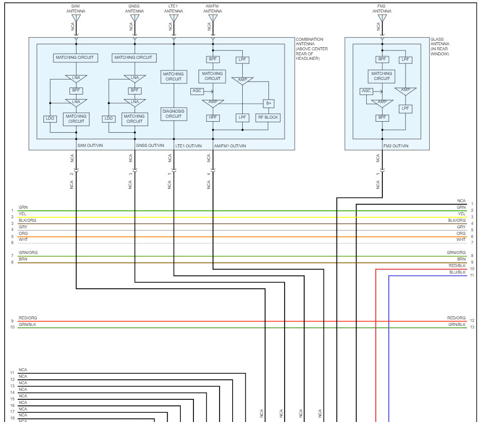

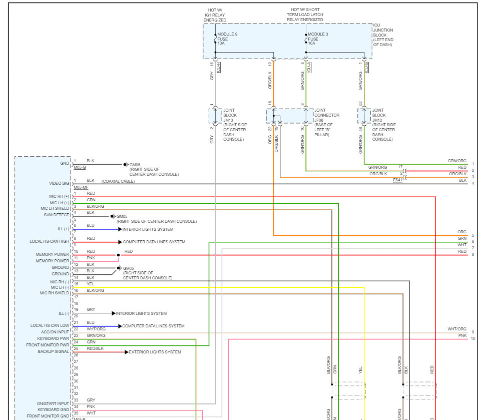

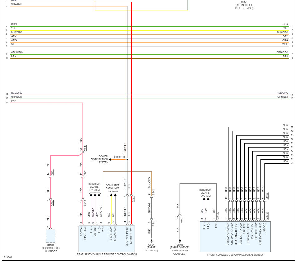

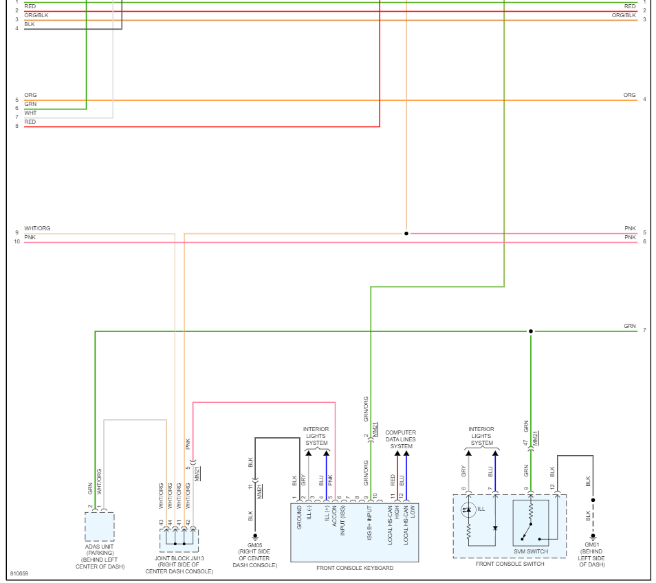

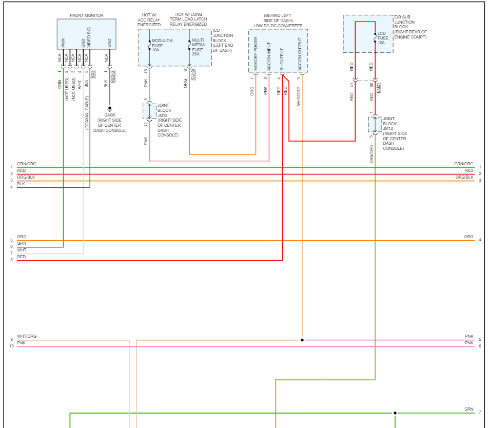

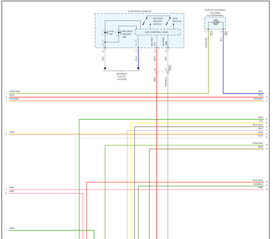

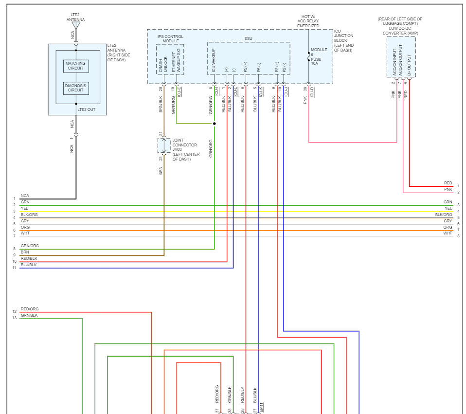

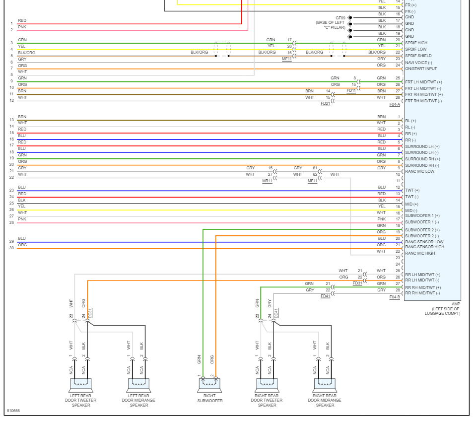

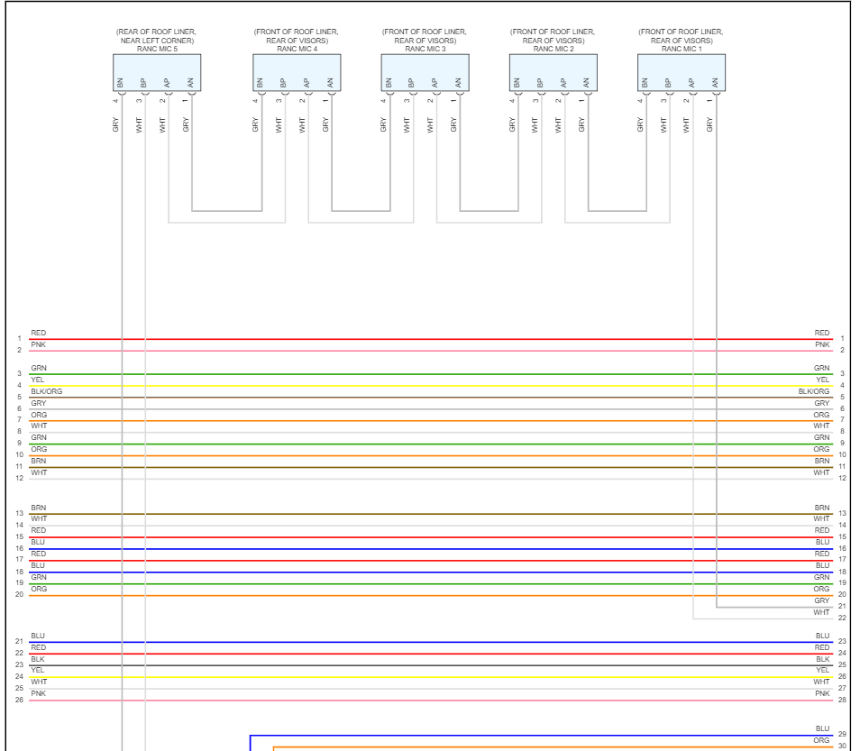

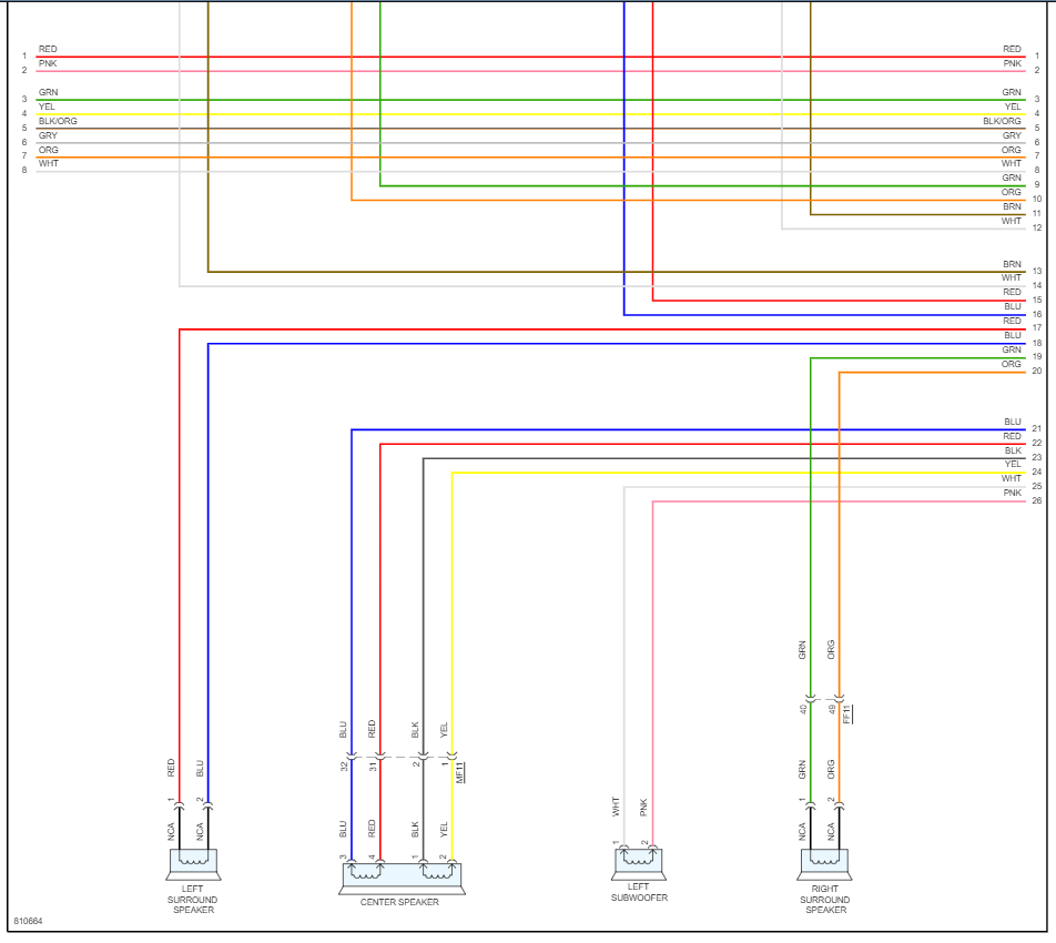

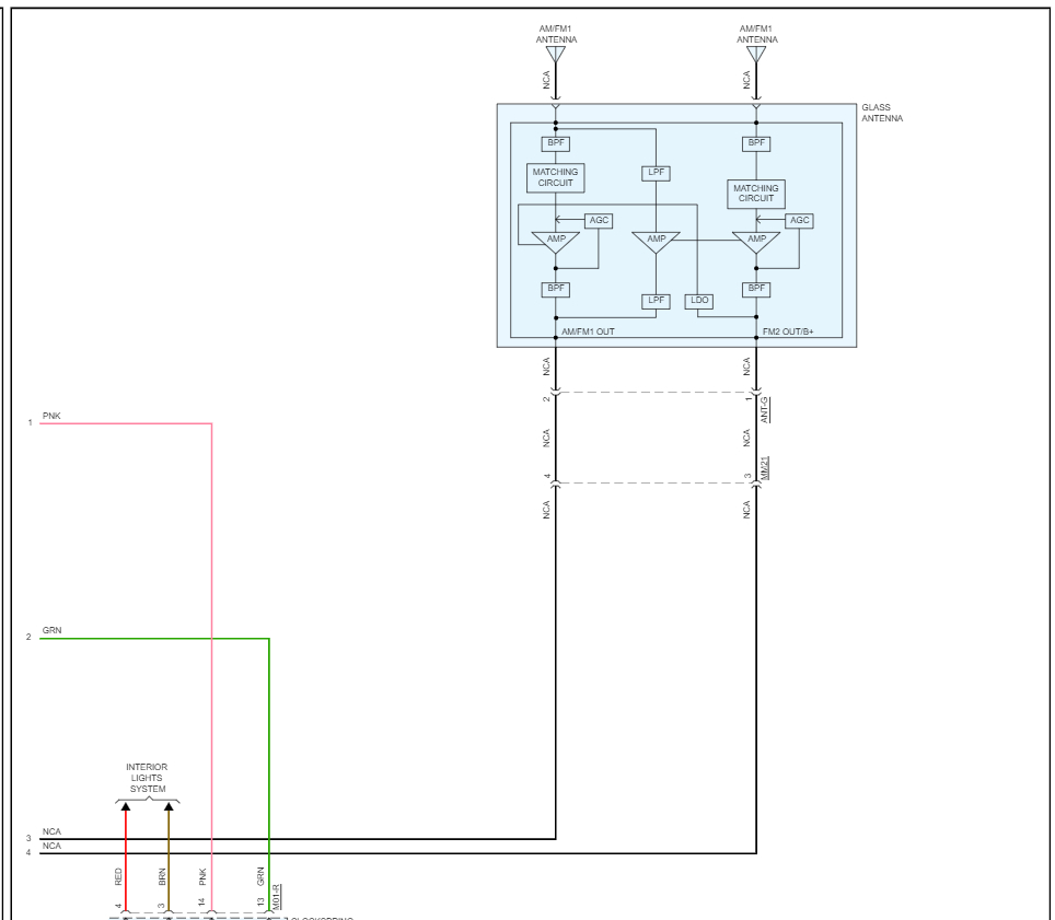

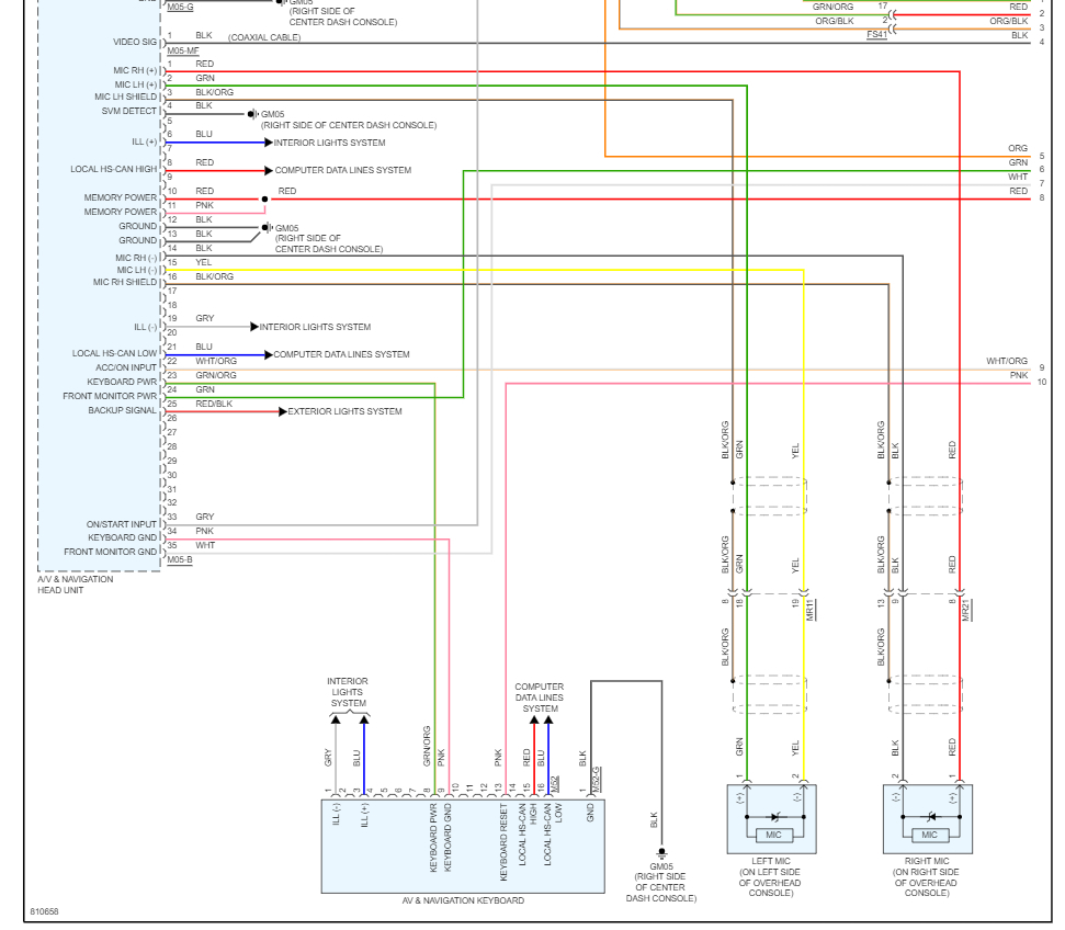

Yep, there are many wires to the radio system. here is a guide to help you test the connections and the radio wiring diagrams in the images below:
Check out the images (below). Please let us know if you need anything else to get the problem fixed.

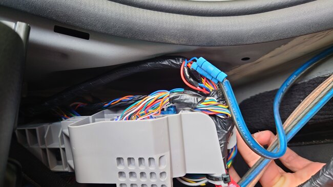

Wow, that's a lot. I have the standard non-Bose system. I see that I need that R/B wire that's direct to the passenger side front speakers, I believe I spliced into that as I found where that lead into the door jamb, but the issue is acting like I taped into maybe the RR signal wires. Do you have anything that shows which wire is which on the Molex connectors in the respective kick panels of the passenger and driver side?
The blue/silver is the output wire from my amp and the pink cable is for the input to the amp.

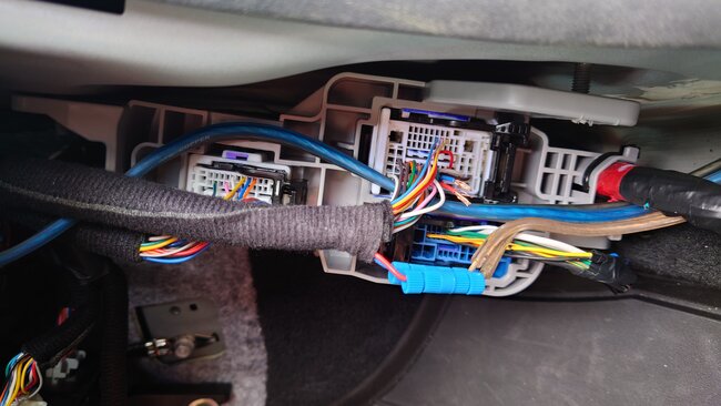

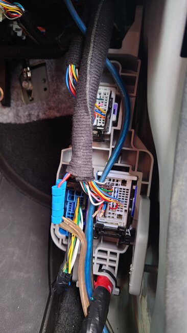

I'm trying to look at the Molex panels that are in the driver and passenger kick panels. The wiring from the radio leads into then but each connector has other things as well so there's not just the "audio" wires.

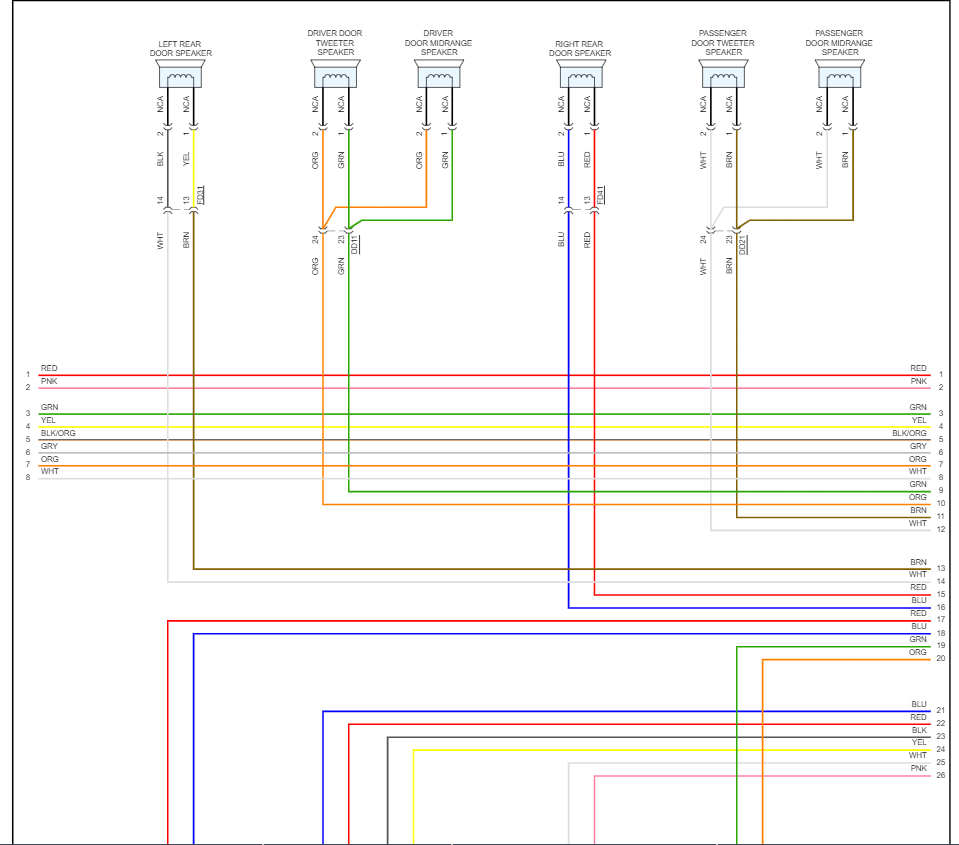

Not sure why it's turned sideways, the right side of the image is the bottom of the car/floor. These are the panels in the passenger kick panel. Do you have anything that shows this layout and which wire does what? I need to find the wire that is coming from the radio that sends signal to the speaker on that side.
You can see the posi tap I connected as it's on the red/blue (-/+) but it seems as if that pair sends the Rear speaker signal because when I fade the sound forward there's nothing and when I fade it to the back, there's sound in the front speakers.

They don't give us wiring diagrams like that, only individual systems. I would use the wiring diagrams above and see if you can find the wiring for the radio speakers, they should be together in the connector.

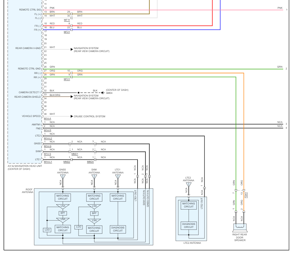

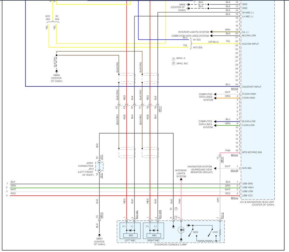

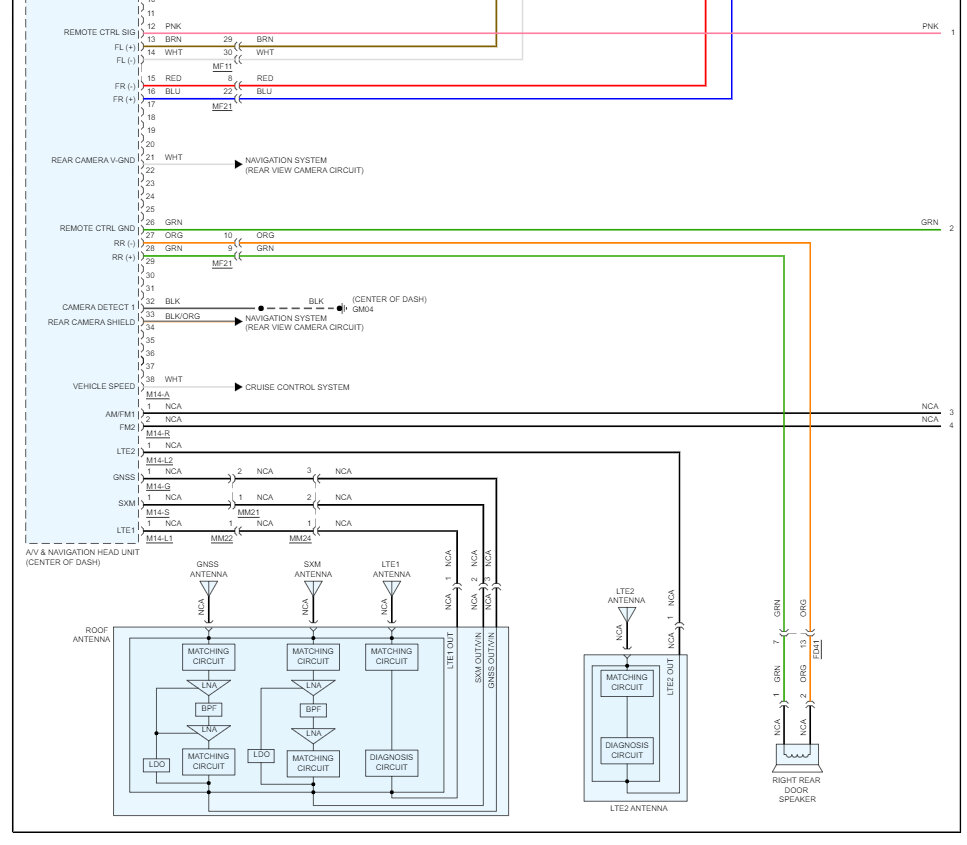

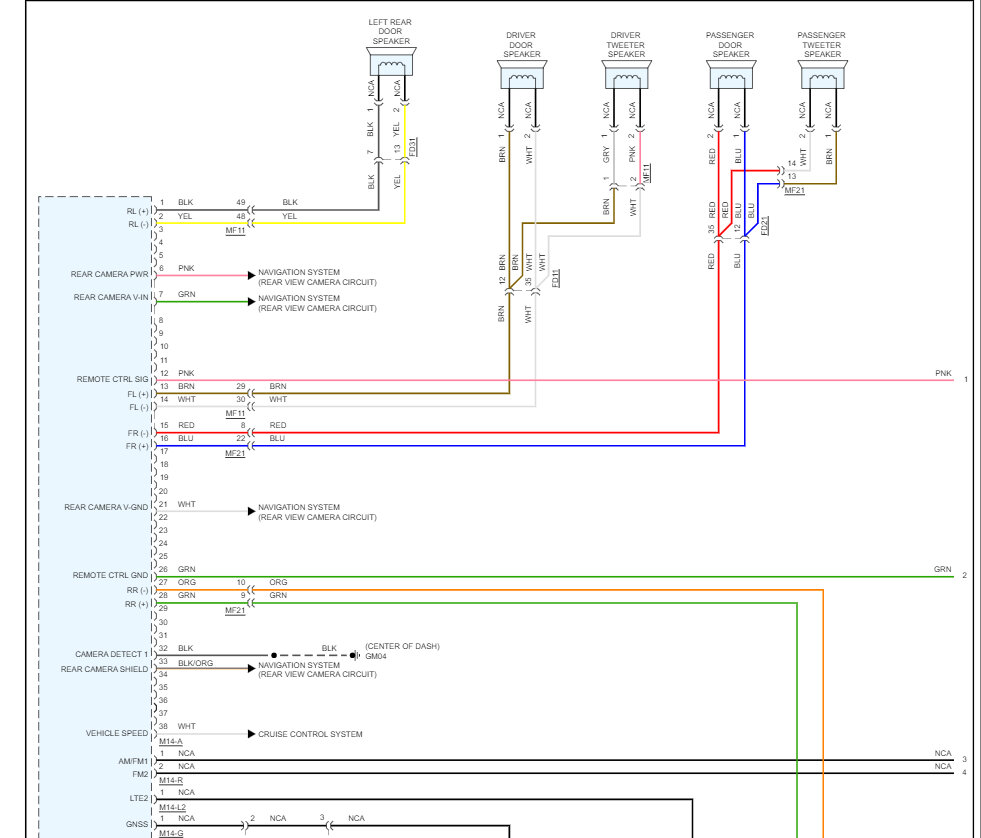

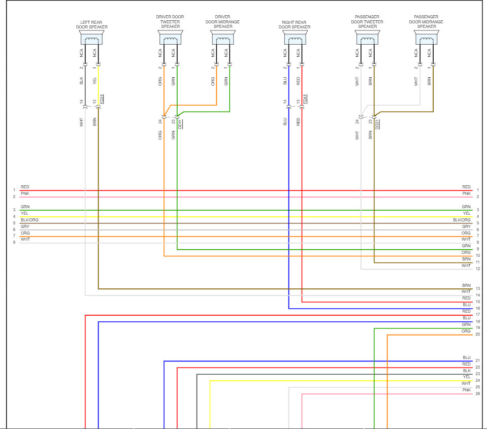

Since those above are for the K900, do you have those diagrams for a non-Bose (6 speakers) K5? For example, in the K5 the passenger front wires are red and blue, and the diagram above has subs, surround etc., for the upgraded sound package.
Apr 26, 2023 at 1:58 PM
  • CAR REPAIR CONTRIBUTOR
  • 54,436 POSTS

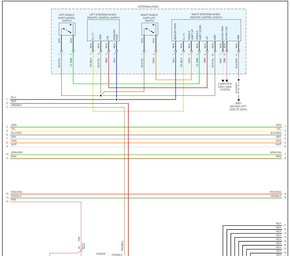

Sure, here are the basic radio wiring diagrams. Check out the images (below). Please let us know what you find.
