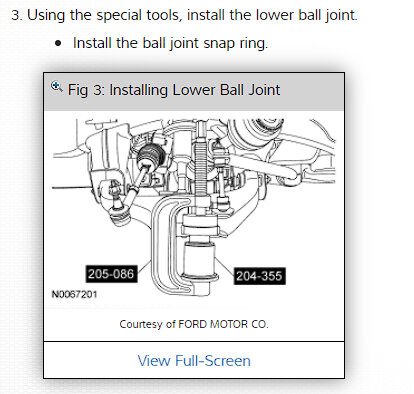

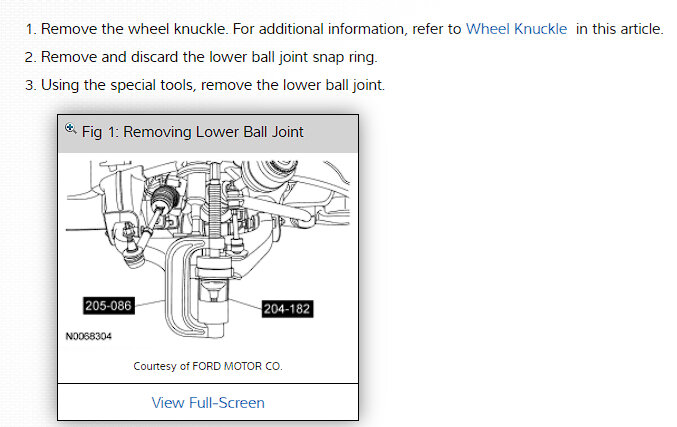

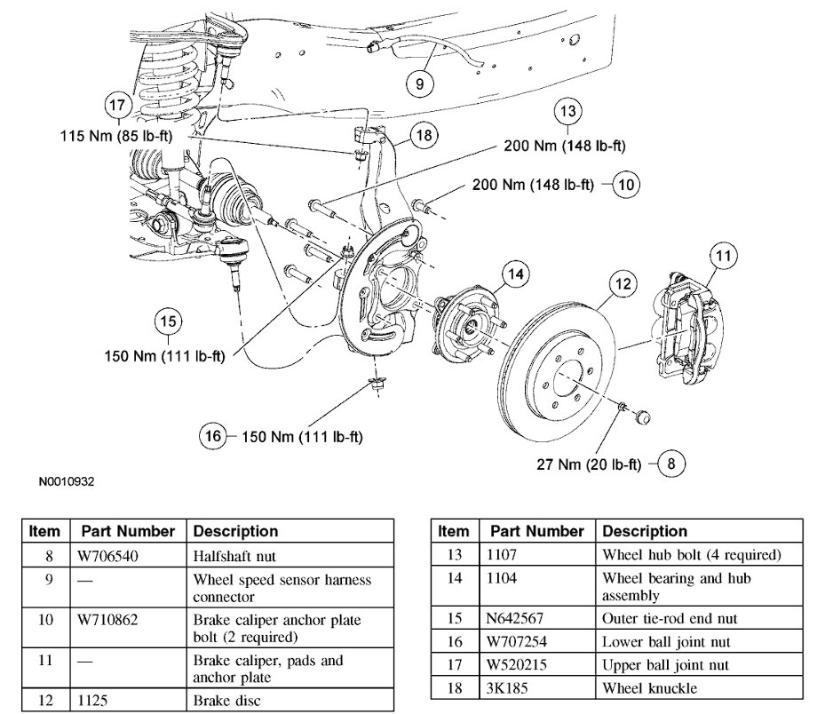

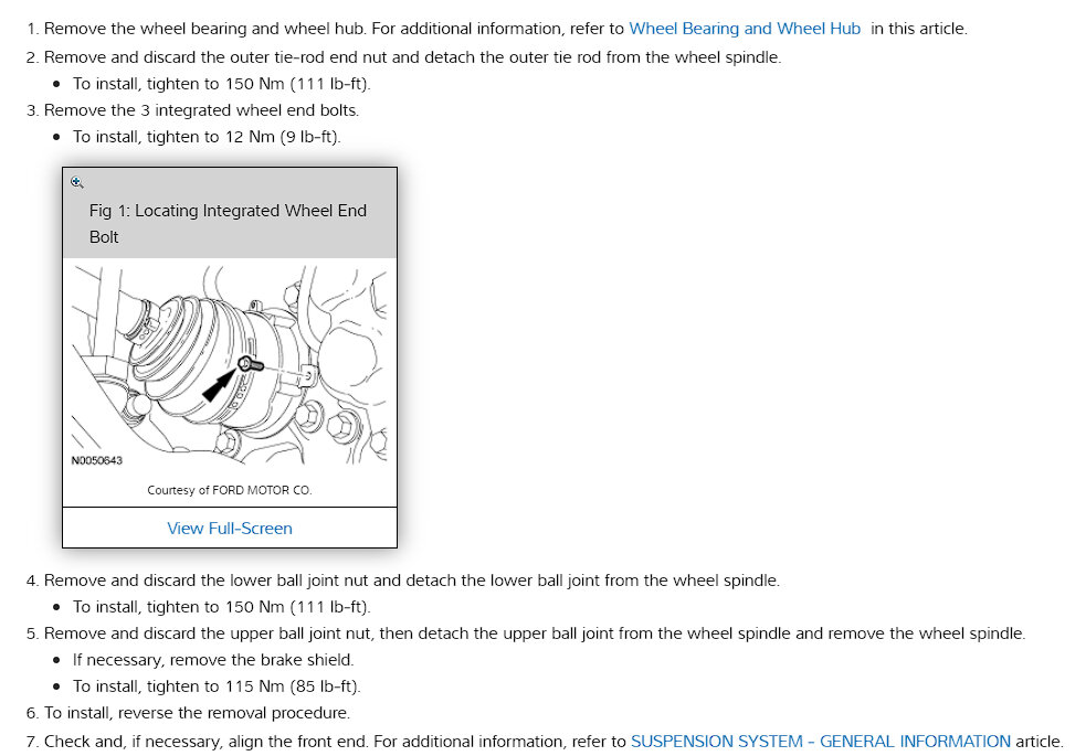

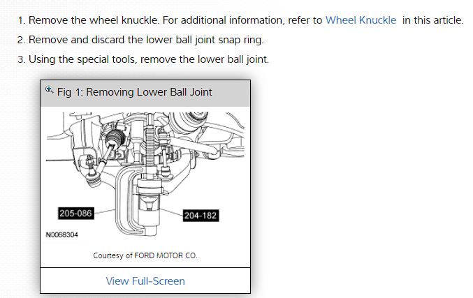

Hi, I just found out from Les Schwab after trying an alignment that I need both front lower ball joints replaced. Please keep in mind that this is a 4x4 on the truck listed above. Please give me detailed instructions with pictures along with needed tools and any pitfalls to be weary of ahead of time. Thank you, guys, so much.

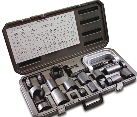

The main thing you will need beyond basic hand tools is a ball joint press. You should be able to rent a kit at any major parts store. You will need to raise the front end and place it on jack stands. After removing the wheels, you will need to remove the brake calipers, rotors and wheel hubs.
This video should help you out even though it's about hub replacement:
https://youtu.be/qOAyXfPo7Z0
Also, this guide to getting the ball joints loose from the knuckle:
https://www.2carpros.com/articles/how-to-release-a-ball-joint
And this video might help as well:
https://youtu.be/tBpOOHzTNes
