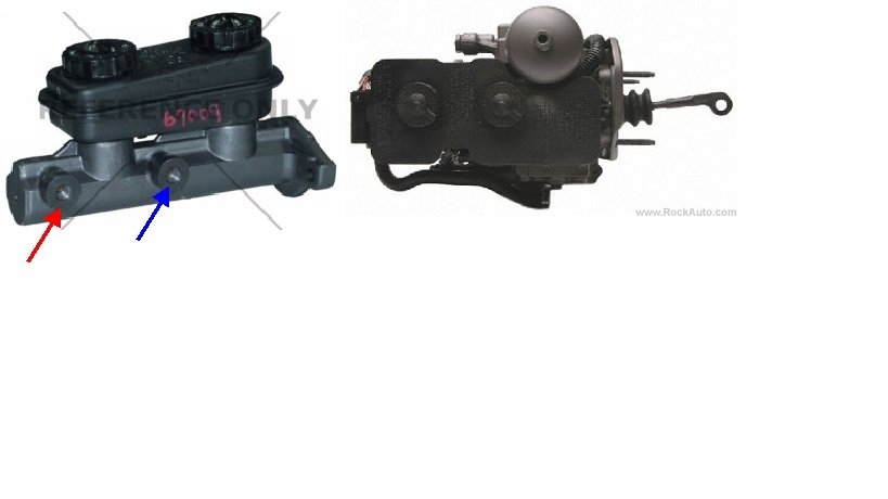

A faster way to tell if the car has anti-lock brakes is to look at the master cylinder. If you have standard brakes, the master cylinder will be about 8" long, a bluish-colored anodized aluminum, with a black plastic, ... Wait a minute. Pictures are faster.
These are from Rock Auto which I use a lot for reference. They aren't to the same scale. You most likely have the master cylinder on the left. It's shown looking at it from over the left front tire / fender. If you have anti-lock brakes, you'll have the Bendix-10 system which uses the unit on the right. This one is shown looking down on the top of it. This one is more than twice the size of the one on the left.
My concern is when both front wheels are getting hot. There's a real simple fix when only one wheel is affected, and we may still find that to be true for each wheel individually, but for now, find a "flare-nut" wrench, also called a "line wrench", that fits the soft metal nuts on the lines attached where my nifty red and blue arrows are pointing. I can't remember the size, but it should be around a 3/8" / 8mm. A standard wrench may work, but it's real easy to round off the nuts because they are very soft.
When the problem is occurring, stop on a slight incline, shift to neutral, and assuming the car doesn't creep downhill on its own, place a block about a foot downhill from a tire so you don't look funny chasing after the car if the brakes release! Use the flare-nut wrench to loosen those two steel line nuts about a half turn each. If the brakes release, we'll have to discuss this further because this is going to be a very expensive repair. The brake fluid was contaminated with a petroleum product like engine oil, transmission fluid, power steering fluid, axle grease, or, ... WD-40!
If the brakes do not release, breathe a sigh of relief. I'll describe where to go next once you verify the car doesn't have anti-lock brakes. You didn't answer my question about the brake pedal. Is it higher and harder than normal?

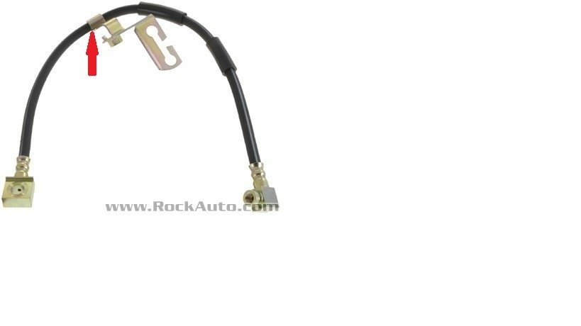

It's looking like you're going to have a more common problem with a REAL involved solution. Turn the steering system fully one way, then crawl underneath on the side where you can see the rubber brake hose. Look for the metal bracket that my nifty red arrow is pointing to in the photo. Use a large flat-blade screwdriver or a large pliers to open up that bracket where it is crimped around the hose. Rust builds up inside that crimp and constricts the hose. Brake fluid pushes real hard through that restriction. That's why the brake pedal is higher and harder than normal. The fluid can't return easily, so it keeps that caliper applied. As the brakes get hot, that heat migrates to the brake fluid and makes it expand. That self-applies that brake even harder.
If that doesn't solve the problem, turn the steering system the other way and do the same thing on the other front hose.

Hold on. Are you saying someone is going to replace the master cylinder? That is not the solution. You need to open up those brackets where they're crimped around the rubber flex hoses. If the master cylinder was causing this problem, it would be due to fluid contamination, and loosening the two steel lines attached to it would let the brakes release.
I never looked at either of my Dynastys, but I suspect those brackets can be stretched open without removing the wheels. I had to do this to two of my four Grand Caravans, and the hardest one took the better part of three minutes, and two of those were to find the tools.
Rust builds up inside the bracket between it and the hose. That is like making a fist around the hose, then squeezing it closed. Opening the bracket is like relaxing the fist.
