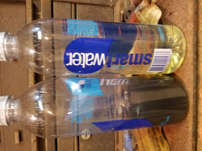

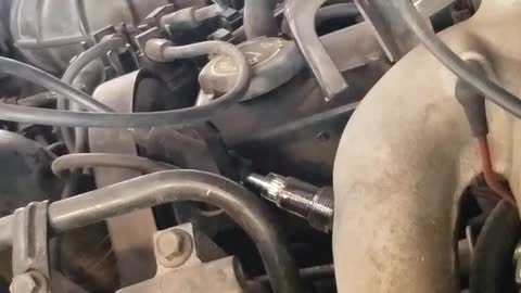

Alright guys I'm lost. I have the truck listed above that ran decently before a week ago. Every now and then it would sputter but not a big deal. I lent it to a uncle and he got to the end of the road and it quit running. I've been checking stuff I haven't ever worked on a Ford. Originally I thought it was the fuel filter or pump. It turns over but wont fire like at all. I changed the fuel filter so far I have a before and after of the gas in a bottle it was nasty on the before. I've checked the spark. It does spark but the two coil packs and eight plugs on a four cylinder just makes my head hurt. I ran a diagnostic for the check engine light. It came up a p0000 code which means it couldn't finish the diagnosis. Any help is appreciated.

This is the before and after of the gas out of the filter.

Spark.

Good evening,
The fuel condition looks bad. I am concerned it may have got to the injectors and clogged them with dirt.
Did you test the fuel pressure?
Monday, February 25th, 2019 AT 2:58 PM
