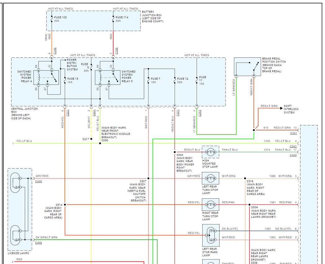

1999 Ford Windstar Tail lights do not work
RON DUEHRING
  • 1999 FORD WINDSTAR
  • 6 CYL
  • 2WD
  • 120,000 MILES
Might be relay fuses all okay
Sunday, October 12th, 2008 AT 2:38 PM
2 Replies
  • 75,992 POSTS

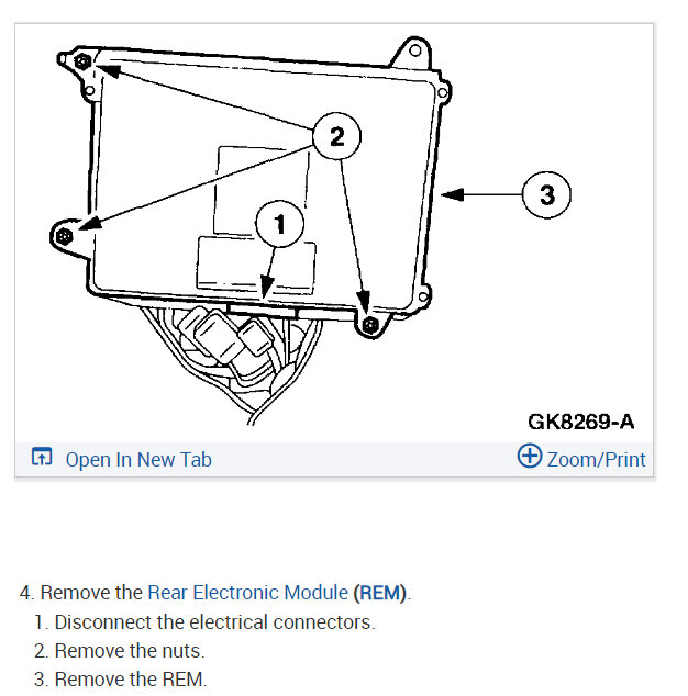

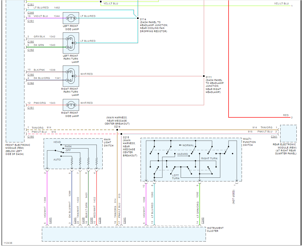

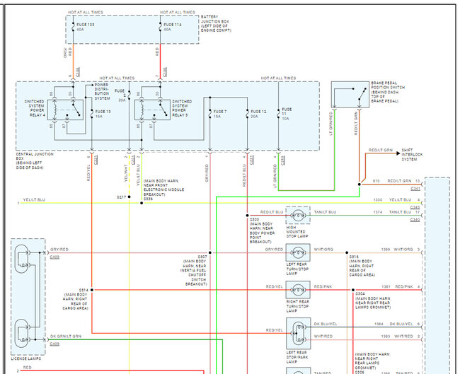

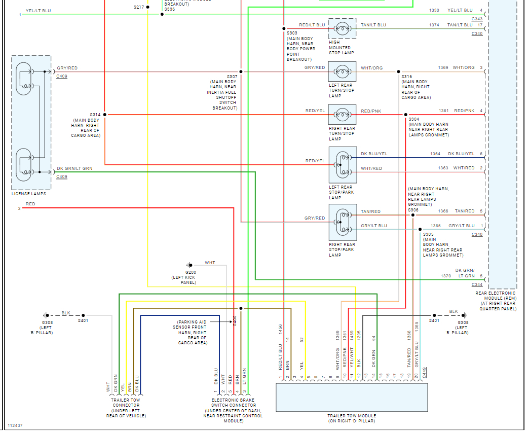

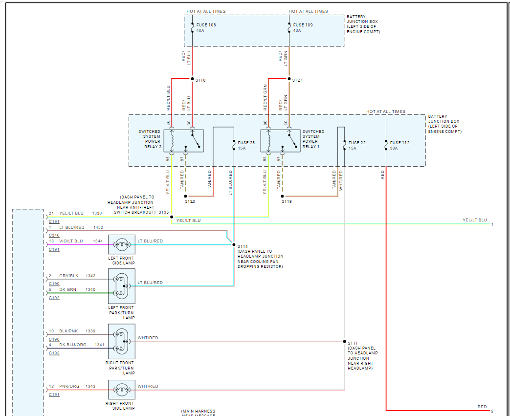

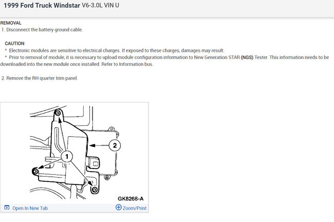

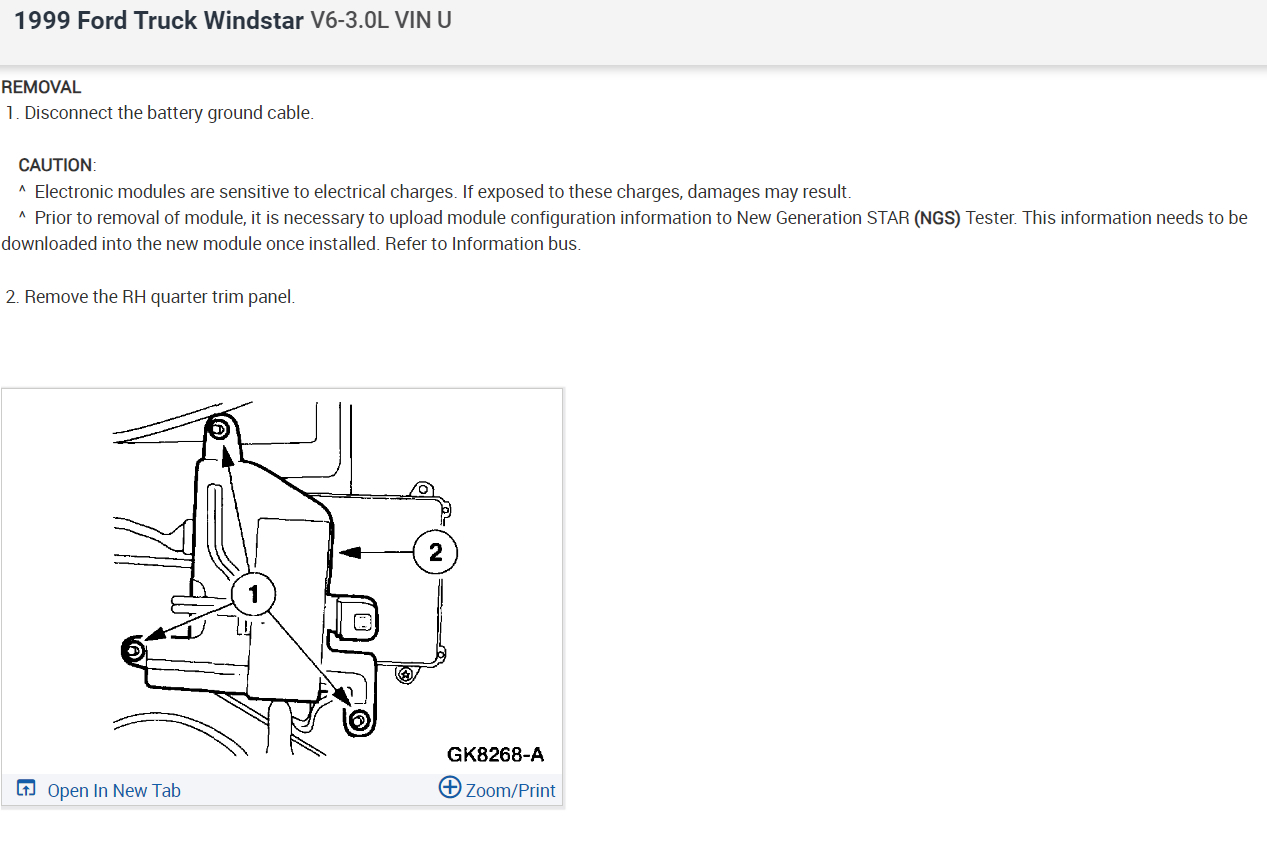

Have the main light switch and the rear electronic module.
-1
Monday, October 13th, 2008 AT 5:01 PM
KEN L
  • MASTER CERTIFIED MECHANIC
  • 55,481 POSTS
It is going to be a bad ground or the rear electronic module. Here are the taillight wiring diagrams so you can see how the system works. this guide that can help as well:
