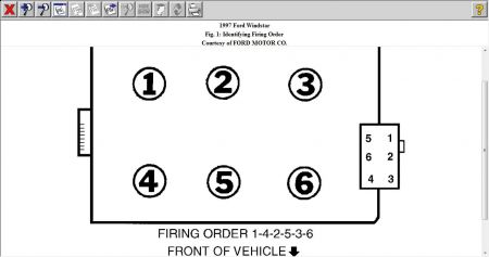

i was just wondering if you might be able to tell me what cylinders are where and how to remove the rear plugs behind the engine to fix those cylinders as well, please give me any input you can and also I have another code, it is po174, could you please elaborate on that also thanks

The codes I get are po300 and po304 and another one that I cant remember, it was either po305 or po306, maybe both but I would like to possibly get a diagram as to where the cylinders are and what number they are and how to remove plugs in the rear of engine
Friday, November 27th, 2009 AT 8:40 AM
  • 75,992 POSTS
Dunno how to get the back side plugs in a quickie never done 3.0/3.8 liter engine
https://www.2carpros.com/forum/automotive_pictures/12900_winstar_fo_1.jpg
