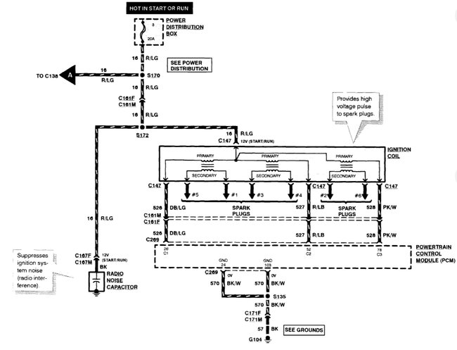

My car will turn over but will not start?
Saturday, February 27th, 2010 AT 4:28 AM
SQM
  • 6,383 POSTS

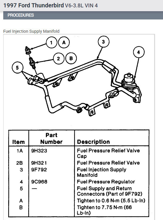

An engine won't start for either no spark or no fuel.
Have you checked to see if you are getting spark to the plugs? What about the fuel pressure?
Can you hear the fuel pump come on when you turn the key to on position?
If you are not getting spark then one of the possibility is the ignition control module, it could also be the crank sensor.

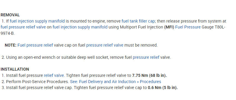

You can also check to see if there is sufficient fuel pressure. Here is a guide on how to check for fuel pressure:
See attached ignition system diagram and fuel pressure testing procedure.
